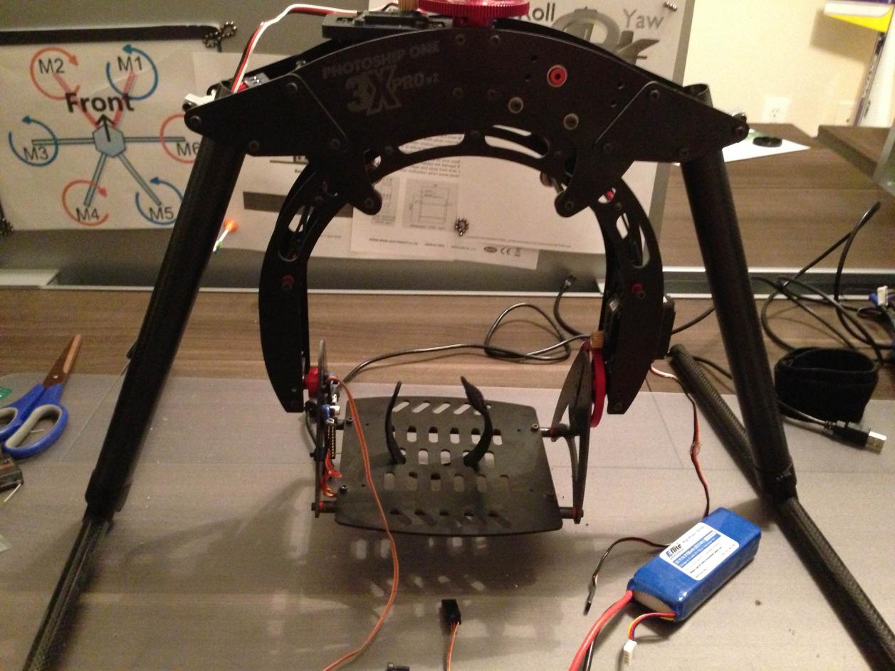

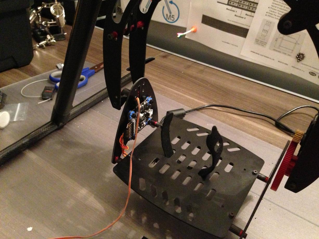

It is nice to see you guys are actively participating in helping customers with your products, but the setup process should not require a degree in EE or ME. So far, your gimbal controller has done nothing but spin the camera tray in 360* rotations non stop. Secondary to that, it moves to full right roll every time and locks the roll servo into place. Just when I thought I had it configured properly and connected the gear back up to the servo - it took off spinning again and ate my servo. I'd like to suggest a few things.

Ryan,
Is the tilt axis position sensed by a potentiometer? If so then the board should be mounted off-axis. For a two-axis gimbal with both servos using external potentiometers, the board should be mounted on a fixed reference surface like the bottom plate of the heli frame.
It should only be mounted on a camera mount element when there is one or more axis that can turn without any position sensing attached. In that case the GIMBAL rotates the servo on and off as it senses the position of the camera. Potentiometers do that for the GIMBAL in your case so it can ride along and just give commands from a fixed position.
edit.....looking at your last picture more closely the red thing on the left looks more like a mounting point and not a potentiometer so the GIMBAL would have to stay where it is.
