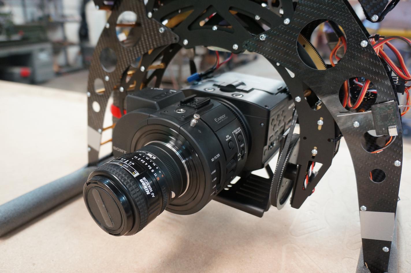

I'm just trying to make my CS8/CS360 gimbal combo fly this cam without hitting any limits. I actually already made the maiden flight with this cam and came to conclusion that I might need better efficiency in form of different motors. I'm currently using Tiger motor 2814 710kv with APC 14x4,7 in combination of 4s 10000mah lipo and standard mikrokopter esc's. The cam weights just about 1950g/4,3lbs with the sony 18-55mm oss lens. My total setup weights about 6,7kg/14,7lbs and I'm still missing video downlink and radian units. I agree that the mounting holes under the cam are in a bit strange location but I was able to get the cam almost in level sawing longer tubes for my cs360 gimbal. For triggering the record I'm using the Stratosnapper IR remote from littlesmarthings and it's working perfectly for both normal speed and super slo mo.
I was able to hover with about 60% gas and got about 5mins of flight time. I think that running another battery in parallel isn't really an option here and I would be better of using different kind of motors. The best thing would be if I wouldn't need to change my batteries to 5s or 6s, only the motors/props combo. I think the 5mins flight time is really not an issue but I'm scared that I'm running too much on the limits. Any ideas on optimizing this setup?

Here's a pic of the fs700 hanging under the cs8
