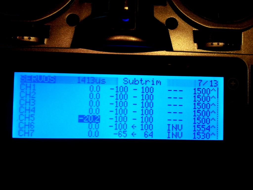

Hey folks. I need a little guidance on setting up the center point for the rotary pot (S1). There is a known issue with the center point being a little off to what the SuperX wants to see for remote flight tuning. XAircraft have told me it's usually fixed by bumping "it" up by 4.5 or so.
I'm a little confused as to whether this would be done by moving the sub trim 1500 (shown page 7/13 of Tx) up by the given amount, or if it's done with the offset???
my guess is that it would be done with the sub trim neutral offset, which is the first colin of adjustment in that page.
thanks for any clarity here.

I guess that it depends on what you are trying to accomplish. Subtrim moves the center point, but keeps the endpoints the same, whereas PPM Center shifts the whole range in either direction, to a point. In the examaple that I gave, Subtrim would probably be the better choice. I think. My hands were typing servo links, but my mind was thinking gimbal, where you might want the same throw above and below, but only want the gimbal level at the center point. But I can think of times when you wouldn't want to do that too, like when you set the vertical endpoint (like beneath props), and just wanted the camera to point straight ahead when at the center point. Nice for OpenTX to give us all of these options. Try all of them, observe the results, and use the one that best suits your application, would probably be a wise thing to do.

Which one is the sub trim that just adjusts the center point??? The first column or the last column???
I have the ability to assign a tuning knob that needs the center moved up a tad to where FC thinks the center is.
I will be testing it - but with the superx it's not all that easy. And being that it could be the difference between violent shakes causing a crash - i'd rather start in the ball park. :)

The first one does.
It just moves the center point, but keeps the endpoints, and you can view this in the channel monitor. The last one moves the center point and the whole range, which doesn't show in channel monitor.

Thanks. So it looks like I did this correct. I think it is called offset in the companion spftware.

Yes, I wish that the terms were consistent. I snapped a screenshot just to be sure. Does the SuperX have management software that will let you monitor the location of the input that you are controlling with the rotary?
