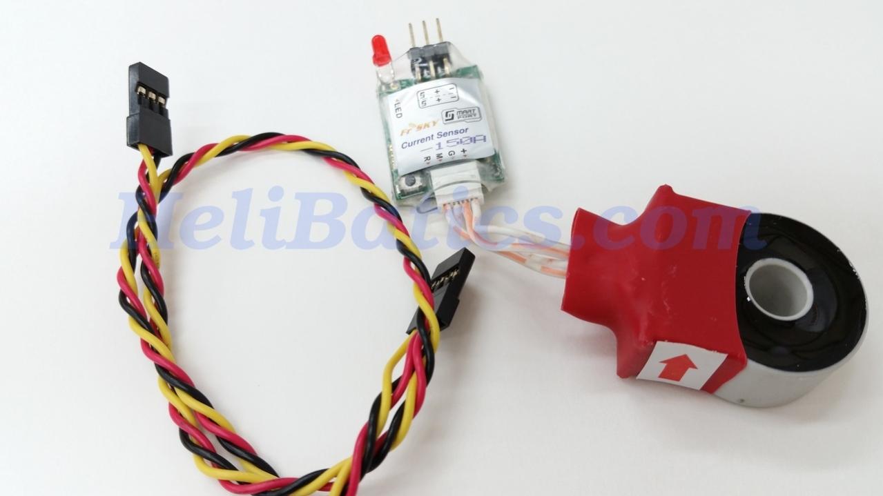

Just wanted to let you folks know that I picked up a new Smart Port capable, FAS-150A current sensor. I have been using the older (legacy) style current/Ampere sensor with success, but there has been some concern that adding yet one more connection, especially in the power supply chain might be a risky proposition. Also, the previous versions of the sensor (FAS-40A and FAS-100A) required modifying the included wires to get it hooked up to the vario to then connect into the X8R. The upgrade to handle 150 Amps is welcome...
This new FAS-150A, being Smart Port compatible makes this a breeze, with the typical newer servo connection. Obviously, like the other Smart Port sensors, this can be daisy chained in line with other sensors.
The real news here is that it is a Hall Sensor - which means that you simply pass your battery positive power lead through the sensor, and it reads as the juice flows through. No need to solder or add any connections in your system. For us multi rotor fans, we will need to have this installed between the battery and the PDB. So either a desolder or connector removal will be required to get the single lead through the sensor.
I'll let you know how it goes - it will be installed on the Hex I am currently rebuilding.
The folks over at Helibatics made a video showing the sensor in action...

Thanks, Scott. I suppose I would need two of them. I have use two batteries in parallel but they attach at two different points on the PDB so that if one connection fails, I still have one good connection with hopefully enough current left to land the craft. So I wonder if there is a way to connect two of those sensors. Even if there isn't, one is better than none if you find that it is fairly accurate.
Motopreserve
i guess if you have two different connection points you'd need 2. I'm just not sure the taranis would recognize 2 of the same sensors. I will eventually be running 2 batteries at times, but they will be flowing current through the same Y harness I made. Obviously that leaves room for error in the harness, but as long as that holds - I should be able to get the juice from the single battery if one goes down.
Im more secure with my self-made harness than I am with the integrated PDB on this tarot 680pro - so fingers crossed :)
