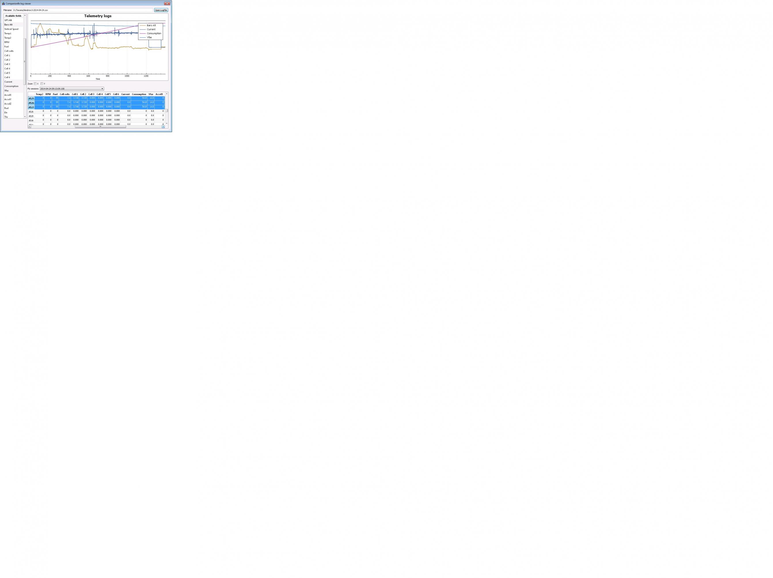

I'm hoping some people with experience using the sensors will chime in here. I've been tackling the telemetry, particularly the reading on A1. It seems the X8R is a bit of a step backwards with regards to not having analog inputs like the older RX. For the X8R, A1 seems to only read the RX voltage - which for many of our MR specific rigs is somewhat useless. Maybe I'm missing something (highly probable)?
With my superx powering the RX I am more in need of voltage/current readings. I have plugged in the SP-FLVS smart port voltage sensor. This thing is pretty killer - looks like a field cell voltage checker, can read up to 6 cells, and provides readings of individual cells and total voltage. It plugs into the balance port of your battery, and I have those readings coming up on the 1st telemetry page.
Next up: the 40A current/ampere sensor. I honestly can't tell if this thing provides redundant data or is something that must be used in addition to the voltage sensor. Literature is a little confusing.
Get the Unisens-E, little pricey, but very accurate:)
http://www.sm-modellbau.de/shop/product_info.php?products_id=138&cPath=18&XTCsid=c346a1653b59e9d7832f36b40b4db146
