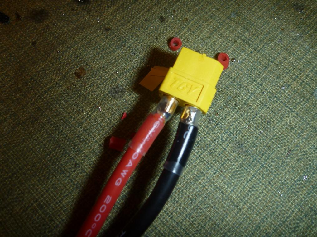

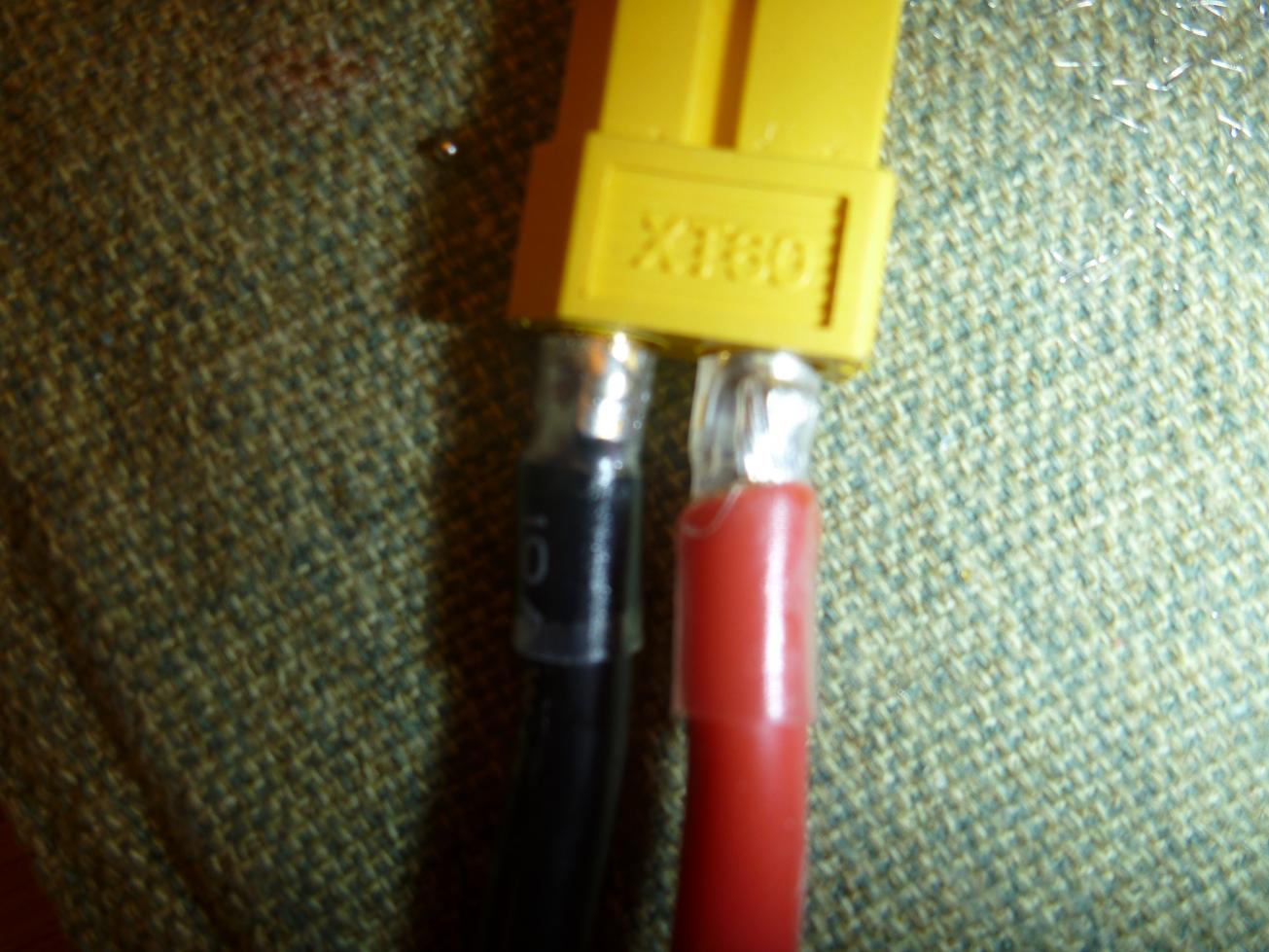

Is there a chance you could post a picture of your connectors so I could see what you're doing?
mailman35
here my xt60's they are just pics finished on 2 of the 3 bats 10 gauge wire. i also have 8 gauge wire connected the exact same way with no problems, flux and a decent amount of solder do wonders .
as well as a hot iron.
View attachment 2826View attachment 2827
