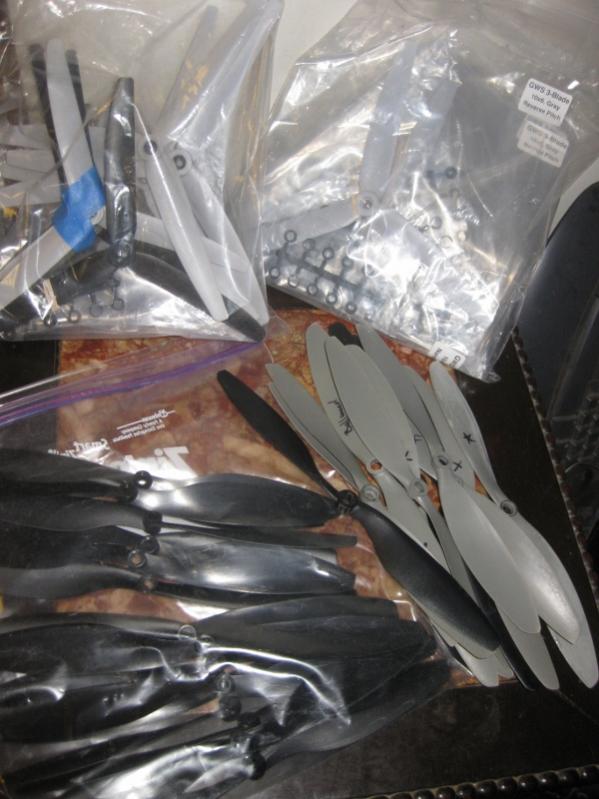

I thought I read on here where you had just got some APC props and I was curious how they fit since they didn't have the flat spot.
The fronts had to be drilled out to fit over the 8mm hub but the back sides went on fine. The trick was to not drill into the back from the front and to leave what they call the (precision hole) in tact.
The flat spot isn't needed, just make sure to tighten em down and dont over tighten them. They are side to side off so the ones i used needed alot of tlc to balance

they flew nice, not alot of bite to them and they were really hard to balance. on 3s with any weight was about a wash with the 10x6, think i was 3lbs, 11oz, barely went up in atti, couldn't stop it on the way down. 4s they acted pretty decent except ran at a higher rpm overall and moved the harmonics up the scale a bit.
best thing i did was quit screwing with all that and get a set of graupners
