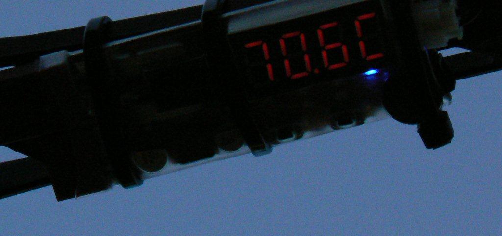

JDM66
Hi
first "Rendez Vous" of 2 S800 in France
you can easily see the vibrations of the engine mount
[video]http://www.youtube.com/embed/p9z2kDtBvac[/video]
the Ecs reached 70 ° C. After 10 min
after this meeting and all problems of this bird, my colleague decided to sell its S800
I risk do the same ...
jdm66
srbell

JDM66

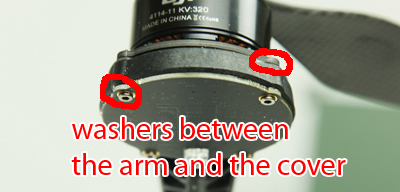

fsimao222
Hi,
I am very interested in buying one of these S800 and here I was thinking about this problem of heating of the ESC's and vibrations of the engines. Everything must be connected.
With the heating of ESC's the supporting arm of the motor is more moleavel and causes vibration to occur are possible.
A solution that I liked that you guys try out to see if improved cooling would put metal washers in all ESC's cover, making a current of air and dissipating the heat that builds up there.
Like This:
If someone is willing to try to tell because I'm from Portugal and the climate here is very hot today is 35 º C.

jdm66
