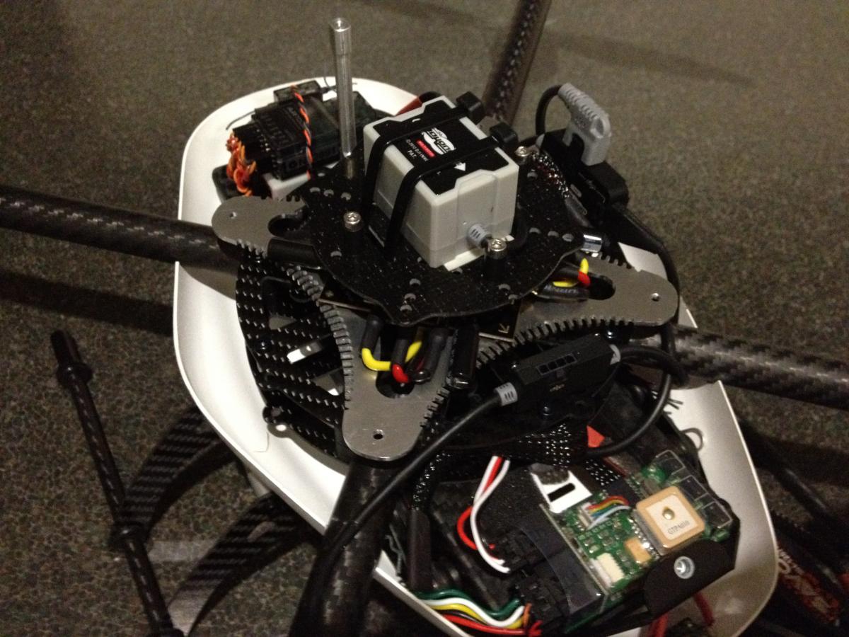

By the way I mounted the gps modul directly onto the centerplate without the pole and no problems getting a lock down at all.

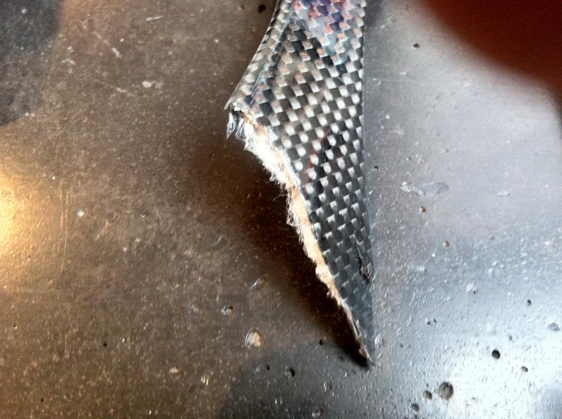

uh uh i feel like a fool. After bricking one of the WKM setups. I managed to have a really bad maiden. After the 6th copter i built now I was so good this time to mix up the ESC plugs :) Flip of death of coarse, took it to easy to arrogant.
Only positive side of the game, are pics of how the props inner life ;) and i will see and give the info how long it takes to get spare props :)View attachment 4136

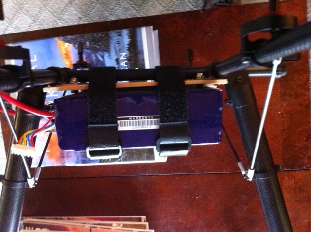

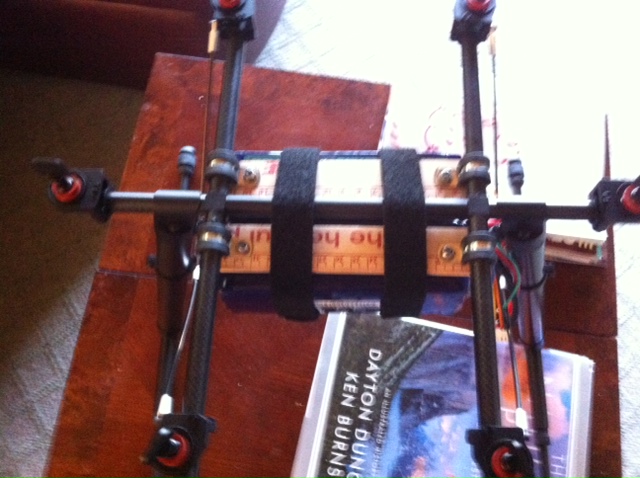

I just got back from my maiden flight of my S800. I brought my friend, James Cole, a professional photographer, and his partner Tom along to observe and video the event. All I can say is WOW!!!!. I was flying in 8 to 16+mph winds at 6500ft elevation on the North Shore of Lake Tahoe. The performance was stellar. I still have some tuning to do but with Sidney's basic settings it was good. My flying weight with 2x6S 5000mAh lipos was 4.65k. I got 20+minutes out of the lipos doing mostly hovering in ATTI and GPS/ATTI. I did get a little stick banging in but this is not the craft for that other than for test purposes. I did see a few of the dreaded white LED flashes. It was mostly when there were gusts of wind that upset the balance of the S800. James shot about 10min of iPhone video, now I need to go through it and distill it down to about 3 minutes of the highlights. Here is my lipo mounting solution. It is a little ghetto but it works. 4 rubberized 1/2" pipe hangers and sections cut from an ACE Hardware yardstick. I will be replacing them with some CF when I get home. I did velcro and then used two Scorpion battery straps that I had setting around. It was very solid and well balanced. Video to follow.
