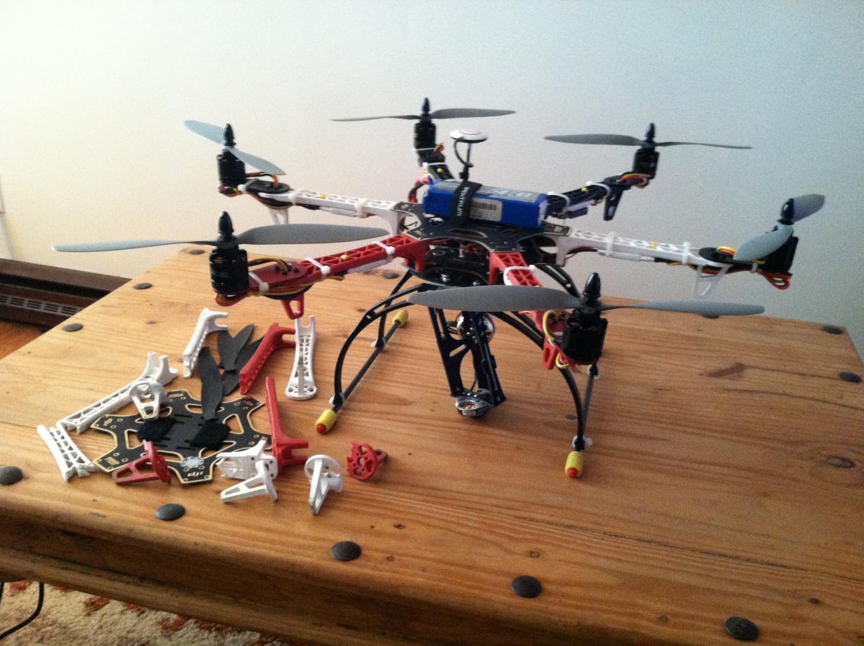

What a ride that was, and it wasn't a good one. After installing 3.10 and having 2 separate crashes due to motor cut off mid flight. I now have my hex back together. About $200 in parts and 7 hours of time it flies like it used to. I did downgrade to 2.02 before flying again and all appears to be back to how it was before. I think it will stay that way until there is some substantial time after the next firmware.
The re install was super easy, since I still had the previous software still on my computer. once I opened 1.8 software it asked if I wanted to upgrade the 2.02 firmware, click yes and it was done within a minute.
