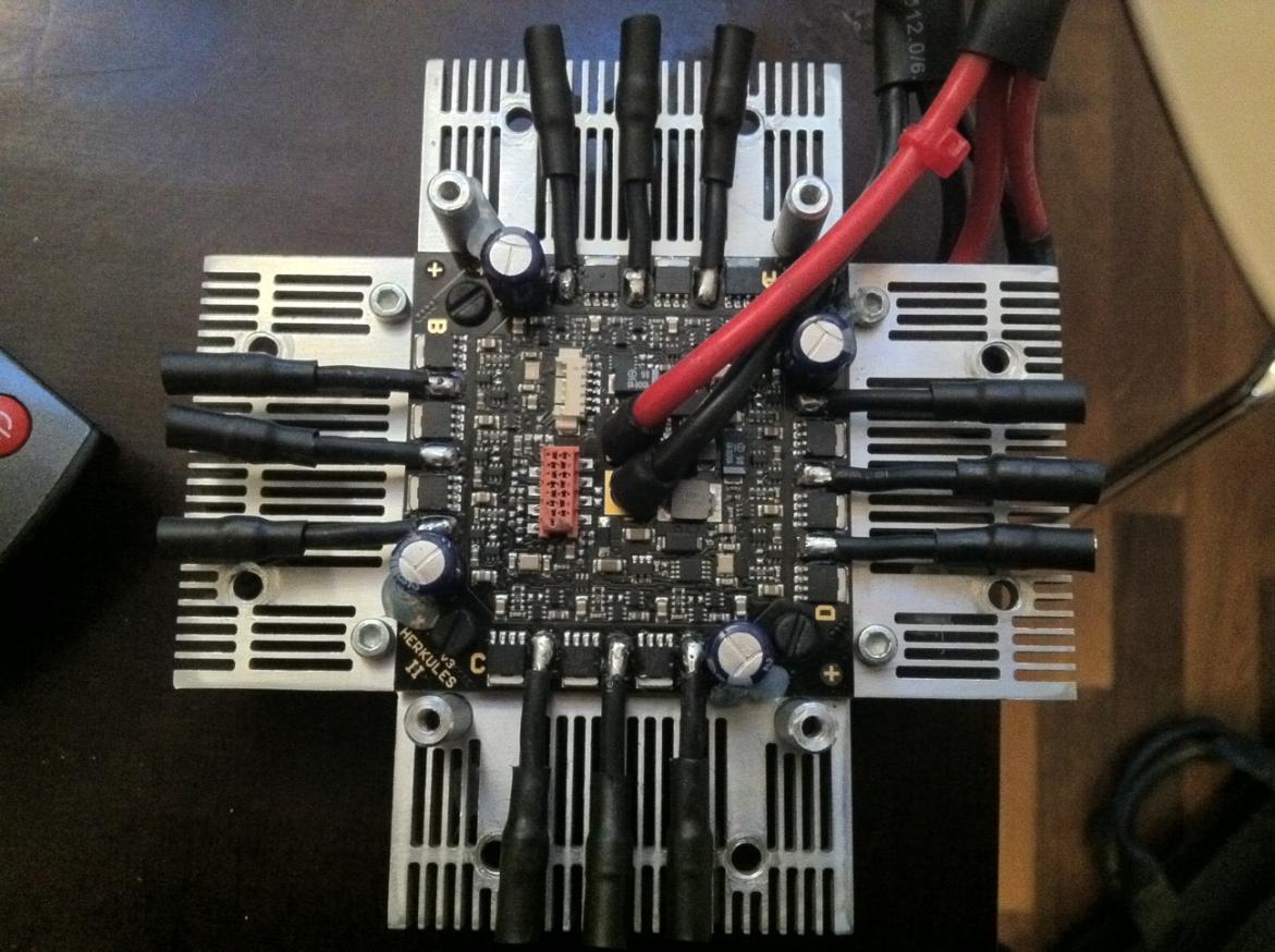

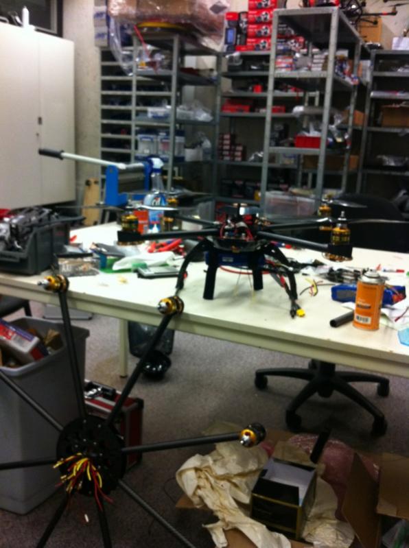

okay i got rid of the gold connectors directly on the Herkules i think that makes more sense and is safer. I want to keep the connectors though so i can take the bird apart for travel.

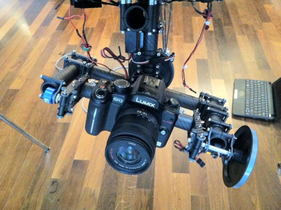

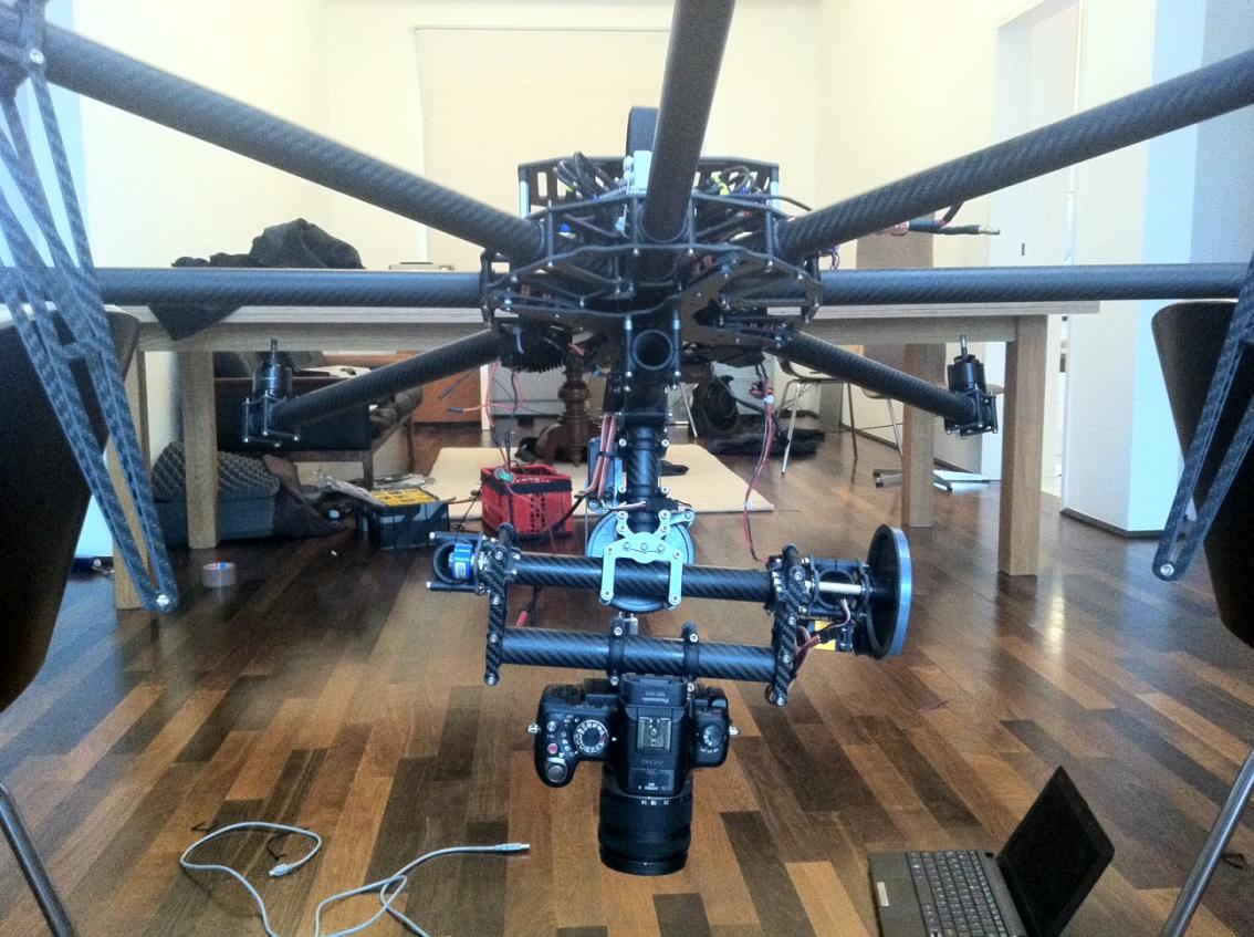

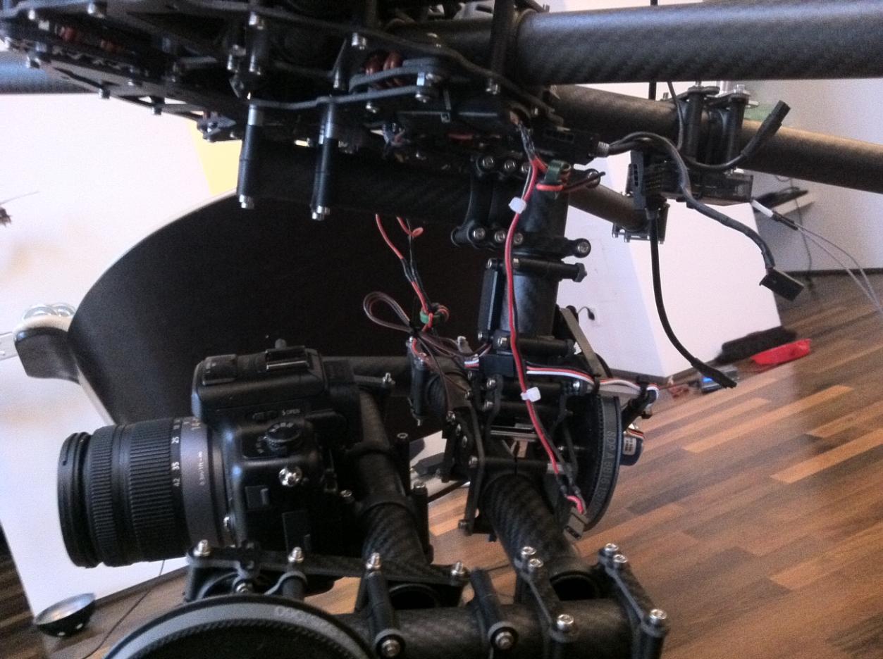

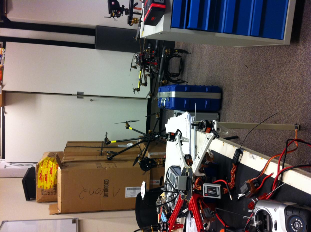

okay AV 130 bye bye. Just mounting the CS gimbal plainly from the feel and the cam on it. This thing feels solid ! Since its raining again like nearly every day since 3 weeks i guess i will finish it up today. Just have to figure were the picloc should got for best results.
Not sure if i really mounted the Gimbal correctly to the CS camera plate. If anyone has seen a foto or instuction somewhere i would be happy for a link !
View attachment 1817View attachment 1818View attachment 1819
