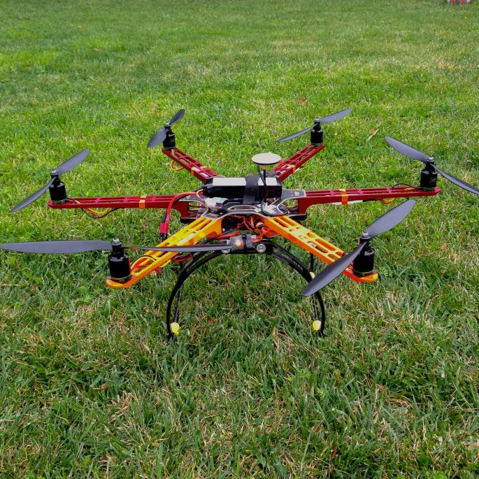

Just got back from testing my F650 with extended arms, cobra motors and two 3s 4000mah lipos in parallel.... Mixed flight time was over 12 minutes in 3 to 8mph wind. I still had 11.1 volts left in the packs when I landed.
I wanted to give you another bite of food for thought, and I'm in no way making recommendations nor trying to steer you in any one direction. Here's the approximate cost breakdown of my rig. Note this doesn't include a gimbal for my Sony Nex5, which I purchased on the boards here.
DJI F550 top and bottom plates 2 @ $25
ReadyMade RC extended aluminum arms $161.00
DJI or other 30A esc x 6 @ $20 ea $120
Naza FC $170
Cobra 2221/16 940kv motors x6 @ $32 ea
Landing skids $50 & up (I have these cheapo plastic ones that are quite durable and shock absorbing)
Rx and tx - I think you narrowed that down already, huh?
Hope this is helpful.

That is some good flight time Jay. Great feeling isn't it? I haven't seen those extensions from RMRC. Where are the pics???? :)
Jaybeast
I have to say it felt good to be able to confidently fly around without worrying that as soon as I lined up a photo, I would have to reel it in to swap the batteries. Normally, I don't fly aggressively at all so I feel my overall time on 2 lipos will be around 14 minutes. Now I just need to get a few more sets. And you're right, I should have posted a pic...
View attachment 17438 View attachment 17439
