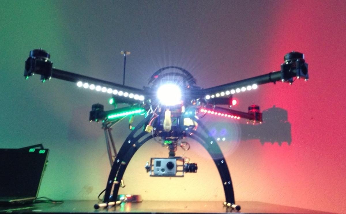

tikigod19
Damn.. I always rely on the rth. I'd hate to think it might let me down. Did you have your name on it?
I'm using an f550 with naza gps and tiger 2216 motors as recommended by that yank legend kloner and a few more on here. Would never have made the jump into what has fast become my favourite hobby if it wasn't for this thread!
I've added a yun-1 gimbal (not all that good..), aeroxcraft landing gear and fatshark 600mw fpv kit with screen on my dx8. Packed everything with foam and added a clip on nd filter to the gopro 3 black which seems to soften things slightly (might be slow shutter speed) but certainly helped with jello.
It's been months to get it to this point and I'm now scared to touch it for fear of going backwards but I'm considering changing the expensive aeroxcraft landing gear for a cheap ebay one a few people recommend solely to give me more gimbal clearance as the yub is about an inch taller than most recommended gimbals. Just worried that doing this will introduce vibration again..
