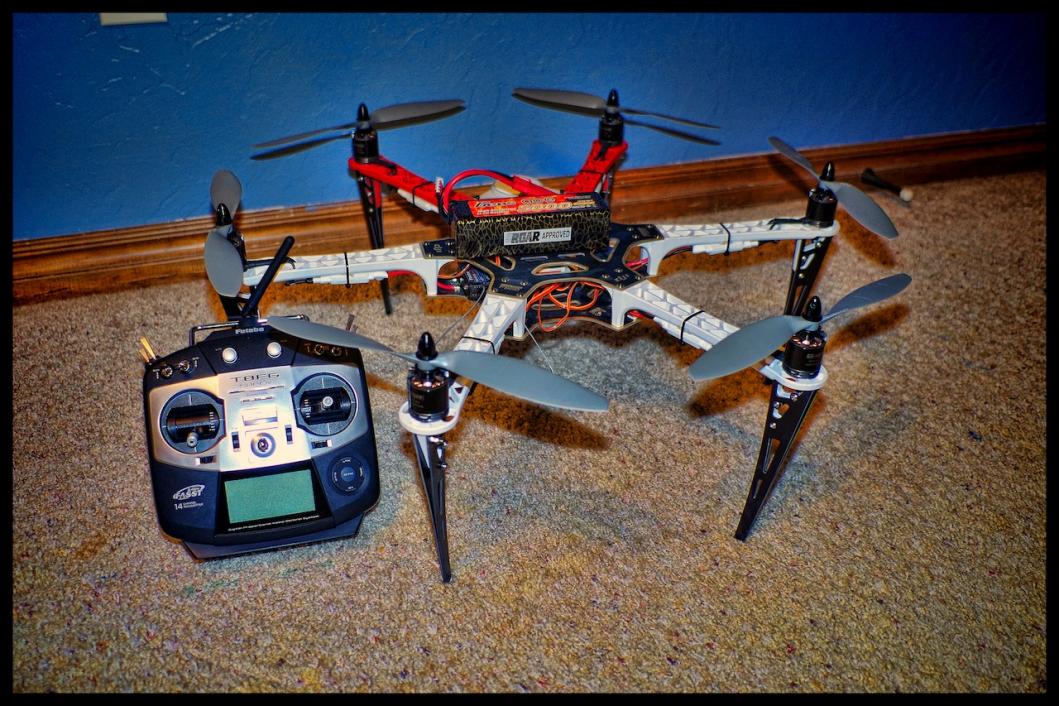

Mine arrived today. Got it put somewhat together. Not ready for flight yet though! Plus I am waiting on the batwing to arrive for my go pro. My motors are MT2216-11 KV 900. Props are APC 10 x 3.8.
I am concerned about the weight of the Hard Pack Gen Ace 5000 mah 3S 40C I bought.
