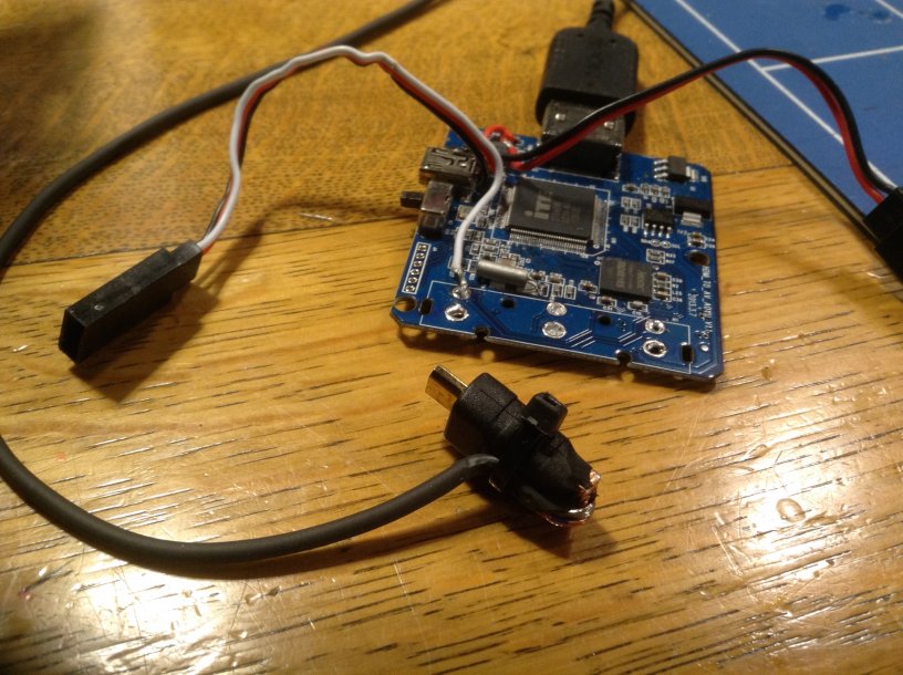

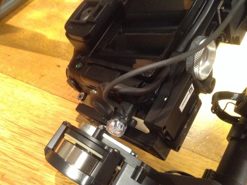

Good idea scotth, I have an old HDMI board lying around so have connected that up. It appears to work well in the cold, but will have to test fly to be absolutely sure
