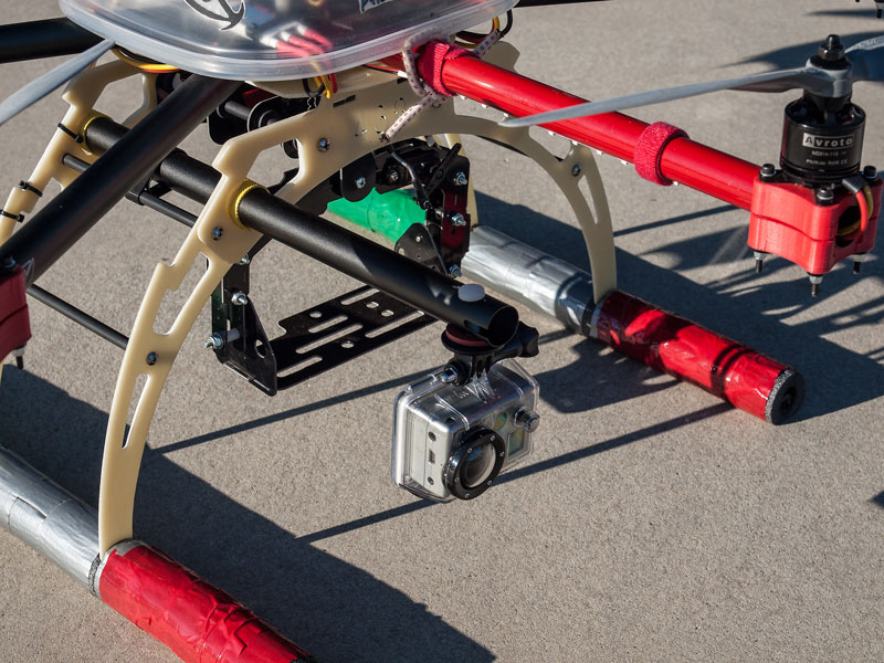

I'm late coming to this thread but figured better late than never. Having flown both a Droidworx ADH6 and the Y6, the Y is my favorite. My business is forensic animation and we rely heavily on high-res aerial footage (static and video). I use a GH2 on an AV130 gimbal and the ability to shoot between the wide booms is very important. With the ADH6 there was often a boom intruding into the frame. Moreover, the smaller size and Y configuration make it easy to transport. I use two Quadropower 6200mAh 4S batteries with the WKM system and I get about 12 minutes flight times using 80% of the battery capacity. Can't say enough about the WKM performance on this Y. It just hangs wherever you park it in GPS mode and with Graupner 11 x 5 e-props it scoots around like a terrier but is remarkably stable even in moderate wind. I use the DJI View Groundstation on a Pansonic Toughbook in the field and find it very useful for precise positioning and for monitoring altitude when doing high elevation shoots. My clients are lawyers and civil engineers and I often mount the groundstation on a tripod where they can observe it along with a video downlink from the Y when they attend a shoot. Never fails to impress and please the clients and, let's face it -- impressing and pleasing the people who pay the bills is really important in this business. I like where DJI is going and I have to assume we're entering a very exciting phase as technology advances.

I do have an S800 with Zenmuse coming in May but I am confident the Y will continue to be a workhorse that flies regularly.

Frame: DW Y-6 V3 Heavy Lifter
Motors: Avroto 770KV
ECS's: HobbyWing 30amp
LED's: Xogear WaterProof
I do have the nacelles on the booms.
I need to get a scale and weigh it to determine the takeoff weight. I'm carrying a mondo stinger tx for the video downlink from a 700 line mini-camera. I messed with an HDMI converter board to pull video from the GH2 directly but the quality sucked. I'm going to experiment with a patch antenna to improve the video downlink.
