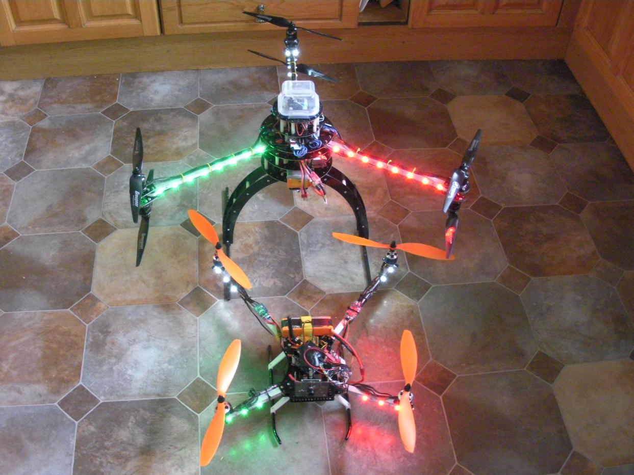

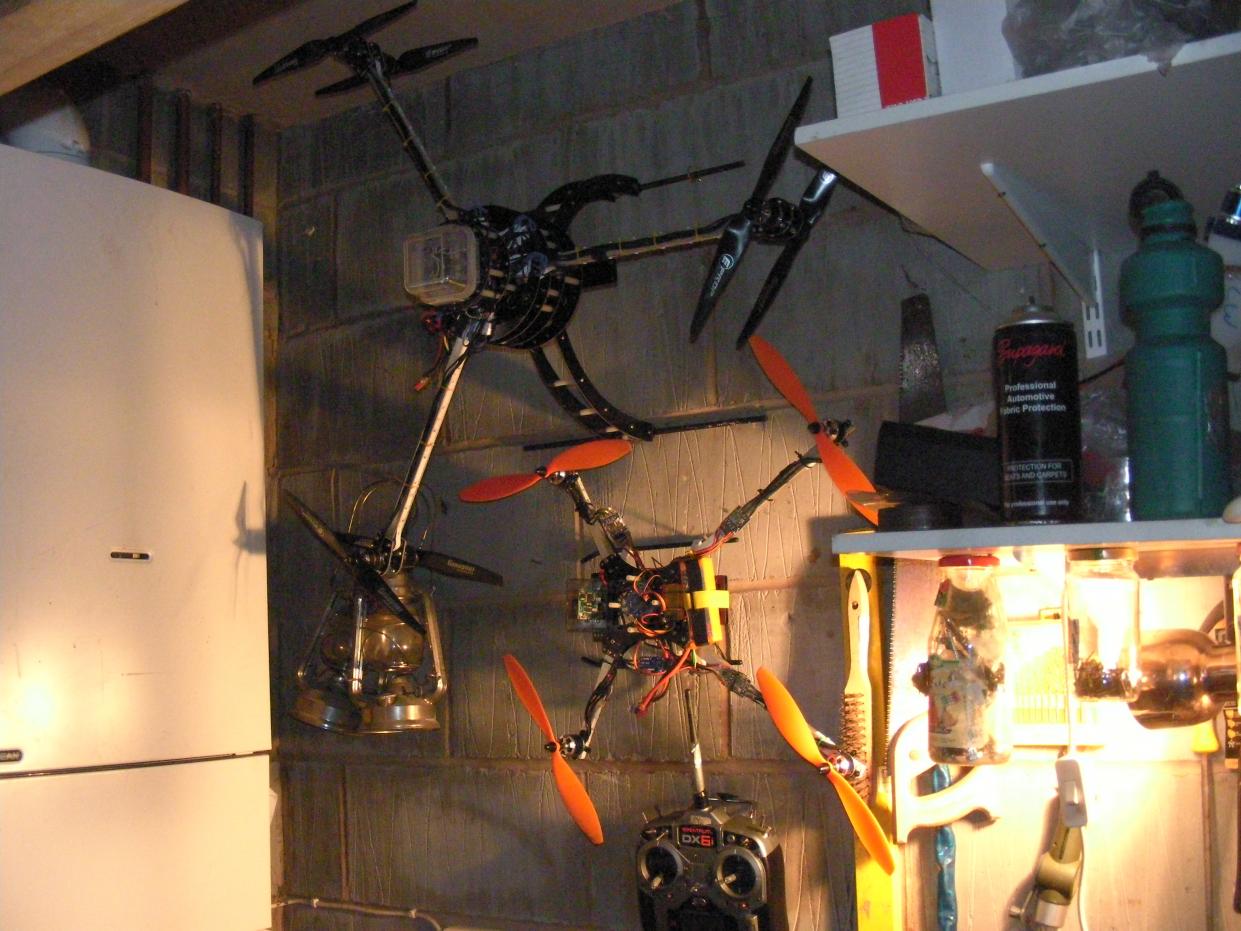

Here is my Y6.
View attachment 3991 View attachment 3992
Frame is a Rusty UAP-1,18 AMP esc,4s 4000mah Tipple batterys,Graupner E-Prop 11x5,Copter control,TorxPower MC2216 Pro,DX6i
Weighs 1.63kg, 2.12kg with 1x 4s battery(maybe a bit more since I last weighed)
PS the bear is not normally attached ,he came to stay with us as the "take home bear" for a few days,the girls decided to send him on a mission:)
Getting about 11 mins(ex bear).

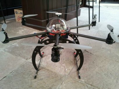

Here is my personal Y6 fpv machine :) Droidworx Y6 Frame , Wookong M , Torxower Motors, T-Motor 30a Escs, OSD , Iftron 5.8ghz fpv tx , Graupner 11x5 top and bottom , Now flying on Maxamps 11000mah 4s and get around 20 mins with gopro and fpv pixim camera etc . This is my favourite fpv platform .
