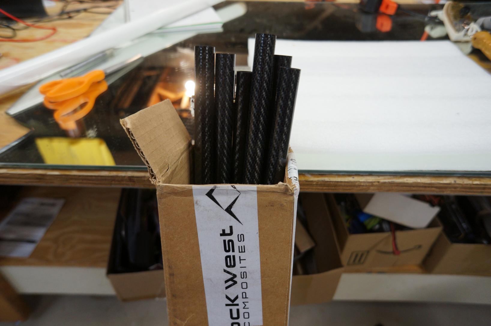

So far, the carbon fiber boom tubes are here. The boom/motor clamps are being made, the frame plates are being made, the motor mounts are being made, and the parts for the camera mounts have been ordered. The motors and ESC's are in transit and I'm trying to find any shortages in the shop and get things stocked up so it can all go forward when the flag drops.

Here's the first pic. Wish me luck!

it's amazing how much time goes into making triple sure everything is going to fit. nothing can be returned! the shops I use must think I'm crazy because I send drawings then call and say, give me a day or two to double check everything. prototyping/custom is expensive so I can't afford to order $600 worth of unusable parts. it's stressful, that's for sure. especially when you're financing you're own development.
