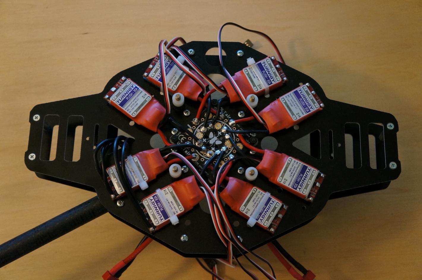

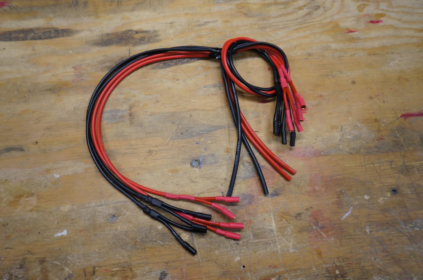

Frame plates and motor/boom mounts are expected early next week so I've started making the parts that I can while I'm waiting. Here's a pic of the power harness. With past builds where I've used 4S packs I've had the power distribution and ESC's centrally located. With the 6S packs I'm planning to use for this heli it's been decided to move everything out to the motors. Hovering power will draw 3.5 to 7 amps per motor depending on weight and this first heli is using the Tiger 4008-18 motors rated at 18 A max. The harness has provisions to attach two batteries and if I decide to use four batteries I'll just Y them into the two attach points.
The first pic shows the new power distribution harness. The second and third pics show the modified Voltair board I've used for past builds and the install of the ESC's. With future 4S builds I'll likely a combination of the two schemes with a straight harness, centrally located ESC's, and a shrink-wrapped bullet connector between the ESC's and power harness. If everything goes well with this build then all future 6S builds will have the decentralized power and ESC scheme.
Checking the bullet connectors will be on the semi-annual maintenance list though to make sure they don't build up corrosion over time thus weakening the connection (and increasing electrical resistance in the joint).

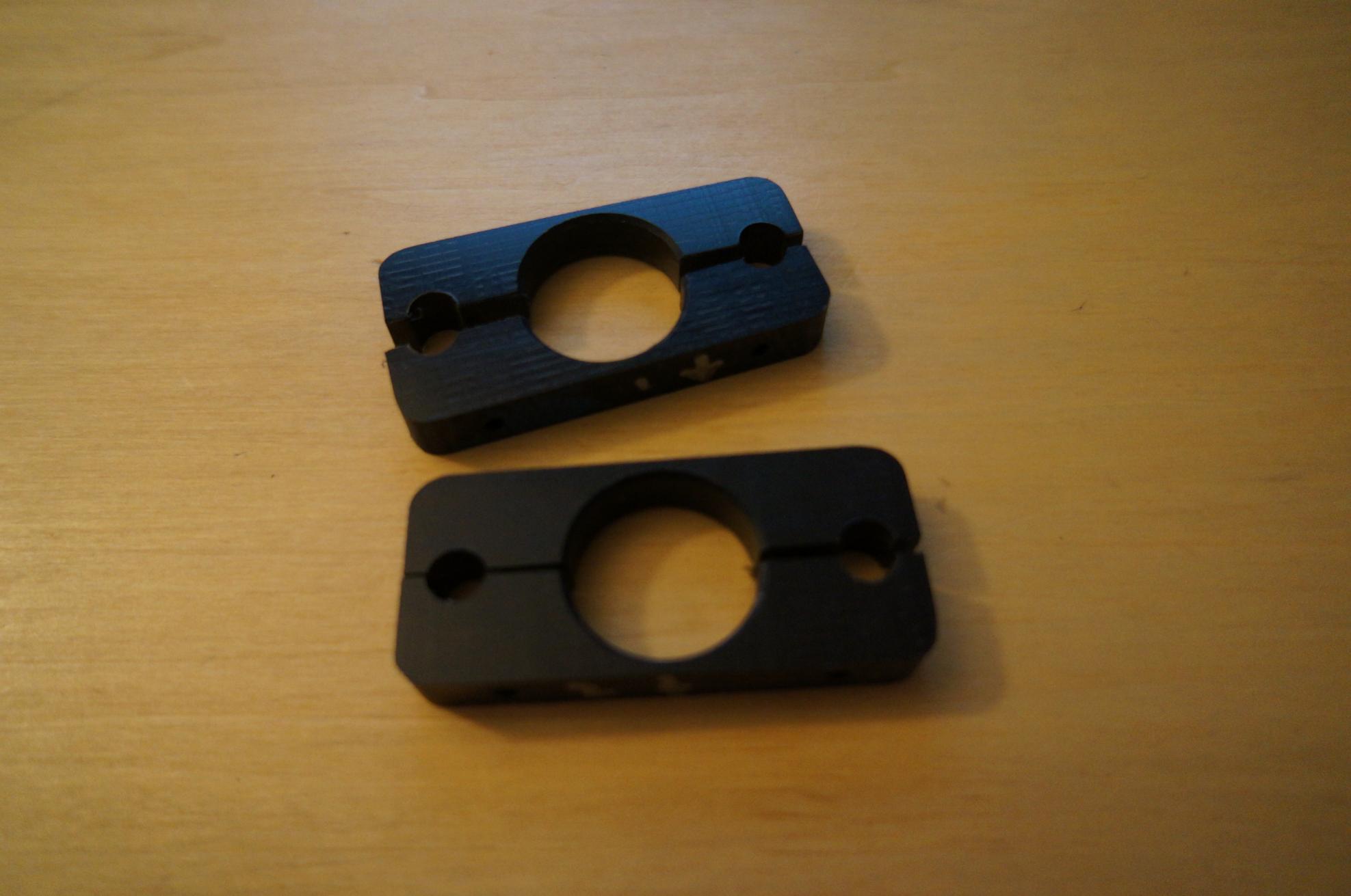

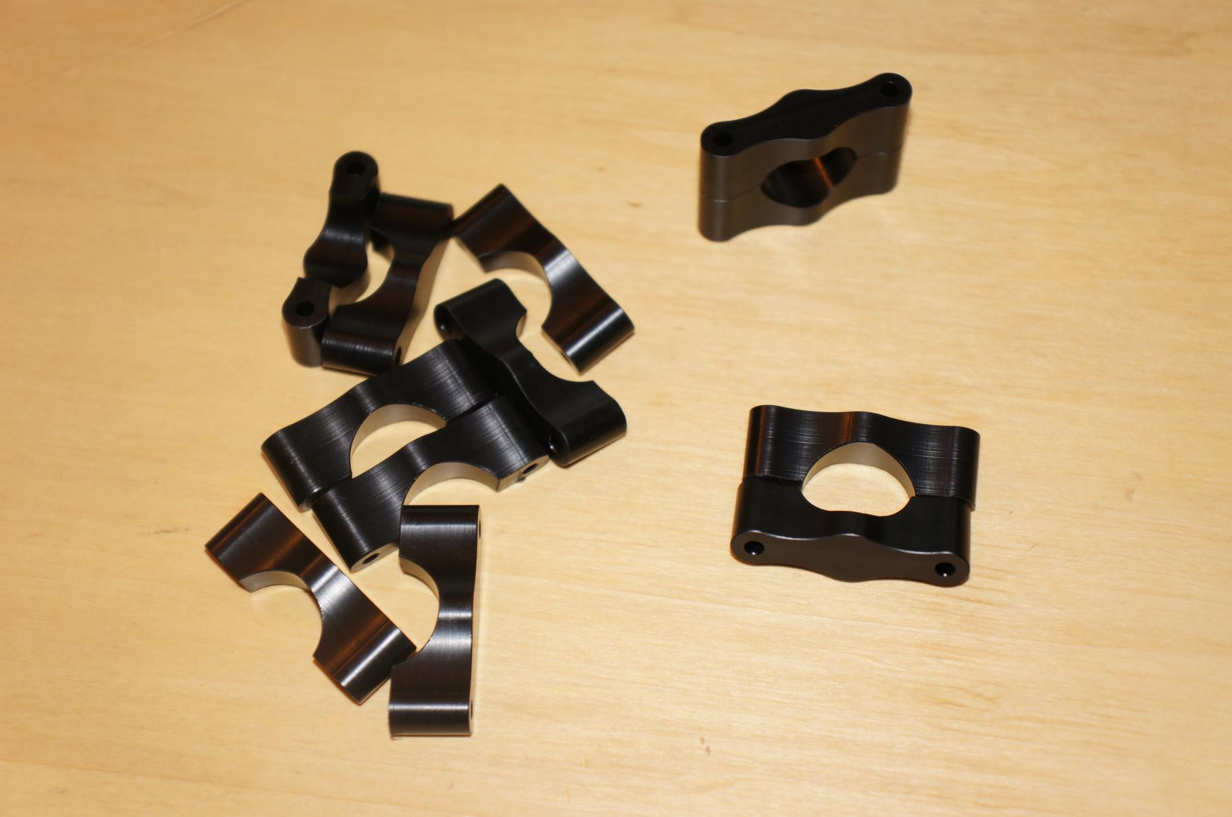

a box just arrived with the motor/boom mounts. they're machined from Delrin and I'm very happy with how they've come out. Also, this morning, I machined some brackets to hold tubing for a landing gear idea I've been meaning to try. I don't love the way the idea was working out so they're basically trash. I'm in the process now of working with a carbon fiber shop to have custom gear molded for my heli and will likely use Droidworx gear in the interim.

thanks guys, i'm very happy with how they've turned out and they look great on the glossy carbon fiber arms. the production pieces will be injection molded to keep the cost of the kit reasonable.

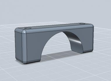

i did my mounts on a 3D printer, they clamp a 12mm tube, and the holes are 19mm apart (motor size) , one piece keeps em together, and the plastic flexes enough to make a really firm grip on the carbon tube - maybe usefull ?

matt,
be careful clamping from one side like that. the base of the motors is not very rigid and will flex if that clamp deflects much. i learned this the hard way early on by over tightening motor mounts that came with a frame kit i had bought.
flex is one way to get clamping pressure on the tube, with my clamps i've got about 4mm of gap between the parts and about 2 to 3 thousandths of interference between the clamp and tube so they sort of snap on and then clamp down to stay tight.
the trick is to not overtighten them. they should be tight enough to stay put during flight but not too tight to also rotate on the tube in a crash. between the wood props and these motor mounts, most encounters with earth should leave the booms protected and the motors salvageable. at the worst, i've usually only had to clean a little dirt out of things, replace bearings, get the motor mount re-aligned and i'm back flying.

matt,
bart
Thanks Bart, i hadnt really thought that part thru, havent had an issue yet, but i can see how it happens - think i will go to two piece mounts :)

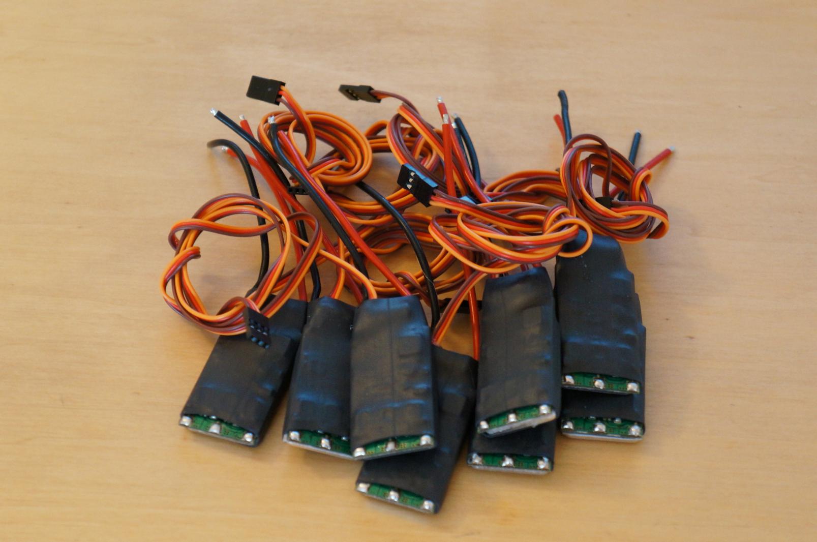

Last night had me up late (after the new episode of Gold RUsh) preparing the ESC's. First the wrapper gets cut off then the servo wires are desoldered. I give each one a quick inspection and then attach a longer servo wire followed by some hot glue to secure the capacitor to the board. Before the new heat shrink goes on the board get a light cleaning with alcohol then it's buttoned back up and ready to go. The motor wires will be soldered directly to the ESC and the power wires will be cut to length before getting their bullet connectors soldered on.
