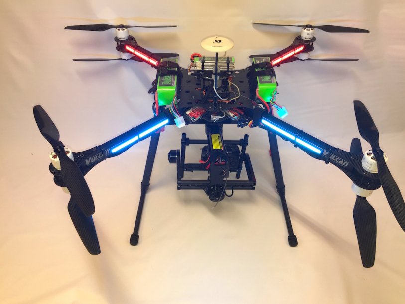

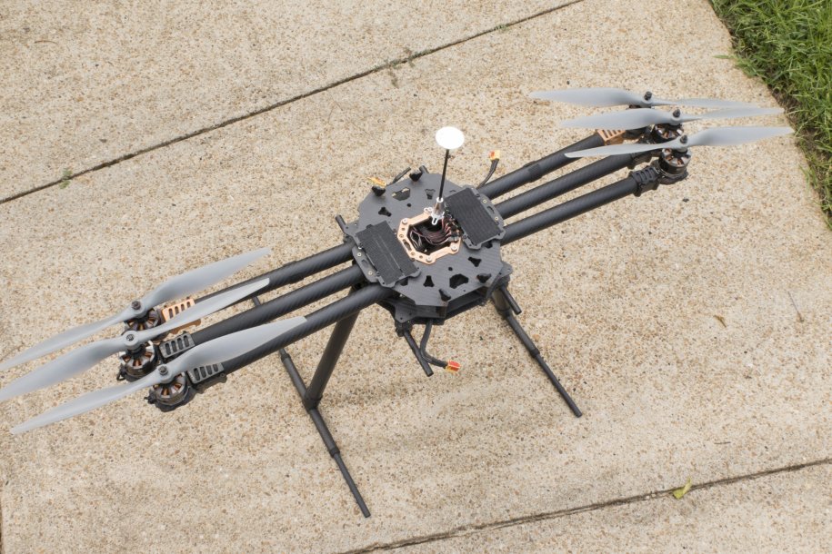

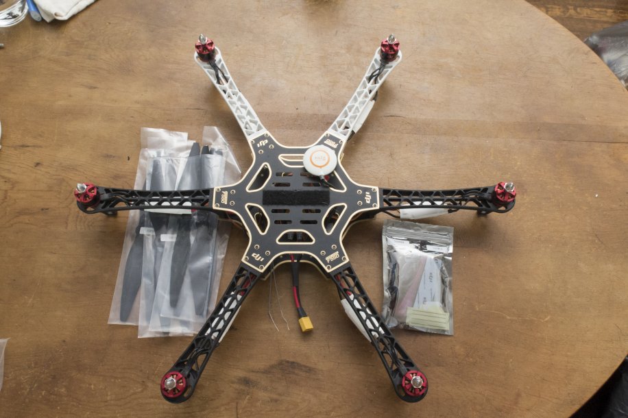

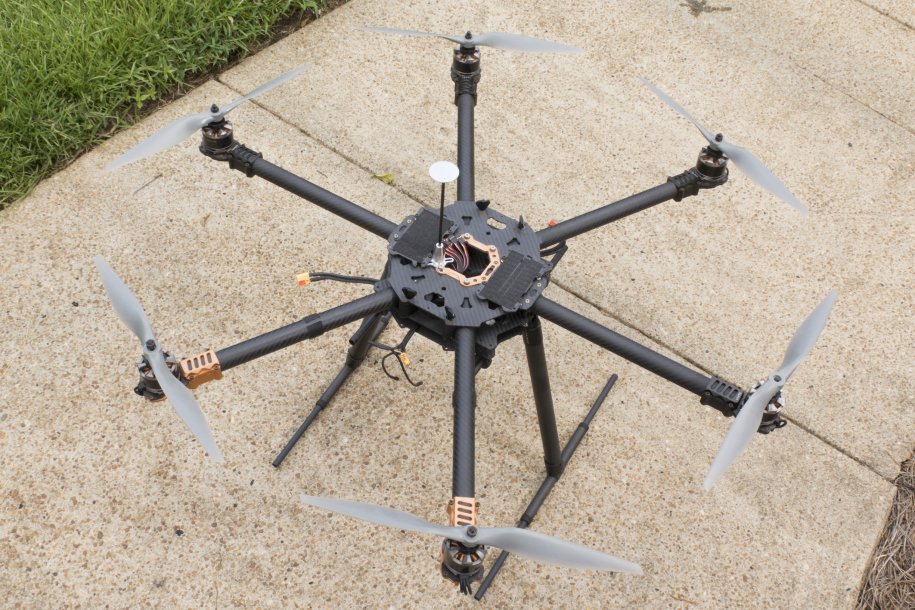

Ok guys, with the weather in the crapper and the wife and kids gone it's been 16 hrs a day building on the dining room table!! And I'm getting some stuff finished!
knocked out the Hexacrafter X8, just need the Movi M5 gimbal mounting plate and vibe dampner which should be in tomorrow. I think the rig is AWESOME. SO solid and pretty. This has been my best build ever...
View attachment 25232 View attachment 25233
And then, I rebuilt my H6 hauler a Vulcan frame but this time with Falcon Drone Systems frame plates. These are AWESOME, and give an old Vulcan frame a whole new life! I just need to find bullet connectors. I ran out and trying to find 24 female 3mm or 4mm bullets is proving to be hard locally. But again, this should give the Greasy H6 a 18 min platform on (2) 10K batts... STOKED!
View attachment 25234 View attachment 25235

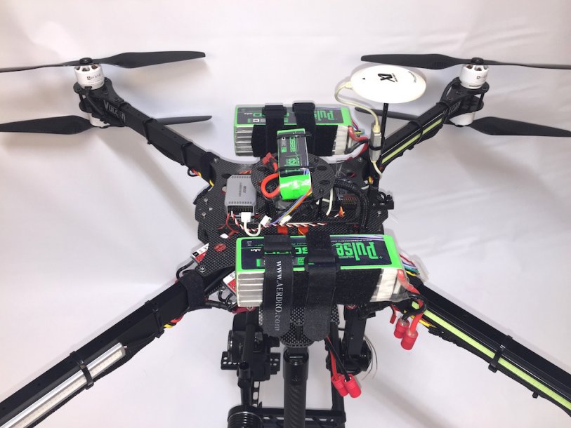

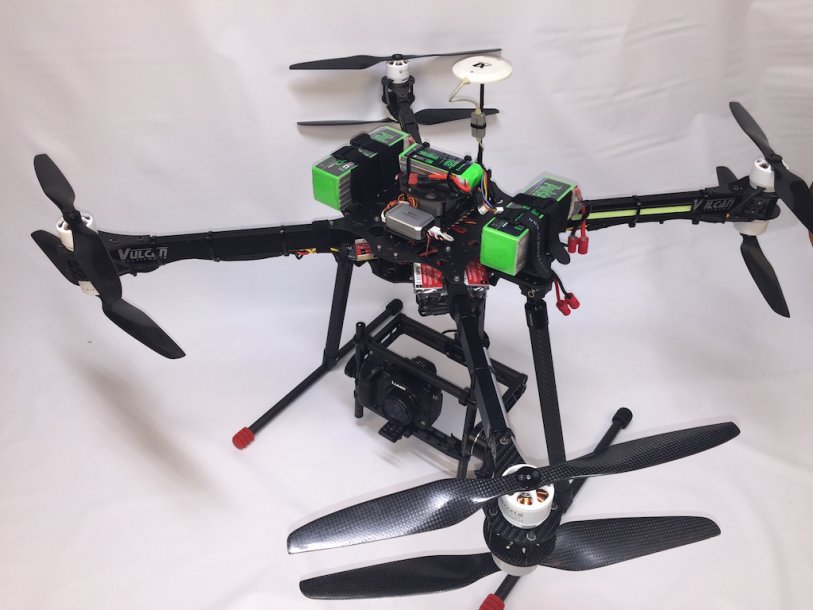

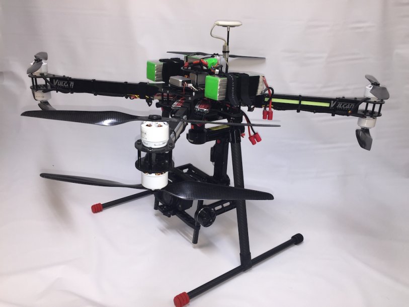

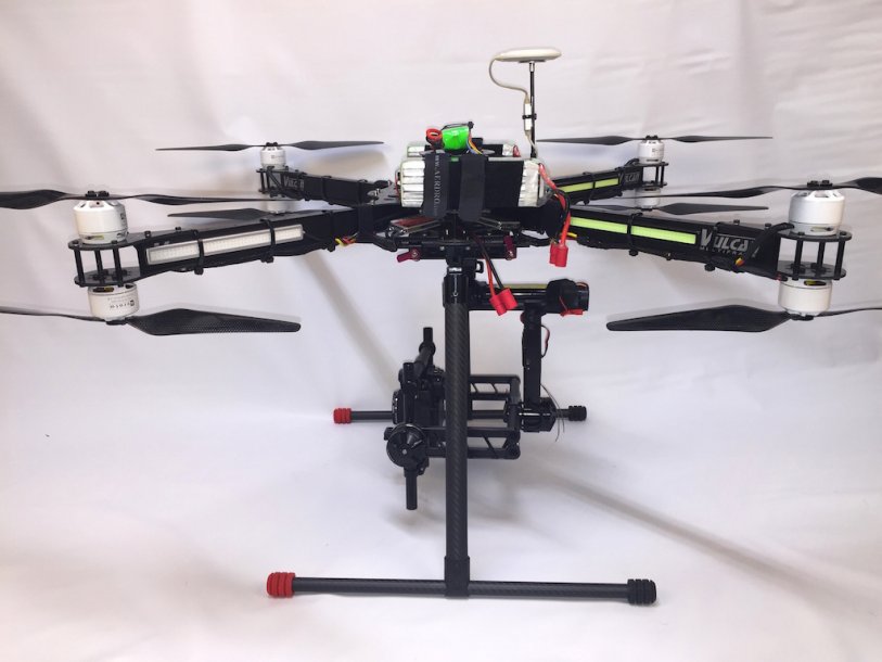

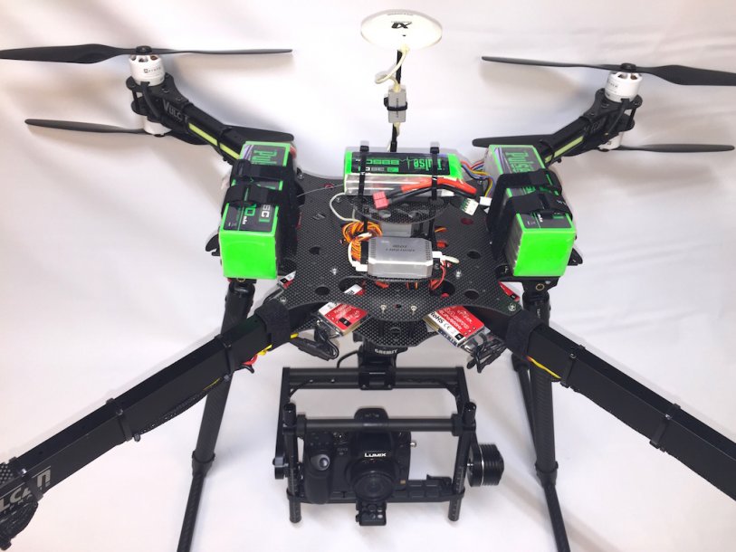

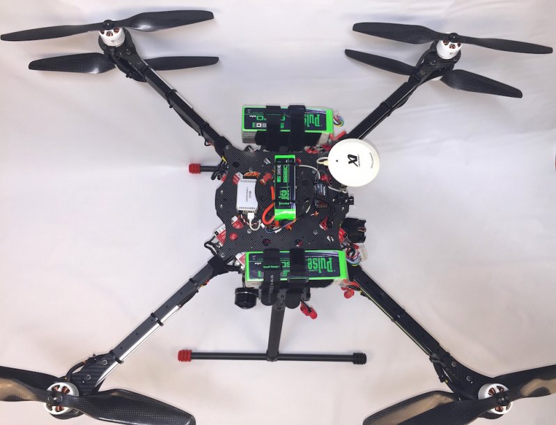

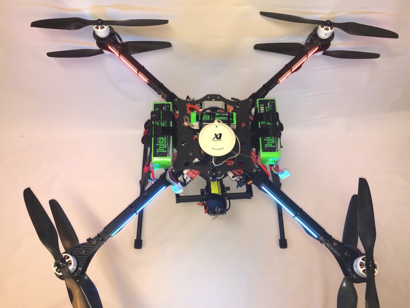

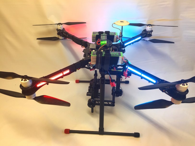

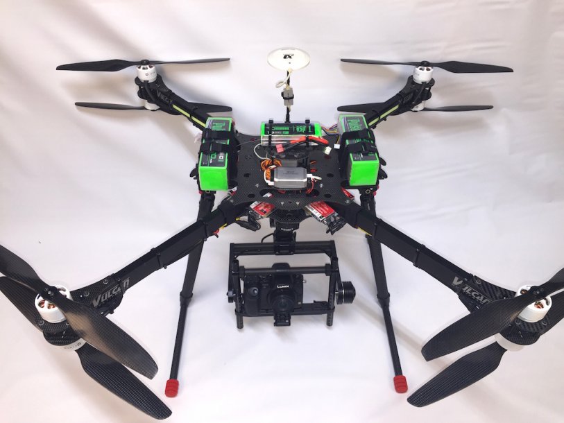

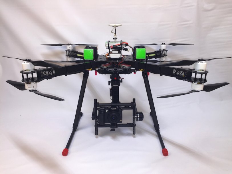

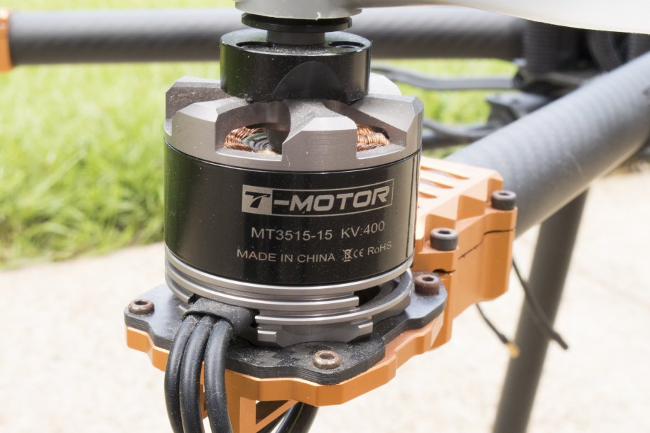

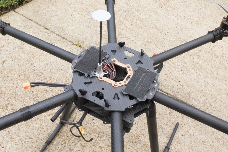

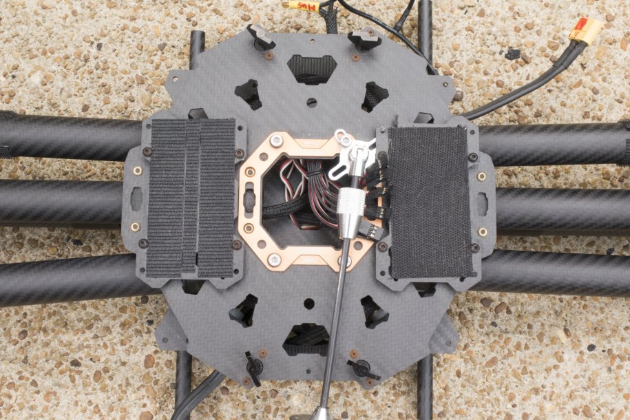

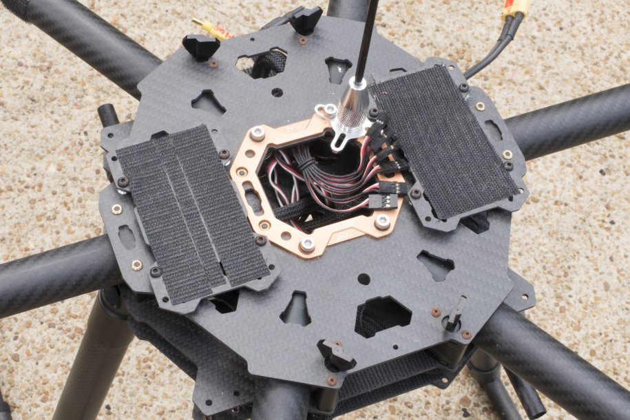

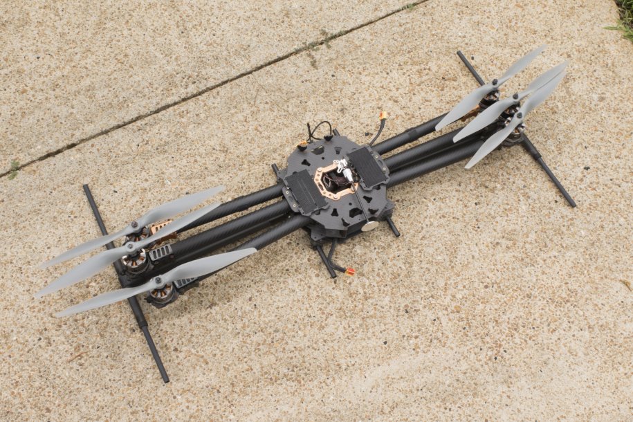

OK guys, the H6 review shall continue soon. Finished rebuilding the X8.... now with Falcon Drone System plates! I added a much larger PDB, and the wiring is laid out perfectly. The entire system should be able to pull AMPS with no un-needed resistance and keep cool.
Now if the weather will cooperate and I can get some flight tests done, I can get back to tuning and working with the H6.
Should fly a few "sand bag" flights tomorrow and then get back to testing.

Nice work @SleepyC

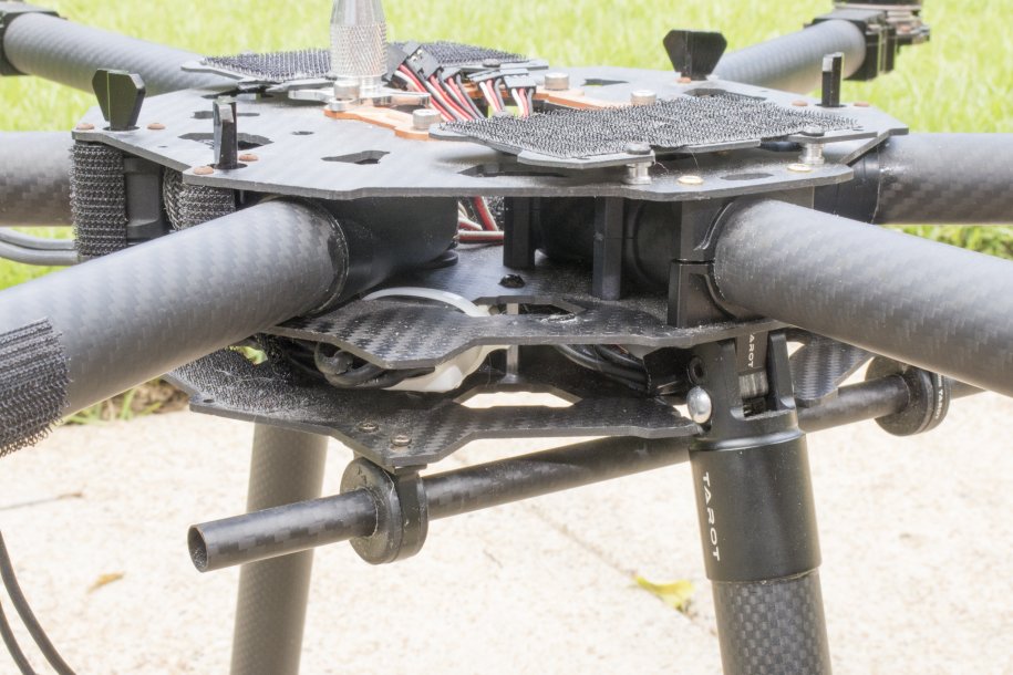

Did you have to extend the Tarot retracts to get enough clearance?
No I did not have to extend them, but it only has around 3/4 - 1" of clearance. I might make a TO/Landing pad that is 3" raised up for both skids to give it a little extra area... just for gimbal boot up, once "on" it's plenty of clearance.
Pumpkinguy
or just get slightly longer 25mm tubes. They are so cheap and will widen the stance at the same time.
