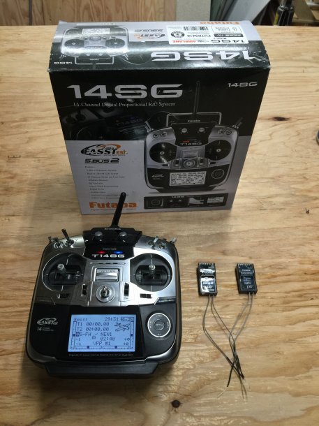

Air media: Just been speaking to HUY PAM. IT DOESN T SUPPORT PPM so I m in trouble here!
Big shoot on friday and here I am hunting for a compatible radio :eek:
Quick question Futaba T8J or Spectrum Dx6??
SleepyC
www.AirHeadMedia.com

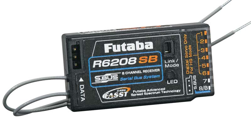

I plugged in the Futaba T8Js through sBus and it worked GREAT. Super Smooth. I can say that the Futaba works perfectly.

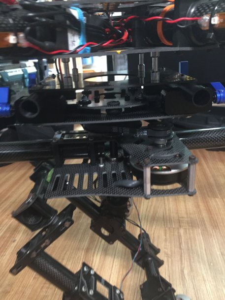

Also update.. new X8 H6/M5 carrier is almost complete. Just need to hook up the retracts and get the Vibe dampner and gimbal mount from Andrew who made them specifically for the M5/H6. (I took moth of mine over for him to measure and create the mounts) So I should be back up and flying with the H6 in the next few days.
SleepyC

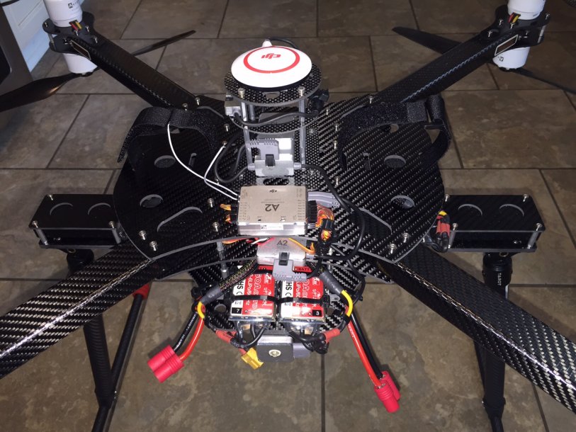

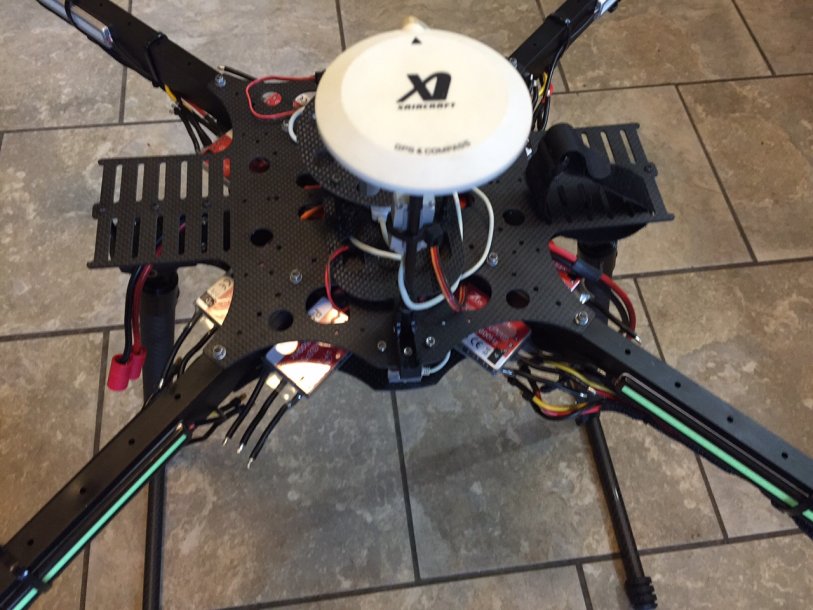

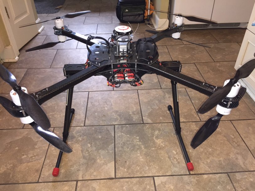

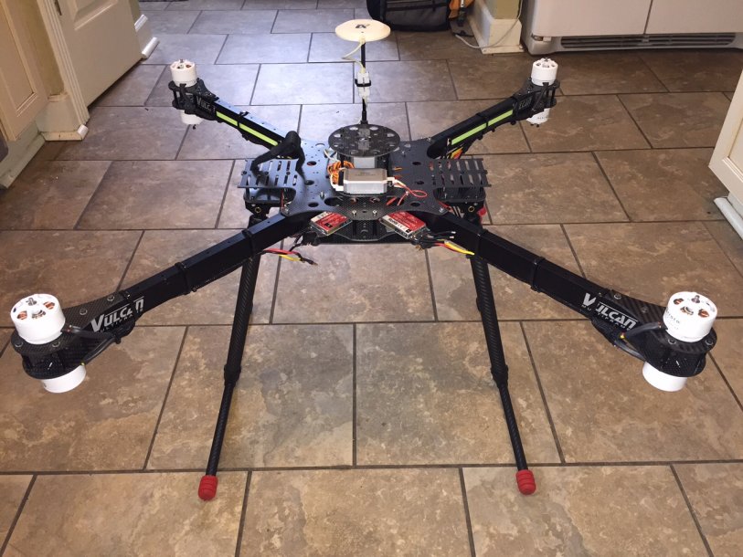

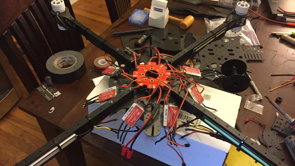

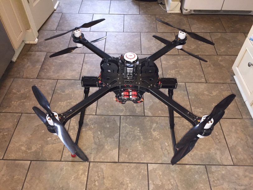

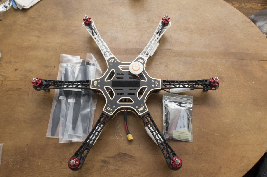

Ok guys, with the weather in the crapper and the wife and kids gone it's been 16 hrs a day building on the dining room table!! And I'm getting some stuff finished!
knocked out the Hexacrafter X8, just need the Movi M5 gimbal mounting plate and vibe dampner which should be in tomorrow. I think the rig is AWESOME. SO solid and pretty. This has been my best build ever...
View attachment 25232 View attachment 25233

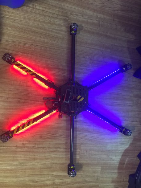

And then, I rebuilt my H6 hauler a Vulcan frame but this time with Falcon Drone Systems frame plates. These are AWESOME, and give an old Vulcan frame a whole new life! I just need to find bullet connectors. I ran out and trying to find 24 female 3mm or 4mm bullets is proving to be hard locally. But again, this should give the Greasy H6 a 18 min platform on (2) 10K batts... STOKED!
View attachment 25234 View attachment 25235
