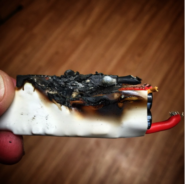

A T-Motor 80a?
No these were T-motor 45 Amp ESC's on Avroto 3515's. All 7 other motors were at 105 - 110 deg/ ESC's as well. The rig was very well put together and was not puling hard amps, hovering around 50%. I believe it was simply a bad esc. The rig was super efficient only using 5200 mAh for 5 min of flight, with (2) 10K packs it would have been a solid no worry 15 min flyer.
The top back motor stopped and the rig hardly noticed, just bobbed one time and then keep flying like normal. I noticed the stopped prop and landed immediately at about 3 feet off the deck the ESC burst into flames and produced the reddest smoke I have ever seen. I landed un plugged everything and let the esc stop burning... Here is a pic of the ESC after I cut it out of the rig...
I am going to rebuild the entire rig that way I can rest assured that everything is "OK".
New esc's and all... so if anyone is looking for 7 T-Motor 45 Amp Simon K esc's... let a dude know!

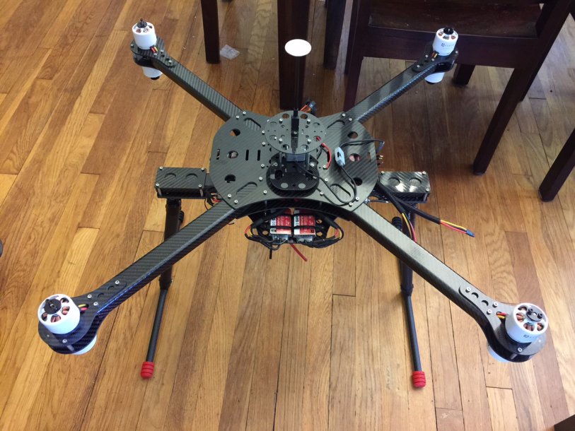

In the mean time I am making some decent progress on my M5/H6 hauler (replacement)
Why re-build when you can NEW Build!
Hexacrafter X8! I was on Andrews butt to make an X8 for over 2 years, as were others.. so nice it's finally here!
