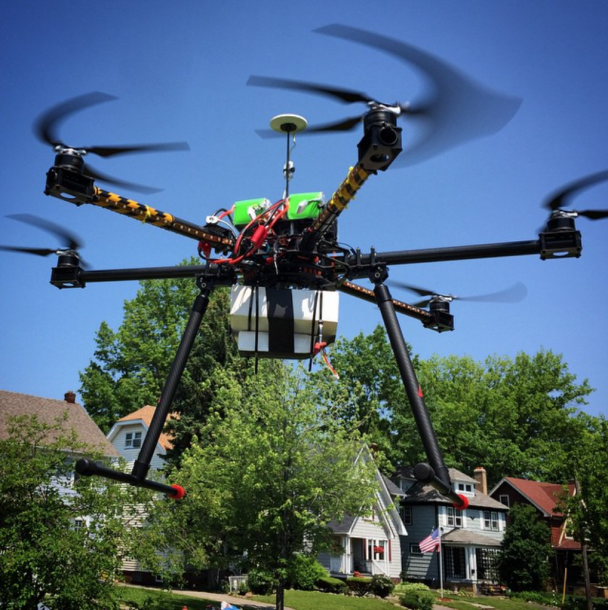

OK.. flight tuning of the old Cinestar sort of complete. Strapped on some old lipos that totaled 6.5 lbs (H6 + GH3/4 ) and then flew some in the front yard. I just got it hovering really nicely and a few trips around the yard so I think I will go to a larger field later today and try to get some real flights on the rig. I forgot how efficient this guy is. With the (2) 10,000 packs on her, I should be looking at 15 - 18 min of flight time!! But I'm double check that later with actual flights!

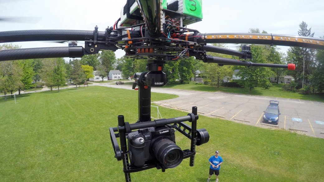

OK guys, here is Handheld Test #1 of the Gremsy H6.
After ten auto tunes I came up with the settings that seem to work pretty darn great. After watching the footage I may want to slow down the pan a little but the pitch and roll seem pretty darn good. GoPro mounted to the top handle of the Gremsy, GH3 24p 1080... on the H6... No post what so ever except to layer the two clips and add my voice.

Wow. Pretty impressive! Great work with slapping the GoPro footage in there. Really shows how much it was bouncing around.
