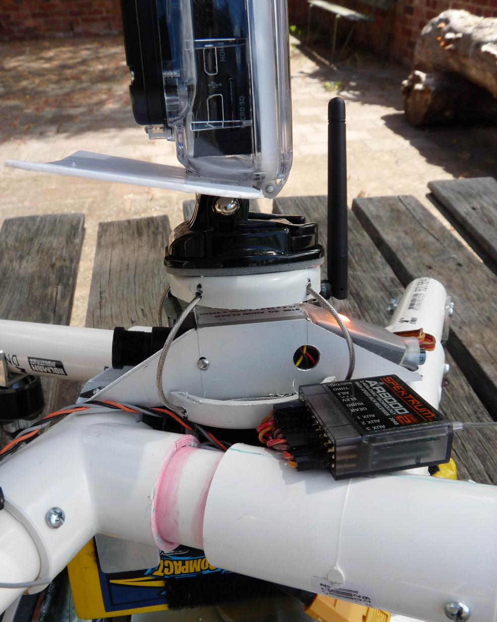

Hi all, anyone know anybody using any of the Scarab range of Frames with ZeroUav Fc's?
If I don't communicate with anyone before like to wish all a Merry Xmas and Happy New Year.
cheers, John.
