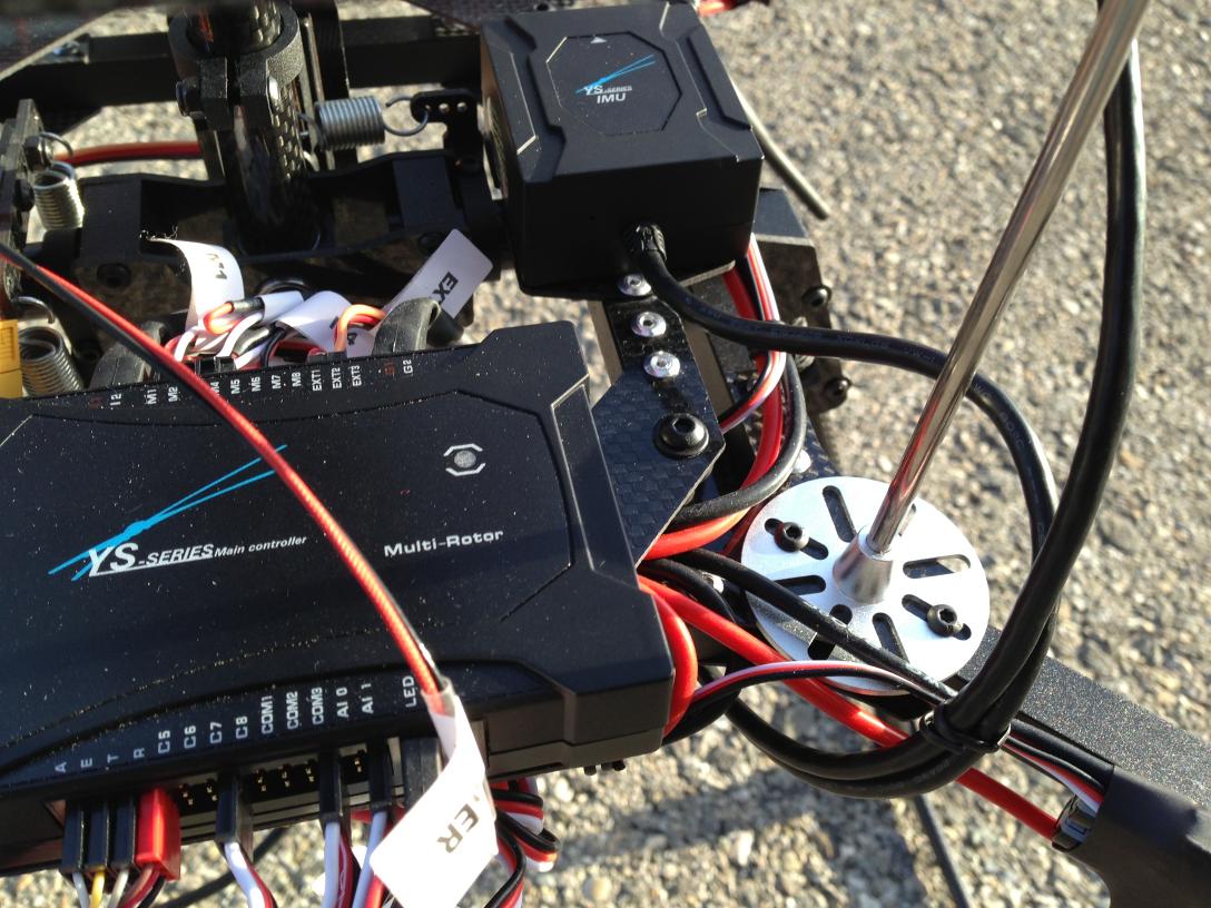

Hi Philippe,
Pretty impressive footage! You using a 5N? Also, one question in regards to the wiring harness. Did you make it yourself or did Zero provide it with the kit? Curious how you routed all your servo/power wiring. I am not sure I have run mine the most efficient way. Jim
Hello Jim,
Thanks for the compliment, I think it could be even better, I will soon try to get a little more out of the gimball stabilization, I still have few movement sometimes.
I am using a Sony Nex 5RK.
for the wiring I will take some pictures, but in general for the controllers the wires of two of them are soldered to the wires of the next one, the 3rd one has wires soldered to the 4th one in order to only have 2 wires going to the battery connector. For the servo they just go clean to the flight controller. Everything is as clean as possible to make sure it can not move and change the magnetic field in the system not to create perturbation to the compass.
View attachment 8567View attachment 8568View attachment 8569View attachment 8570View attachment 8571View attachment 8572View attachment 8573
Thanks,
Philippe

The only thing is that it is clean. The most difficult was to understand how to use the Futaba radio, usually I use a Spektrum. Making the compass calibration was not easy since it took some time to understand that the blue light should always be on all the time during 3 turns which was not simple. Else nothing at all was adjusted.

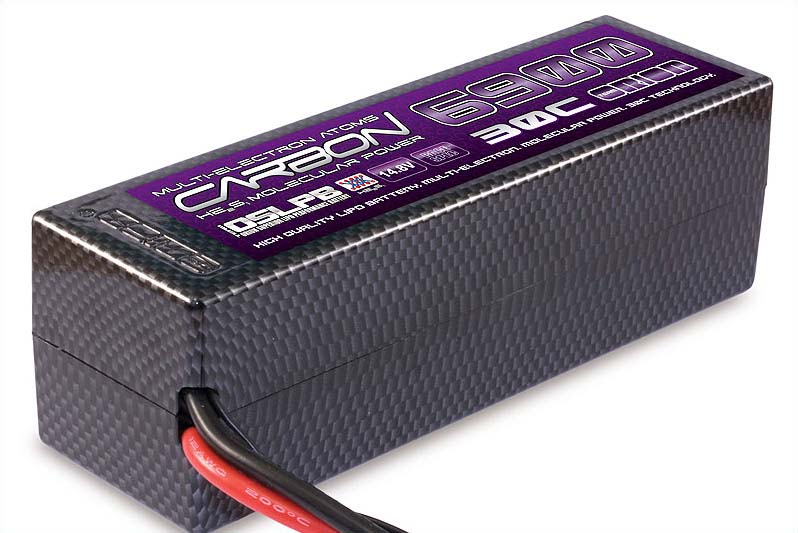

Hi Philippe, what can I say brilliant footage what size battery are you using and what times are getting and Jim asked tha same question are you using the 5n camera? I am totally jealous cheers.john.
Hi John, 5RK, to balance it properly I had to use a Team Orion 6900 4S.
I don't know how long I can fly yet, Actually after 8 min I have used about 4200 mAh from what the tablet is saying. But I guess 3.65 per cell is way to high, I will make some full discharge after a flight to see what is really left. I am waiting the small light lens to use a smaller pack. Actually the camera is too heavy and the battery need to be heavy to balance it.
Phil
