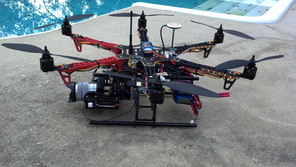

Finally have my 470 flying and filming. Very happy with the NEX5 and the 470 gimbal system. Once I found the ball park for the flight parameters, fine tuning was easy. Now adding a remote (rc) switch for the NEX5, and high res CCD camera and 500mw transmitter for video.
All in all while it took a while to setup, and tune but it was worth it.

Send me a PM and I will get you the parameter screens from my GSC (if you have any interest). Getting these parameter settings close to begin with will save you a couple of weeks of tweaking (and or crashes). Using the parameters as shipped, for me anyway, resulted in a multirotor that was VERY unstable and would literally fall over (fall out of the air) as the FC was not authoritative enough.
I was fortunate that I took the whole test flight process very slowly and all of my incidents did not damage the 470. I was also fortunate to already have a flying YS-X6 multi rotor so I knew the FC would work well once configured correctly. I can see someone not taking the same slow and low testing approach and having a major problem.
I now have a stable and reliable multi rotor that I can fly with confidence, while I have not flow in a strong wind yet, it does handle a stiff breeze (10 knots or so) very well. I have posted a quick video for you to let you know that on the other side of this process you can have a great multirotor that shoots stable high quality images.
Here is the short video from my Steadi470, https://vimeo.com/55812975
(I know seeing other folks video helped keep me going when I was working my way through this process :)

Here is how I have it configured. The SBUS receiver has one lead running from the receiver SBUS port to the AP (channel 7 port).
The second IMU is then connected to the AP via the AP AETR ports (see attached). One of the ESC's has a power wire (power lead) connected to the AP (preconfigured by ZeroUAV as shipped). Therefore when you connect the gimbal servos to the AP they receive power from the 1 ESC with the power lead running to the AP.
There should NOT be any other servo wires running from the receiver to the AP.
Hope this helps.
Mark
