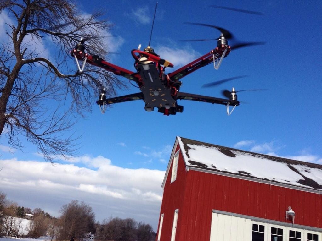

Contemplating build something similar to Boltzman's modified discovery with brushless gimbal for nex 5 or maybe a black magic pocket camera with small light lens. Guessing an older discovery frame would be adequate so front end can be modified and then maybe the new 16mm Kloner arms, some 3515 / kv400 motors with 14 or 15" props & 6s battery might yield some decent flying with times in the low teens. Also assume steady filming.
If so, is it possible to increase the battery area height with some spacers on top of arm mounts to maybe handle a 6,000 mah or more battery?

I'm wondering if the old Discovery top/bottom frame plates are available, if I just should get those since the front will have to be modded to handle a brushless gimbal....
I would think it would be relatively easy to put a 1/4" or 3/8" spacer on the arms and then use longer stand offs and still get the battery mounted without have to hang it off the bottom...

Like Boltzman's build, I'm going to try hanging 2lbs of gimbal and camera off the front, so the Discovery Pro kit doesn't seem to make sense to hack off the front and the gimbal.
Did I read where you have a bit of dampening on the arms? Are they easily foldable?

Maymidroix, on the Discovery, what is the largest prop you can run.
Kloner, what is the largest on your? Did you settle on 16mm or larger CF arms?
Thanks....
it would be unlimited due to any length tube and slide in, but were selling them ready for 14" or smaller, trim down the tube to taste,,, different prop/length make differences in flight charecteristics

Kloner, with your arms & 400kv motors, fpv, etc, gopro/gimbal, what's your discovery pro auw?
good question... i have it all written down somewhere. it was only heavy on what battery i used. everything from a 2700 6s inside the frame and a 5300 6s outside the frame to just either or..... both packs loaded with 14" props that at that weight was kinda light for the props got 28 minutes slowly flying around, 20 minutes wide open. i think it was 175-215 mah a minute or around that.... 10 amp hours started flying shorter flight times.

You can use up to 13in props. The arms only weight 67 grams and no major assembly is required. Also plastic don't dissipate heat from the motor.
www.facebook.com/aimdroix
I have a set of your arms on a f450 that now is a 550mm with tiger 2216's. Flies very nicely.... With gopro / 2 axis gimbal get an easy 13min w/ 5000 mHa 4s.
Trying to figure out how to build a little bigger unit as a quad or y6 that will slow fly for video in the mid teens (in the air) carrying a 2-2.25 camera/ gimbal system.... guessing 4000-4500g.
Smoothness of video is primary objective. I'm not a FPV fast/ long range flyer.... Trying to keep it relatively small, but strong enough to handle a little wind. Just redoing my x8 with low kv motors now.
