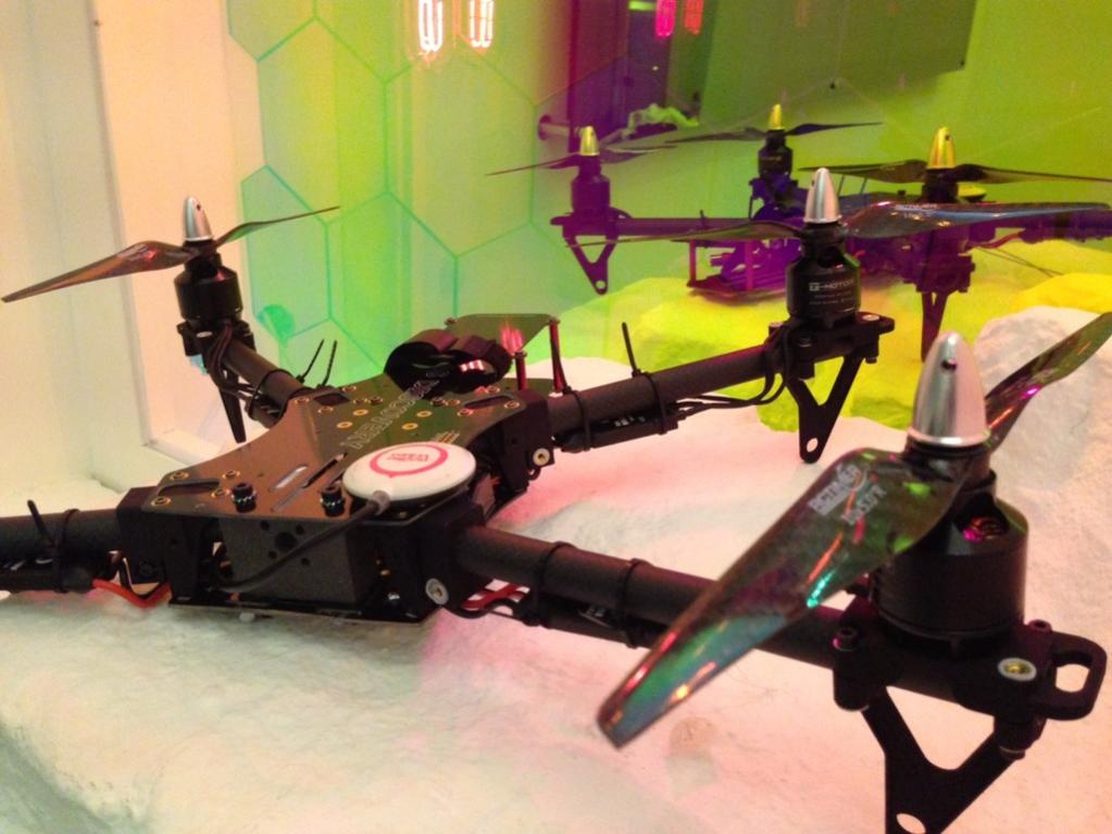

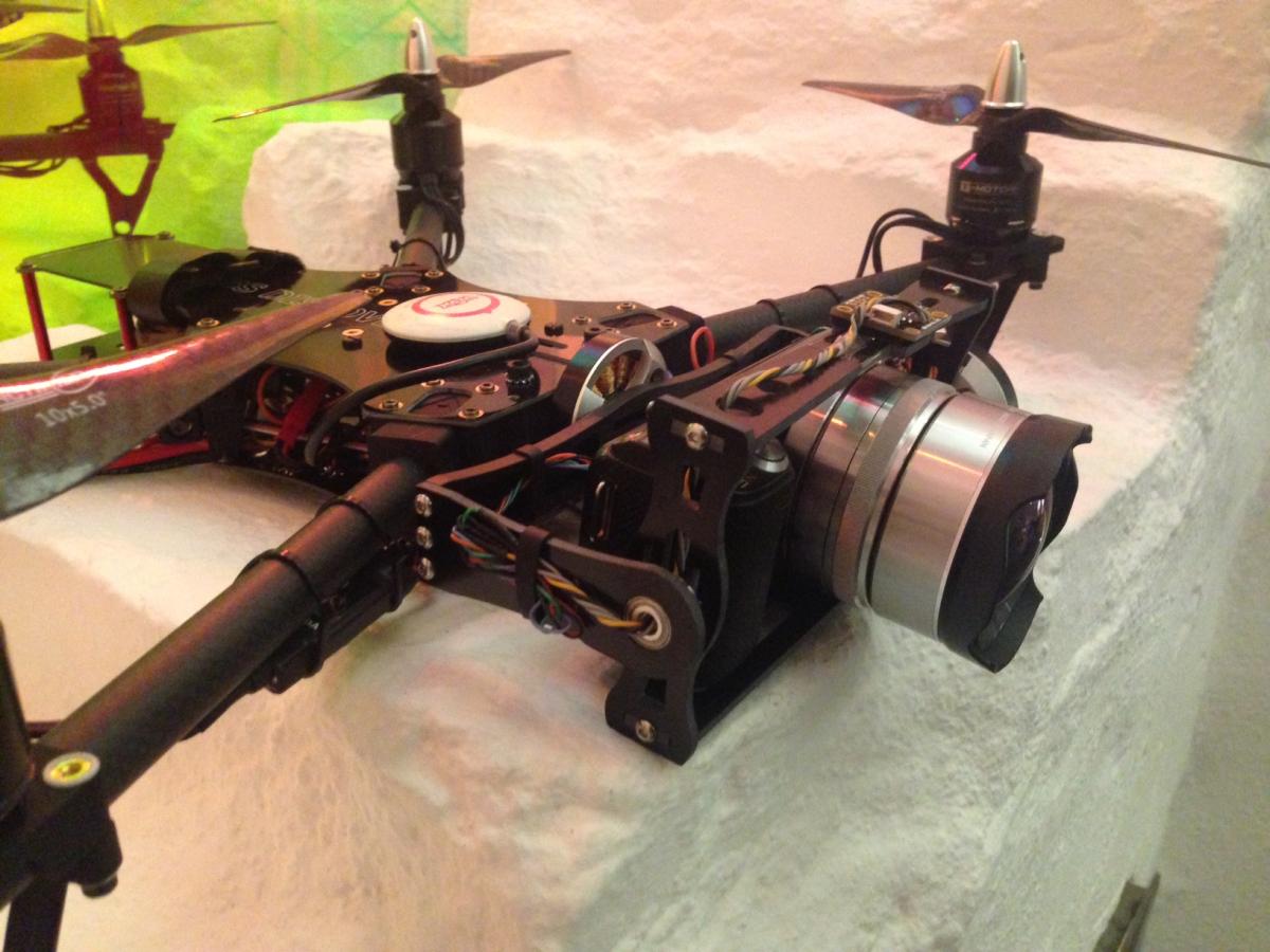

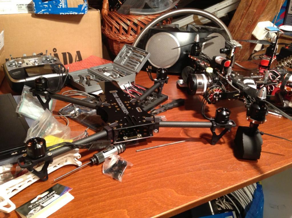

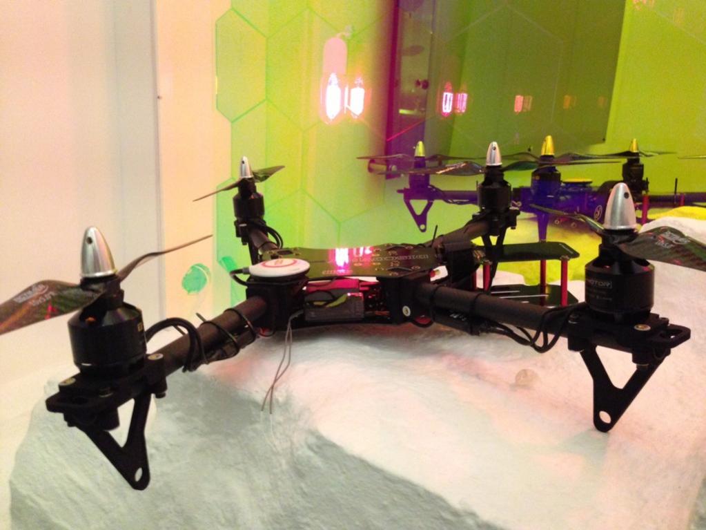

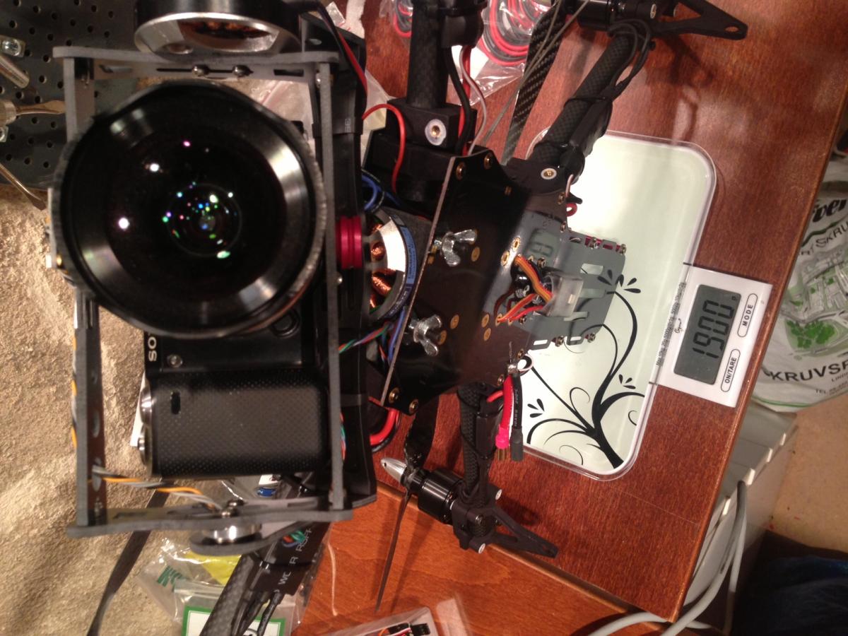

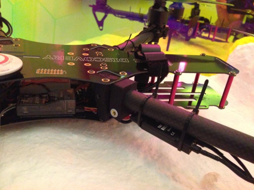

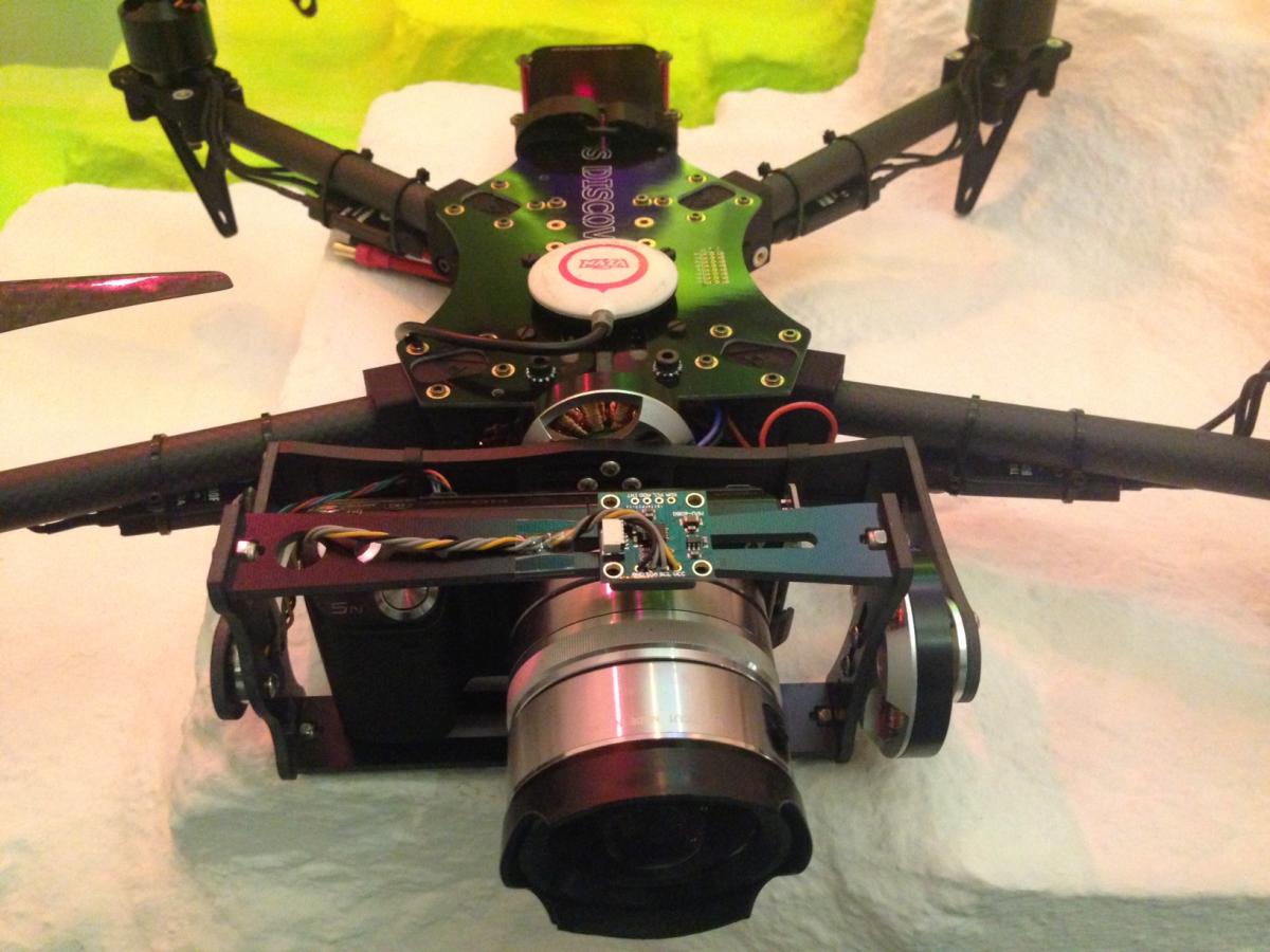

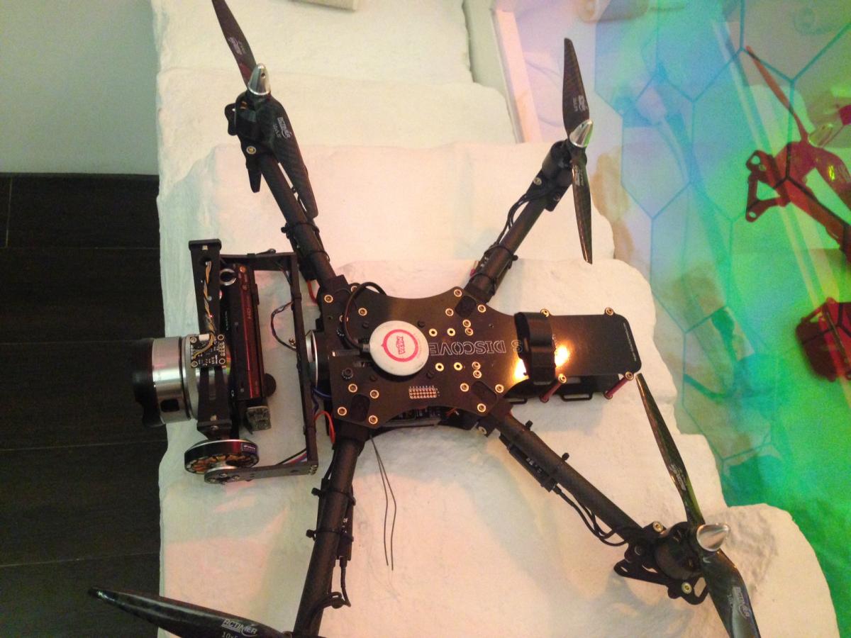

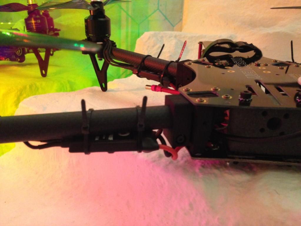

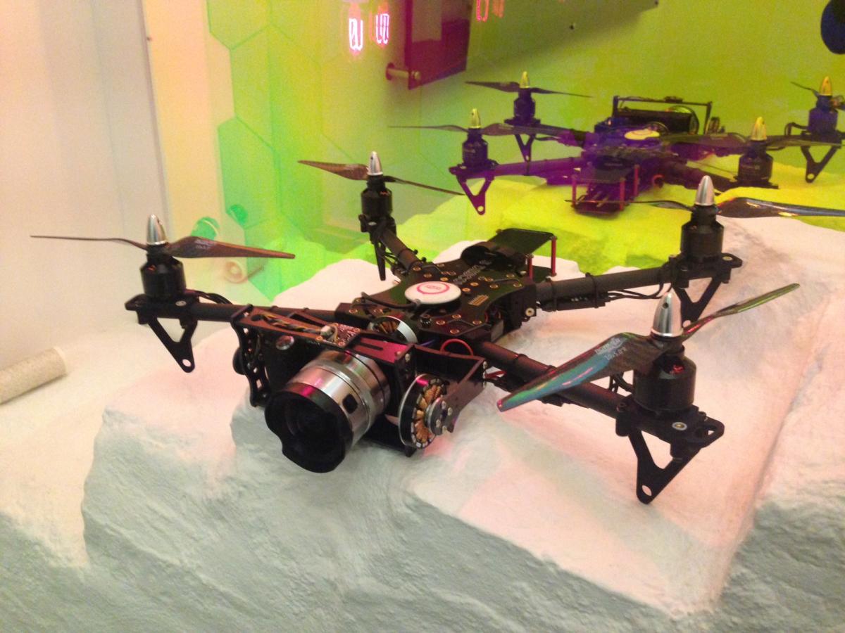

I had the privilege to test some early prototypes of the new upcoming Klonerarms. Just got my kit and did my first test flights yesterday. The reason why I opted to try them out is that I have an own build front mounted NEX-5 brushless gimbal design based on the TBS Disco frame. I use this setup when I travel and the complete kit needs to fit in a backpack. I have been flying this design since early March and have been concerned regarding the radial flexing using the DJI arms due to heavy lift (resulting in bad yaw stability in wind). I did my first sample flight with a 4000 mah 4S battery without any extra payload (AUW 1513 grams) and got 13 min flight time. The acceleration is so extreme with the 2814 1000kv motors (Naza manual mode) that you can barely see the quad after 3-4s in the sky. The frame is very rigid, no radial flex, and flies extremely locked in. Later on I did a heavy lift stability test with a 5800 mah 4S battery (frame weight + battery weight 1644 gram) and a payload of 1368 grams, hence a total AUW of 3012 grams. The total fly time is 7:53 min. Stability is slightly reduced by the challenge to set the correct center of gravity but the frame is still very rigid, once correctly balanced it flies like a german tank. There is still a lot of power left but if I could I would preferably Use longer arms to manage the momentum interia better (i cannot due travel size). You can still detach the arms in a fairly easy way and I will work on a quick mount design later.
The total AUW with the brushless gimbal, NEX-5 camera with 16mm 2.8 lens + 0.75x wide angle extender and fpv equipment is expected to be lower, in the range of 2700 - 2800 grams. Will come back with some test results later. I already have a kit flying like that based on the DJI arms. I also use 4x inflatable floating units (Waterbuoys) for water crash disasters, another 120 grams required..
My setup:
TBS disco frame v1, specially cut for front mount brushless gimbal
GotheliRC VX5 brushless gimbal, modified without dampeners, hard mounted on the roll motor with an own cut MDF block attached to the frame (see pictures below)
T-motor AS2814 1000kv motors
TBS Simonk ESC
Goodluckbuy 16x14mm 330mm carbon tubes cut down to ~210mm (DJI arms equivalent length)
Rctimer 10x5 E-prop style carbon props
Naza v.1 with GPS
Zippy Compact 4000 mah and 5800 mah
Klonerarms
Bare frame weight (Including all electronics but excluding battery) is 1129 grams.
The build quality of the 3D printed arms is really good, though some minor tweaking was required to fit the screw inserts that are manually ironed in he prototypes, this is expected to be fixed in the real production units. All pieces are designed with the thought of perfection, every piece is very robust and the screw inserts simplifies the installation significantly.
So far so good, this is great upgrade for any serious TBS Disco owner if you want to get improved stability, heavy lift capability, do extreme speed records of +80 mph and have a lot of potential upgrading options by simply extending the carbon arms. You will also be able to build a very compact aerial photography kits that fits in a backpack where you can unpack quickly and start flying by only attaching the props. Imagine this in a comparison to S800 EVO cost, size and weight design. Cost for my full kit is far less than 1500 USD including the brushless gimbal, receiver etc but transmitter and NEX-5 camera.
Later on I will test the Klonerarms with T-motor MT3520 400kv motors and 15x5 props on 6S. This kit is expected to lift a front mounted brushless gimbal for my 4K camera design, all portable in a backpack with long flight time endurance.
To be continued...
