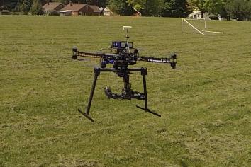

Been working on my gimbal. Got a NEX now, and doing test flights. Had bad jello, then changed to softer jello-balls. Big difference. Last flight had more jello though in some wind, probably because I had my gain turned down by accident.

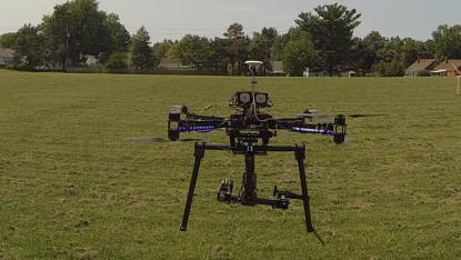

Got a few flights on my X8 with SuperX. (I have a small lead bar strapped to the gimbal to simulate the weight of the camera.
Flew great. used 1.2 across the board and .9 for height.
Might drop it to 1.1 we will see.
Rig flew awesome though. No complaints!

Well big news today. Moving my gimbal to the middle of the COG and batteries to the top of the bird made THE difference in my vibes and performance. Most vibes are .2 or less and the video has NO wobbles or jello. Once in a while the props or arms show up in the image, so perhaps I need to drop the gimbal down a few inches. Since I had to move the batteries to the top I had to get rid of the dome. Also got rid of the two larger battery mounts, extra cabling, and an FrSky GPS telemetry module I've never gotten to work.
mediaguru
Followup to last post. Had a great flight last night which produced nearly flawless video in some aggressive flying. But upon examination of the bird at my desk, I noticed on arm is slipping. Grounded until further notice. May need to pin the arms somehow or epoxy/glue them. Suggestions welcome.
