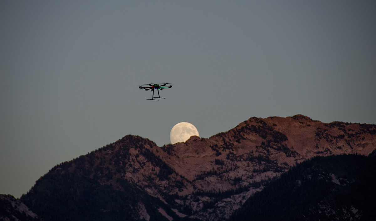

mediaguru
Last night...
attachment.php
I've got my gimbal and camera pretty dialed in. So that last couple of flights have been sans-camera/gimbal and just for the fun of flying. Didn't even change the gains and still flies fairly well. I'm getting 20 minutes without camera/gimbal/rails on two 5000mAh batteries.
