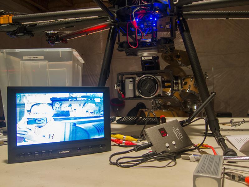

It works! Need to finish up the TX and hope to do a test flight (in a wide open area) this week.
attachment.php
