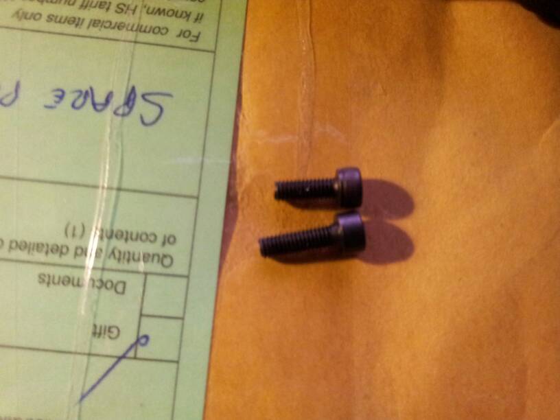

Got the adapter.awesome work Denny. Just one thing, one of the a screw one longer.Funny enough that I also don't 3x8. I have 3x10 and 3x5 haha.of to lhs tom

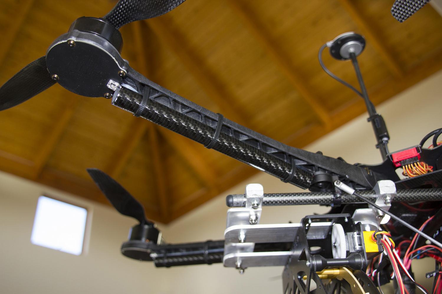

I hope that this is not too terribly off topic but I thought that it was good information as I was blaming some of my problems on my props:
I was finally able to test my reinforced arms on the S800. What a huge difference this makes with an added weight of only 4 oz. I forget who it was that originally posted this idea but it sure was a good one. I cut 6 pieces of 16MM CF tubing at a length of 7.75 inches. The tubing I used was actually 1.5MM wall thickness because that is what I had available but you could use the more typical 1MM wall thickness and have the same results, I'm sure, but at less weight. This length will take the tubes from where they attach to the hub all of the way out to just past that little tab that hangs down before the LED under the S800 arm. I used my Dremel to cut a 1/2 inch slot for that tab to fit into. This is important because when you include the tab you help to provide a little bit of lateral support for the tube when you are positioning it with wet silicone (helps to hold it in place). I ran a perfect bead of regular clear silicone along the entire length of the tube (including the slot itself) and then carefully pressed the CF tube up under the S800 arm. I held it in place until the silicone hardened by applying only black tape to support CF tube. If you try to hold it in place with wire ties you will disturb the position so you just have to be patient and hold it in place over night with the tape. The next day you can remove the tape and place three black zip ties evenly spaced. The arms are so much more stable like this! My video is many times better than before and the craft hovers without even the slightest twitching as it did before. This is a very worthwhile fix for these otherwise flimsy S800 arms. I believe the silicone is a very critical part of this equation in minimizing the flex. I tried one arm without the silicone and it was hardly worth doing. This solved a lot of problems for me. However, as carefully as I have tried to balance these DJI CF props I still believe that they are creating a little vibration. I am eager to try the adapters and perhaps the APCs or ???
