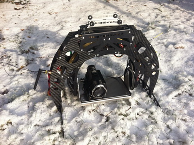

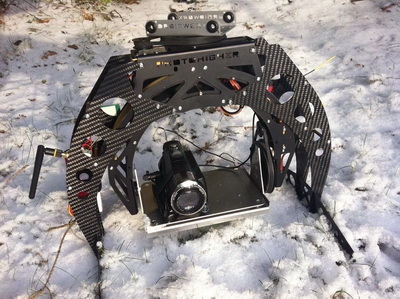

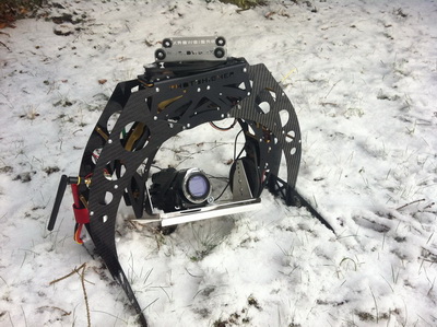

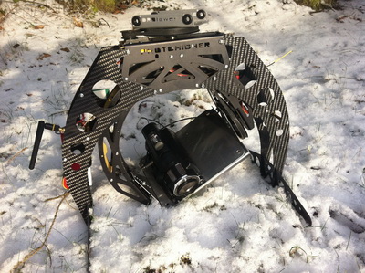

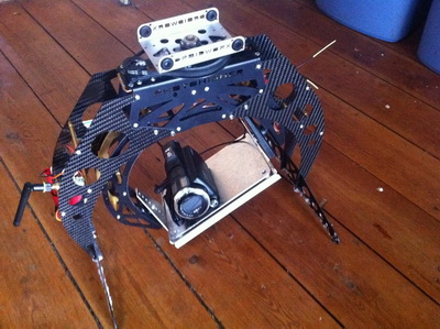

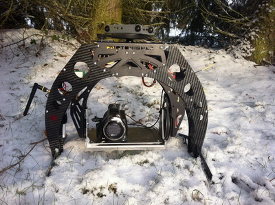

Picloc 3X TEMPERATURE DRIFT PROBLEM ?!?
Hi George,
now it is Winter here... ;)
I have the new Firmware V0.55 and the Pocloc 3X. Installed in AV-200 Gimbal...
The temperature drift Problem:
Take a look at the pictures...
First Test: start @20°C indoor:
1) from 20°C indoor to -5°C outdoor, fresh power on, every think is okay...
2) 10 minutes later (!)
3) fresh restart, every think is okay...
4) 15 minutes later. (maybe the temperature a little bit increase because Sun is shining ???)
Next Test: start indoor @ 20°C
3) now from -5°C outdoor to +20°C indoor
4) 15 minutes later (!)
It looks the die drift compensation from cold to warm is (better) working.
From warm to cold we have a big problem !
And it is impossible to bring the gimble in normal position with the RC , because the angle limits.
Please help... I have a lot of flights at THIS weekend... ;)
PS: and i need a second Picloc 3X Pro from you... Can you help?
I think the problem from BorisS is the same: LINK
Best regards, Kai Schädel ;-)

@Kai... Temperature compensation is still not on in firmware. You must leave Picloc take ambient temperature for 5-10 minutes for correct operation.
I suggest strongly to do the same with your flying CTRL boards. No it's not the same issue as BorisS's post.

aircam4u
Hi George,
I talked to Jochen and he told me that he had the same problem with one of his Picloc's.
I have the acc cooled with ice spray and was able to find the fault on my Picloc Pro.
Then I tested my second Picloc (only the standart version), and the problem did not exist... It works perfect... :nevreness:
So I think it's a hardware problem on my Picloc 3X Pro!
What should I do now?
PS:
I think it's the same problem that has posted by boris. When I turn the bracket while the slant, it looks just like in the video of Boris.
