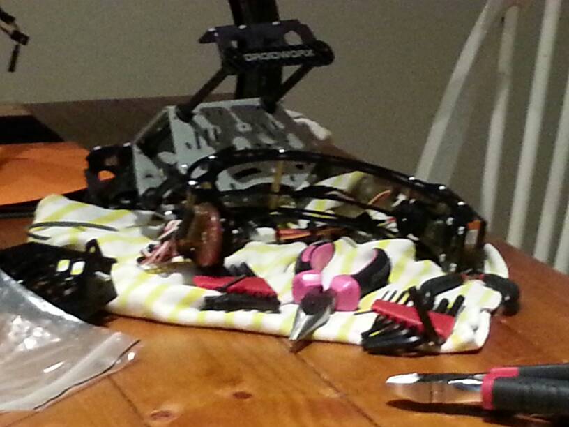

Looking good Nic. I've been taking a break the past month or so after a beater crash testing my last settings which tweaked my frame and rails as well. Started to have at it again tonight with limited success, having real bad twitching problem at startup which. Tried making sure there was no play in the rollers since it seemed awfully sloppy, took the rail cage out of the frame and tried to straighten it out, a little smoother but still has a few tight spots. I have a repair kit but haven't taken the time to rebuild it, are there any diagrams in reference to rebuilding the unit? I didn't notice anything on the PH website to help with that. Also, do you know if they have rollers available as spare parts?
Thanks, and keep up the good work.

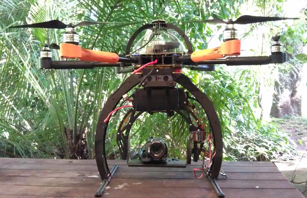

Is Itnecessary to use autotune after manual tune?
I follow instructions on set up and carry out the full auto tune. Since I got the V1.2 board the only time I went belly up is when I did not return the try to level after setting the vertical level. I am still on 1.2.2 firmware but I did set one up the other day on 1.6 and I see now there is a dialogue box telling you to return the try to level before hitting auto tune.
Worked first time.
PS just make sure when you hit autotune that the gimble can do its full travel either way with out hitting the floor. I set mine up with the copter on ntwo black lifting it well clear of the worktop.

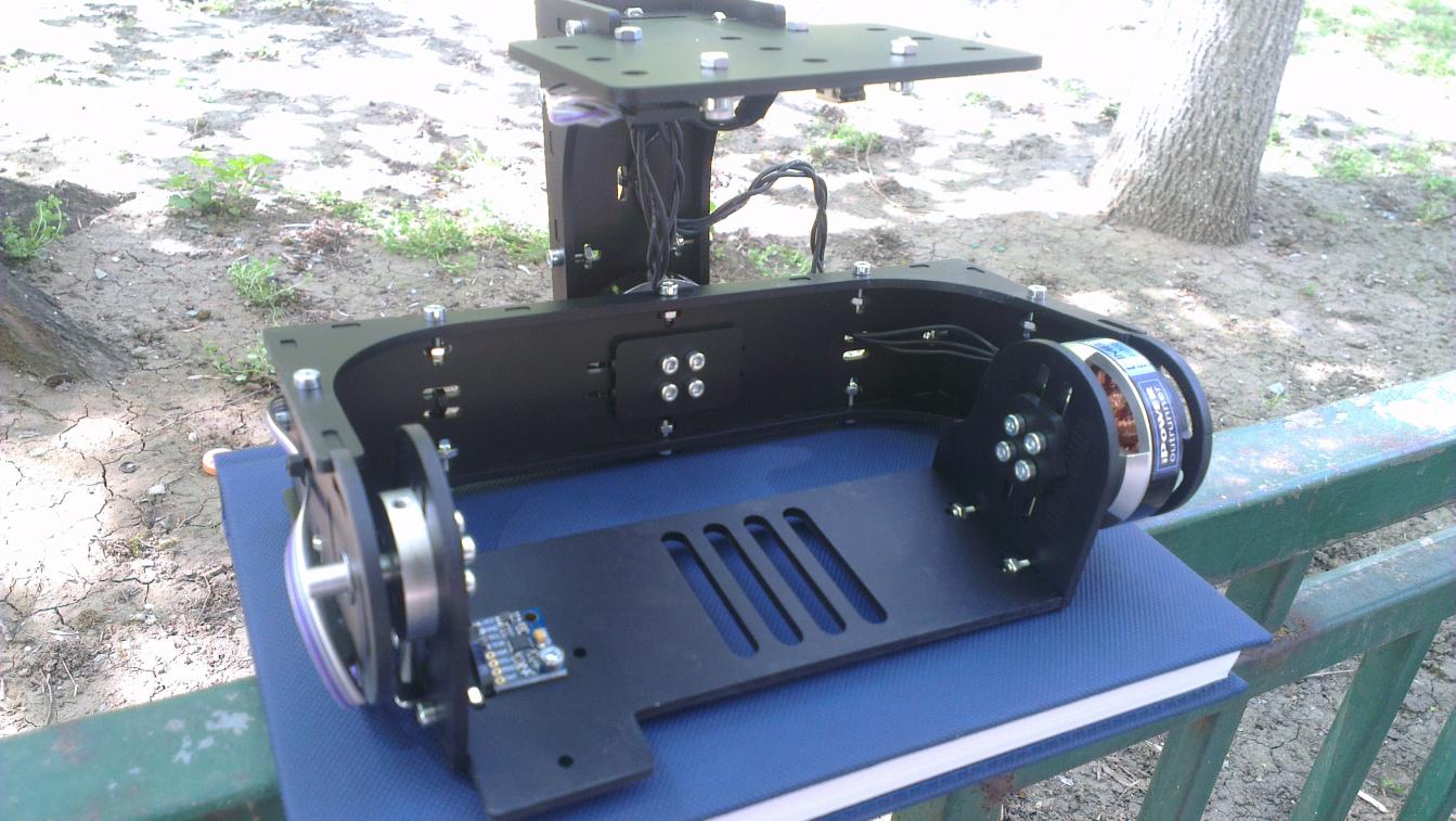

V1.7beta on my diy mount / DW VM-6 / HFP machine. Wind 5-10mph. Piro / yaw and aggressive flight testing.
The horizon was not perfectly level on power-up. There was some small roll effect during the piros. Most of the flight (especially the aggressive stuff)... very happy.
Just heading out for the day... video uploading...
