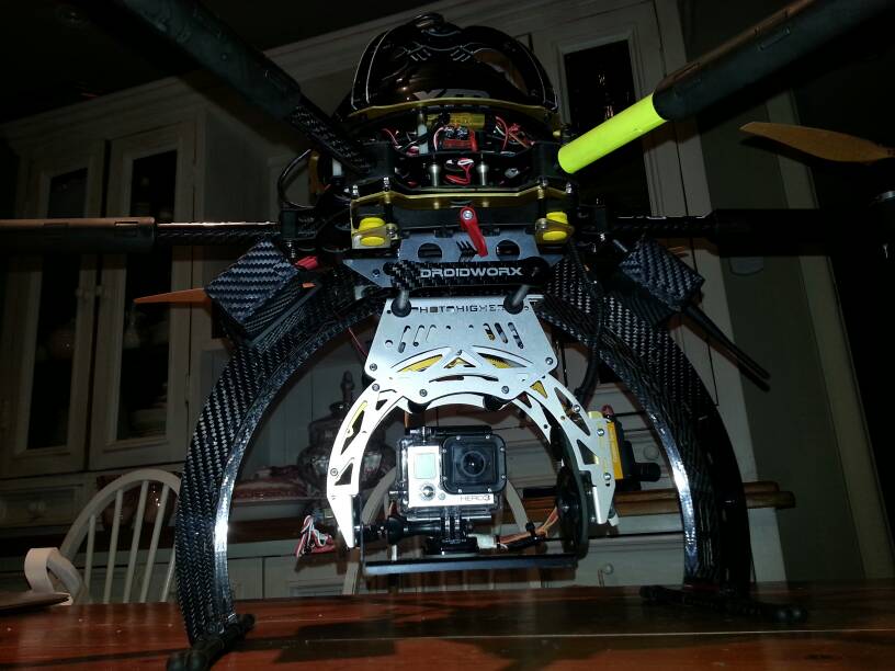

nicwilke
Check that your skyline is rigid and tight. I found mine slipping today. Just another thing to keep an eye on. I added a small washer to assist

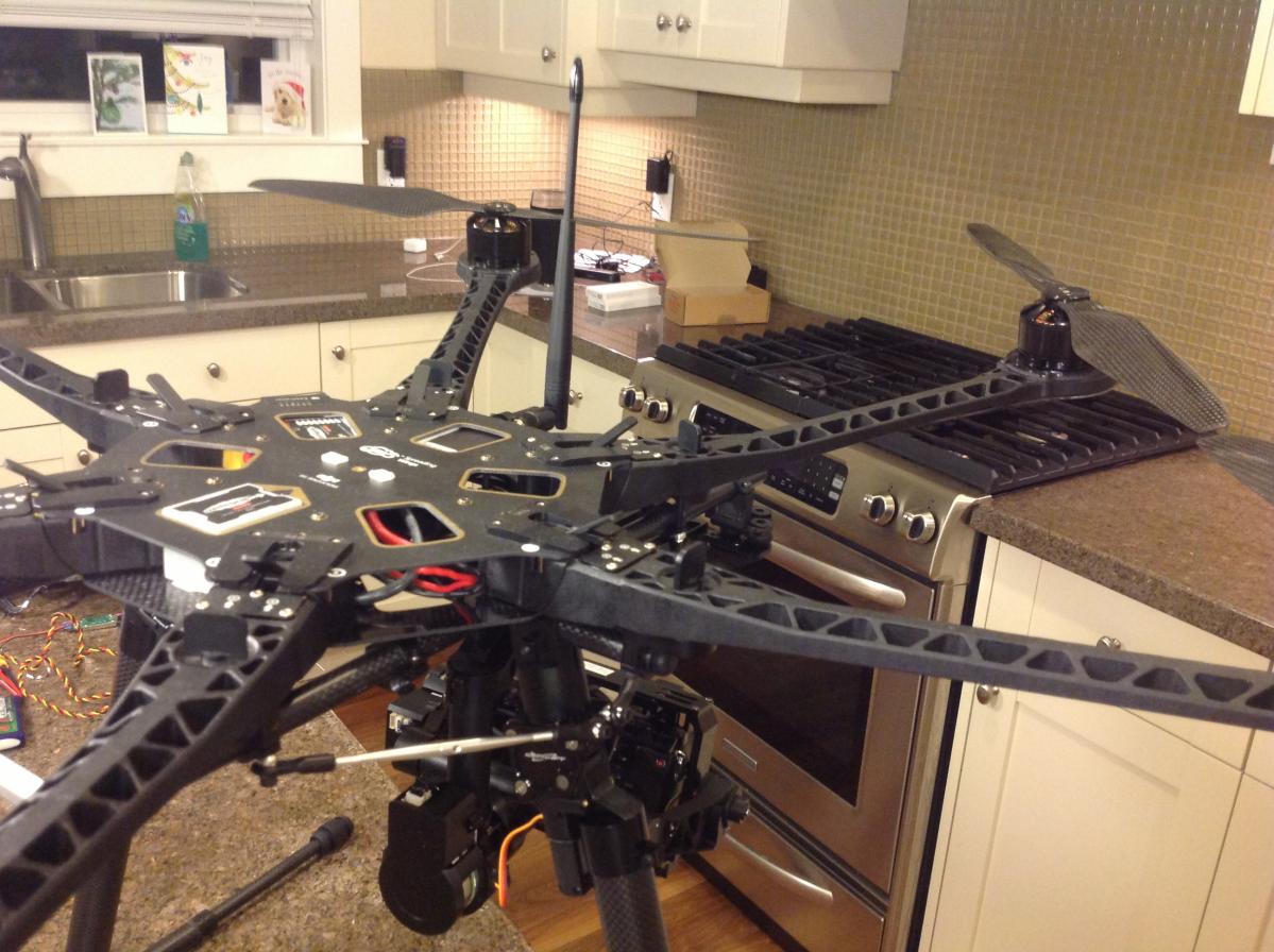

nicwilke
Nic, sorry to hear your crash. Hope the damage wasn't too bad.
Looks worse than it was. The great think about the XM design is it split apart a little. Few things that needed attention, and worst damage was the AV130. I have parts from that already on FedEx. I've straightened it out, and have it running again, but will replace the roll cage when it arrives.
I'm not getting drift on roll or tilt. Note in video I need to hold the tray to boot? Not sure why, but if I don't force the tray to stay still when servos kick in, it errors out.
