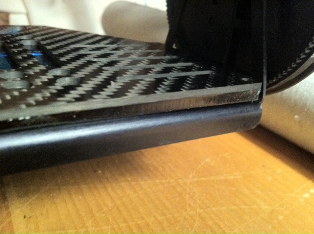

okay have the extra plate for stability and the vibration gel that Droider recommended. I made a Plate gel Alu Gimbal sandwich cant wait to try it out tomorrow !

i think you never got my email to your @mac.com address. The plate was actually send to me by PH. They said they are aware of the flex issue on the Alu Gimbal for heavier DSLR and they already had it if I understood them correctly.

Hi Dave, just did that 10 mins ago. When i asked for the CAD files and instead got the plate already finished I didnt ask for any parts yet since the plastic washer I got from a hardware shop did its job just fine. In the mean time I want to change some screws and get the original washer and lets see what they will say. Going over my reseller is not an option. I hope they understand.

okay thing are getting better !
Gimbal plate and anti vibration gel did improve the setup. Although gusty winds and the fear rain will start again, and no question the flying should be improved by a lot, things have gotten better. I am not happy though with the nick jumps. My flying is not good its out of question but the kopter is just hovering and no strong forward backwards movements are forced upon it. Its not like i fly any better wit the gopro on it and there these nick jumps are not seen. So i will have to now start looking a the nick axis and do some fine tuning on the gyros. I will post my setting later maybe someone can read out of my gyro palm and tell me what I can change.
But i stay with my finding that the AV 200 with MK FC stabilization and a lighter camera works a lot better than with a heavier DSLR 1KG plus and yes a UBEC is used to juice the servos.
