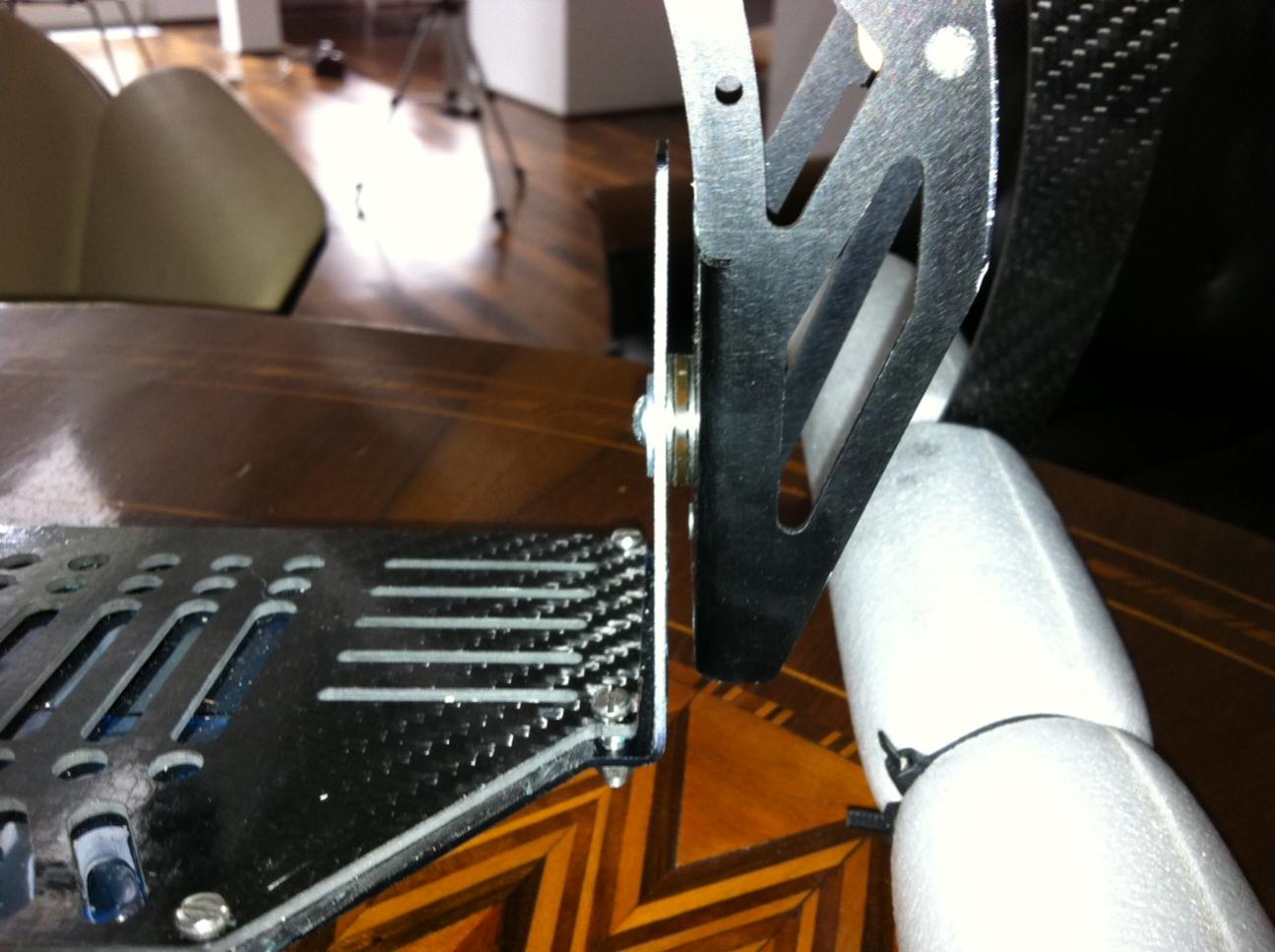

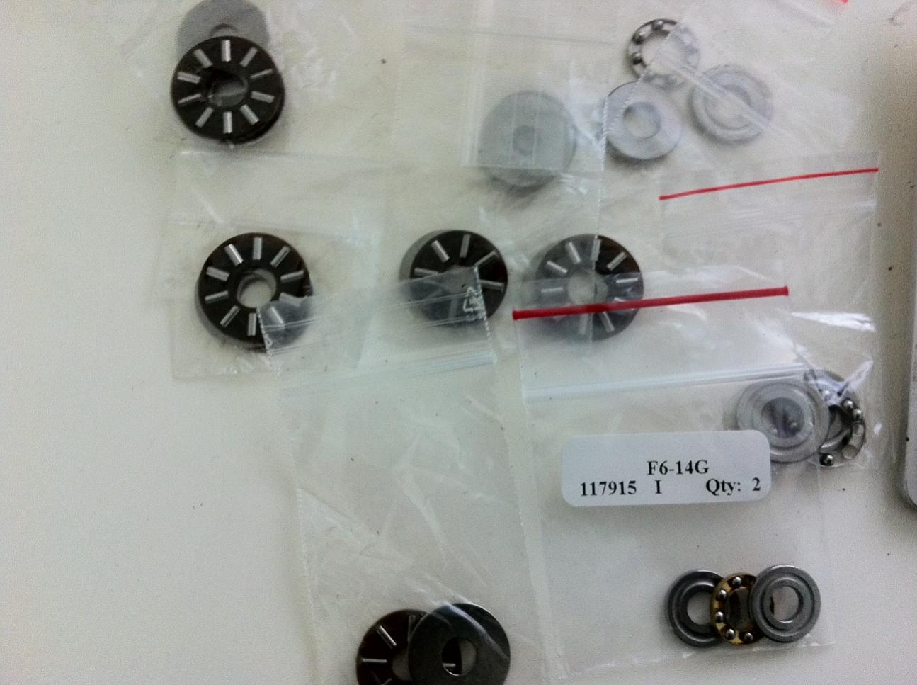

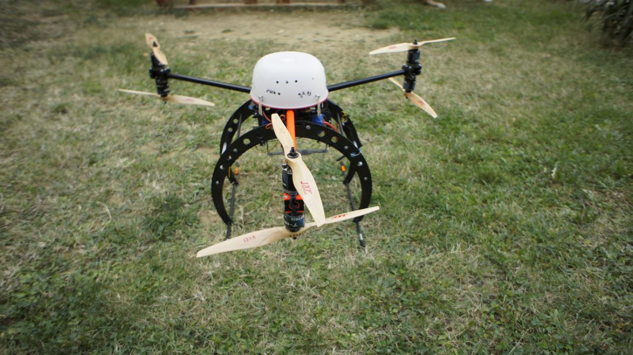

okay just got the thrust ball bearing and they just make sense ! Cant go out to fly today but doing ground test and feeling the reduced resistence i am confident they will work and improve the PH one step further !
I took the german ones: http://www.kugellagershopberlin.de/...=71&pname=axialrollenlager-axk0619--6x19x4-mm
and the ID of 6 mm fits perfectly. The Boca bearing seem to be of better quality but the ones with ID 6 have a small OD and in the case of stabilizing the gimbal the bigger OD wins.
View attachment 607 View attachment 608

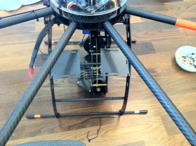

just got my new lipo holder plates, they seem to make sense since placing the lipo on it gives addtional stabiliy to the wobbely landing gear. I just hope that the extra weight if a harder landing happens wont crash the booms, whole landing gear.
jes1111
If the landing gear breaks on a heavy landing, that'll be a GOOD thing - energy has to be absorbed somewhere: better that it breaks something relatively cheap to replace rather than travels through to something more expensive.

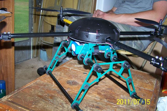

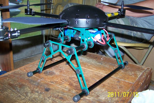

Boris, some people are attaching their Lipos in such a way that they come free on a hard landing which helps with dissipating energy.
MMMEEEEE.. Ive been battering on about that for ages... on my small cc quad i have the landing gear and batteries all just stuck on with velcro

okay before the crash :)
I think it has improved again by a bit but i still have small shakes on the nick/tilt axis although i am really just hovering and given it a little forward backwards movement, little yaw. I observed the kopter more closely and it lied ( past past tense ) in the air like a tank no hard corrections from the FC. Still the tilt jumps less than the last try though i think.
Am i asking for too much ?
[video]http://sprealinvest.at/better3/better3.html[/video]

coming to the point were i think some of the unwanted movements might also be due to my pid setting.
Took these two video showing the kopter hovering and at the same time the second vid showing the DSLR material. Vids are synced.

I reckon you still need to establish if there's a mechanical reason for the jumping or the controller is actually "commanding" that jump. Maybe get a servo tester and hook it to each axis in turn. Set the craft on the table in front of you (with the camera in place) and move the servo back and forth, over its whole range and also in short steps - see if it "binds" mechanically in any way. I'd also try tipping the craft by placing a book under one side and then running the same experiment - it occurs to me that the weight of camera may be causing some small twisting in the gimbal at certain angles and that may be causing the mechanism to bind.

@jes1111, I tried it all except the servo testing which i will do now. Its just seems like the whole AV 200 cant hold its state for one flight. Screws loosen up the belt is looser than before the roll serov is different jadda jadda etc. I think that the problem is exactly at the spot were the servos changes direction that in combination with a heavier DSLR. With the Gopro i never had any probs.

okay new pid settting did improve it a little, and its windy like every day, so testing is probably for nothing anyways.
