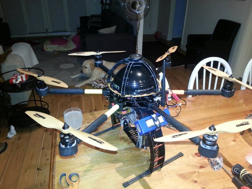

Busy little dining area in my house. My dog thinks this thing is great, when I pick it up, he darts for the back door to the yard thinking we're test flying.
