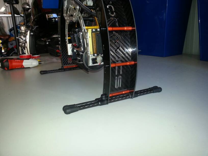

A little modification to the skids. I cut the 4 skids down with the steel saw, a clean straight cut. I found they were too long and this size keeps them out of wide angle view when using a hero or action Cam.

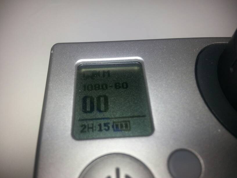

That was shot with the hero. 1080p, 60fps, conformed to PAL frame rates. I use NTSC to get an extra 5fps and conform in FCPX. I use the mid setting View attachment 8643
