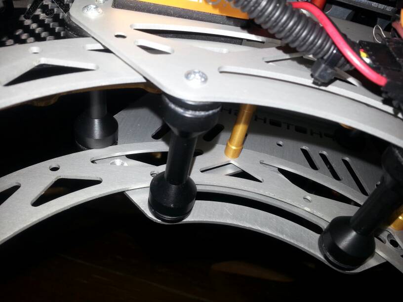

I've been working on the gimbal tonight. This Photohigher AV130 was having a caniption fit when simply hover testing last night. I tightened the roll gear wheel so it's teeth fit into the gear rail a little deeper, and also tightened the carriage guide pulleys. It's gone from sloppy to tight, but not too tight. This has in turn eliminated a large dead band in feedback to the RSGS skyline. Test coming up. I'll try to film it with an on board gopro to see if there's any unwanted feedback.

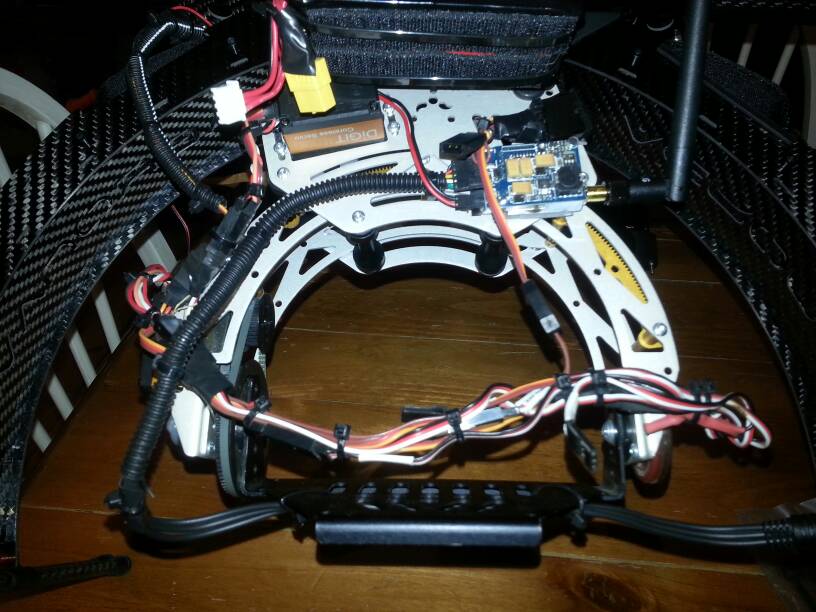

Hating spaghetti wires, I'm trying to tidy with some 4mm loom tube. It will also avoid catching when tilt and rolling.

You been playing knit one pearl one! ;-)
I got all my SL loom into a small black plastic box from Maplins twinlocked on to the servo.. neat as you ike.. Il post a pic later
NO on the AV200 it sits under the tilt servo. Ill get some pics at some point but I just got home from working away

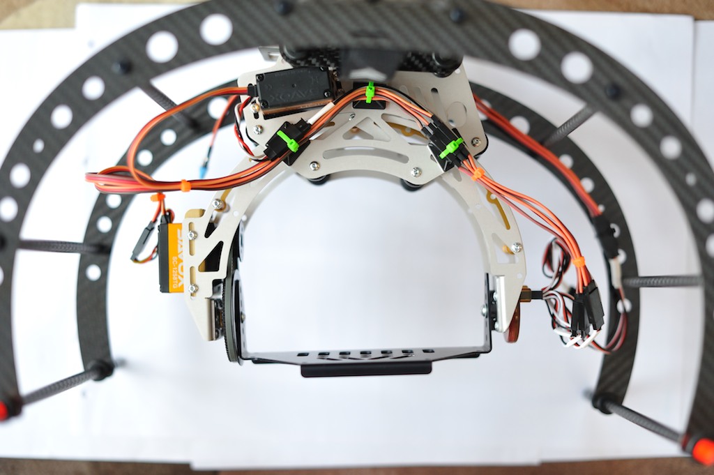

Nice video what camera are you using? As to Skyline loom. I did this, Its now all braided as well.

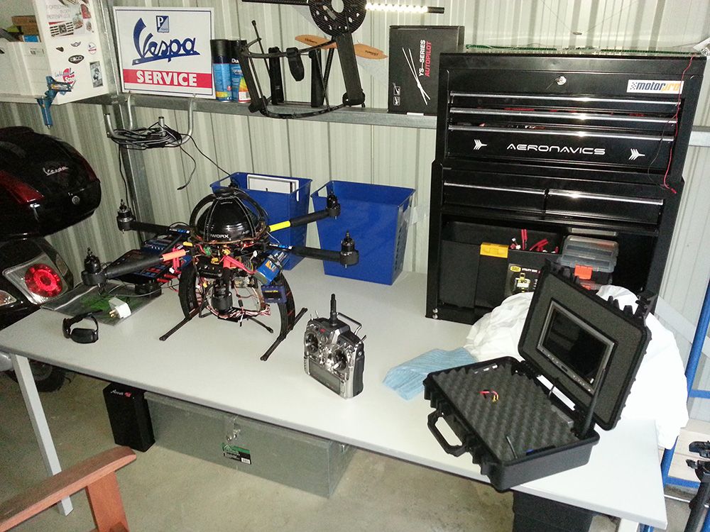

During this built (and tuning) etc, I've been using the dining table in our house, and I think I finally annoyed my wife enough that she and I spend the entire weekend cleaning out the garage of the junk you accumulate with having a child, and from keeping stuff you just dont need or use... So, I've been banished to the garage now, as she's helped me set up my little 'copter table' as she calls it. I guess its OK now since it's not too hot, and I do have permission to bring it inside if I'm working on it in the 45 ̊C summer days we get here sometimes in February....
Preparing another prop test. See the Gemfan on the wall (tip damaged). Thats from my Labrador, not a crash. :livid:

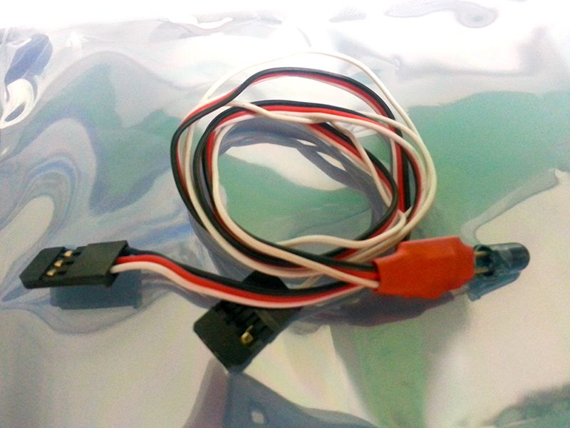

Installed an RCShutter last night. So with my JR9503, I can fly the XM-6 with 4 channels for general controlling, 2 channels for flight mode (manual, manual altitude, GPS - Att, GPS waypoints, GPS RTG) and 1 channel for tilting the AV130, 1 channel for record on/off, and 1 channel for zoom in and out.
That's it, I've maxed out the JR 9 channel radio, but I'm finding it great as the left and right slider can be used to tilt and zoom.
The RCShutter is excellent, plug and play. No setup, just put the shutter release to the channel you need, and then theres the zoom signal only wire to another channel. Cheap as chips from www.rcshutter.com Thanks to Tezcan for the awesome service and speedy help.
