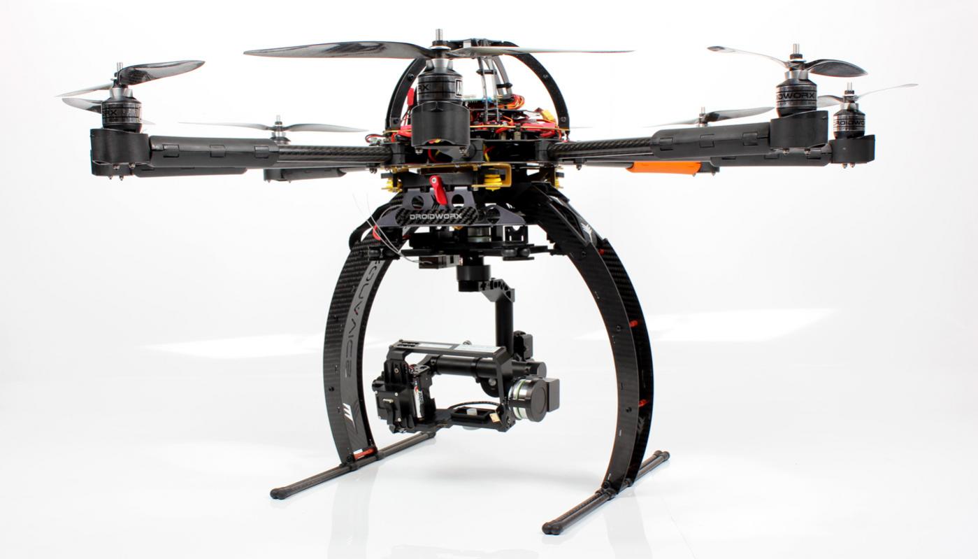

Hello, any word on the promised upgrades or the Zenmuse adapter availability?
Howdy! Promise - working on having it in the shop by the end of the week - attached a pic. Works on SkyJib, XM, VM and AD and will retail @ 75 NZD...

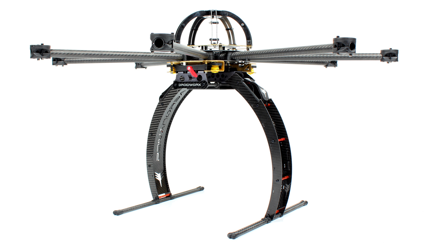

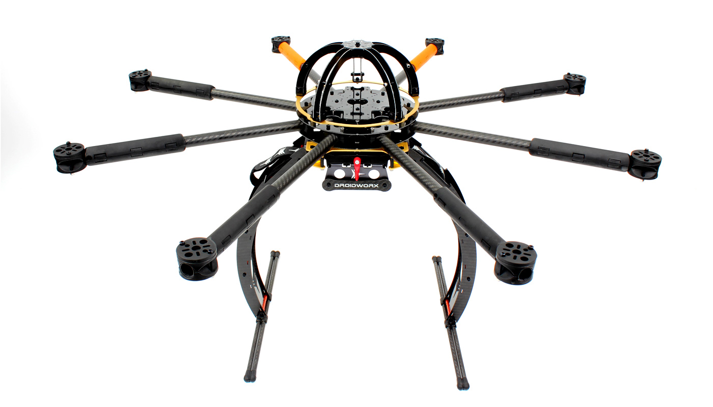

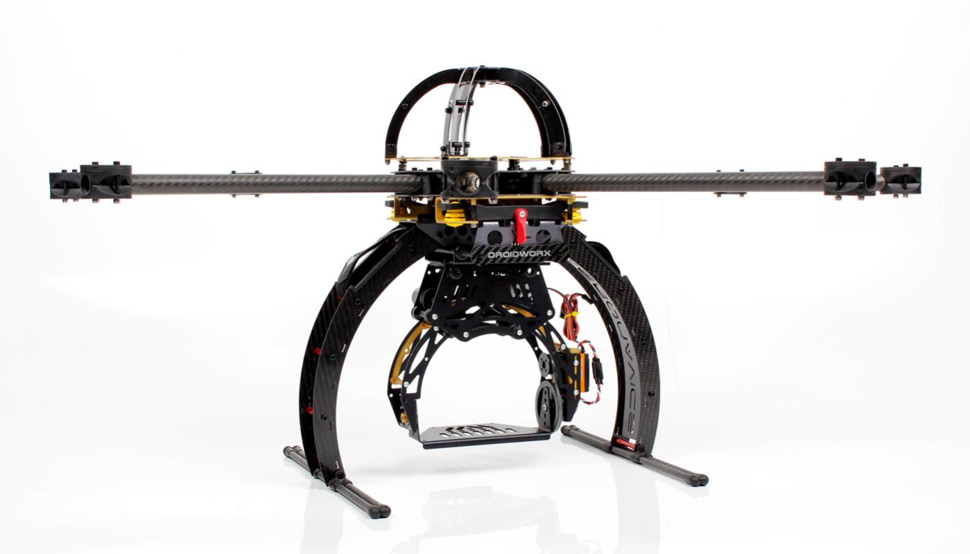

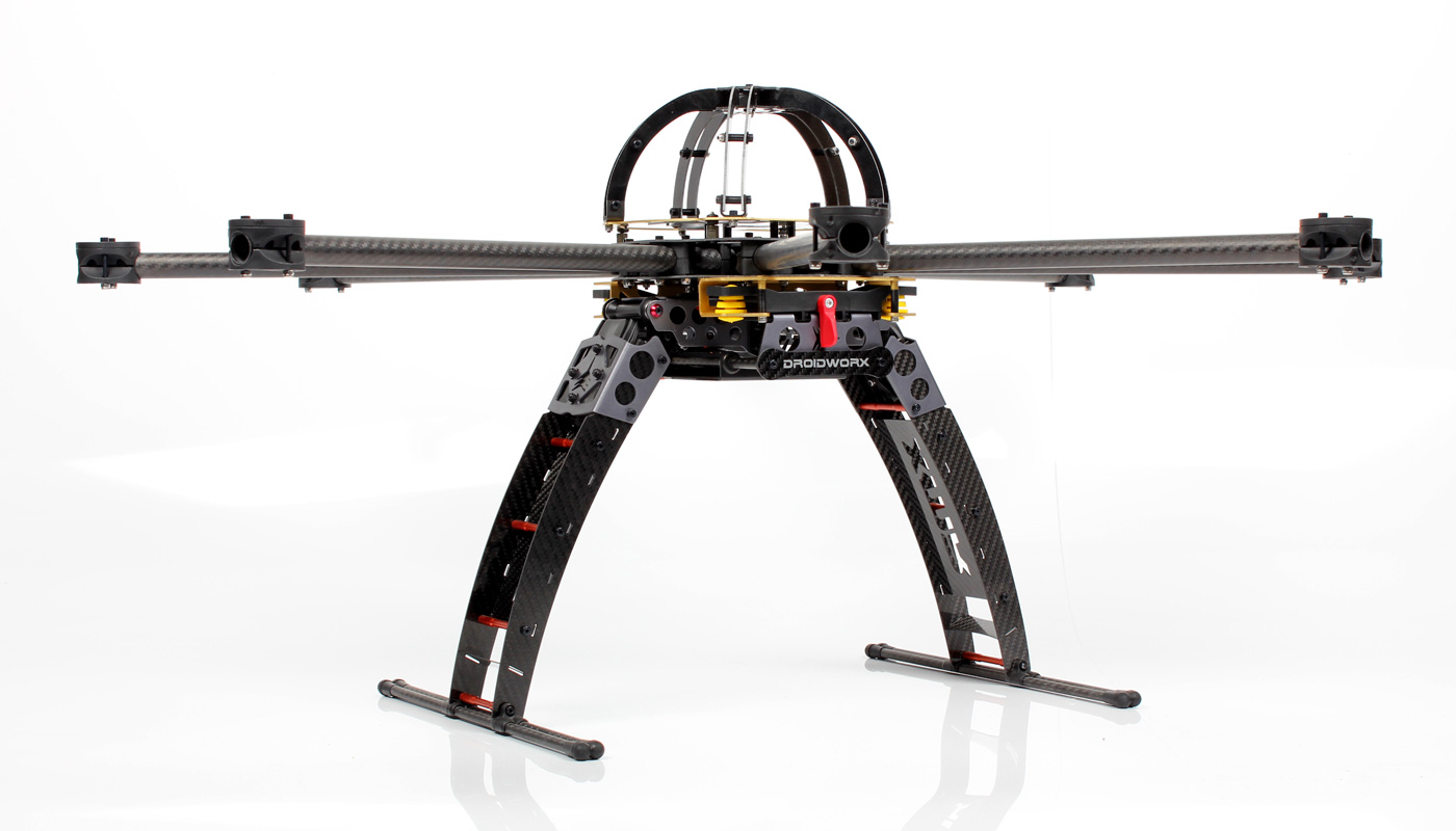

AD can indeed be fully upgraded - from 5-spoke crash cage to composite nacelles, coloured boots and gear rail/landing gear assembly - both fixed as well as retracts (when they are ready), standard or extended clearance. I have attached some pics for sneak preview - this is an AD-8 from some different angles with the upgraded landing gear (standard and extended and the retracts), 5-spoke crash cage and nacelles - boots are not fitted on the pictures. We'll offer the upgrades in modules naturally so you can make it as extensive as you like. Please note though - the gear rail assembly does not fit with the old landing gear - you need the XM landing gear also. The PhotoHigher 360 landing gear (or retracts on the SkiJib) do also not fit - these are mounted onto the old gear rail assembly and since the whole gear rail assembly in the new frames is "floating" it can not have the landing gear attached to it. The 360 head can be fitted of course, just not the legs - for unobstructed view you will need the new retracts. Whilst waiting for the retracts we will make the gear rail only also available - the retracts can then be purchased later when we have received all the parts.
View attachment 7743View attachment 7744View attachment 7745View attachment 7746View attachment 7747View attachment 7748
The upgrades fit very well - we're very happy with the results. The XM booms can also be retrofitted, but if you do this solely to allow the vertical pack down we'll have some tips for you on how to trim your current booms to allow this also.
