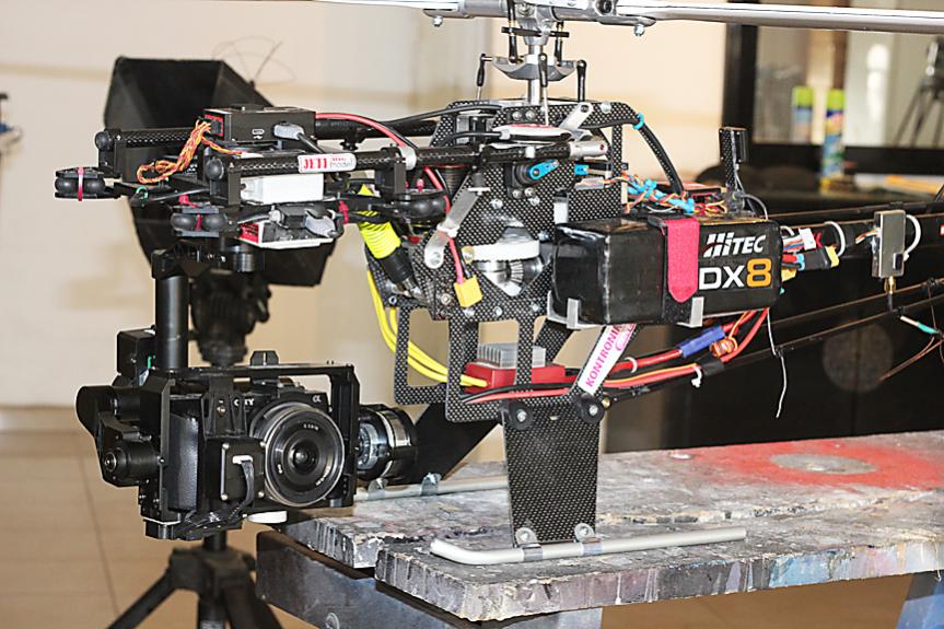

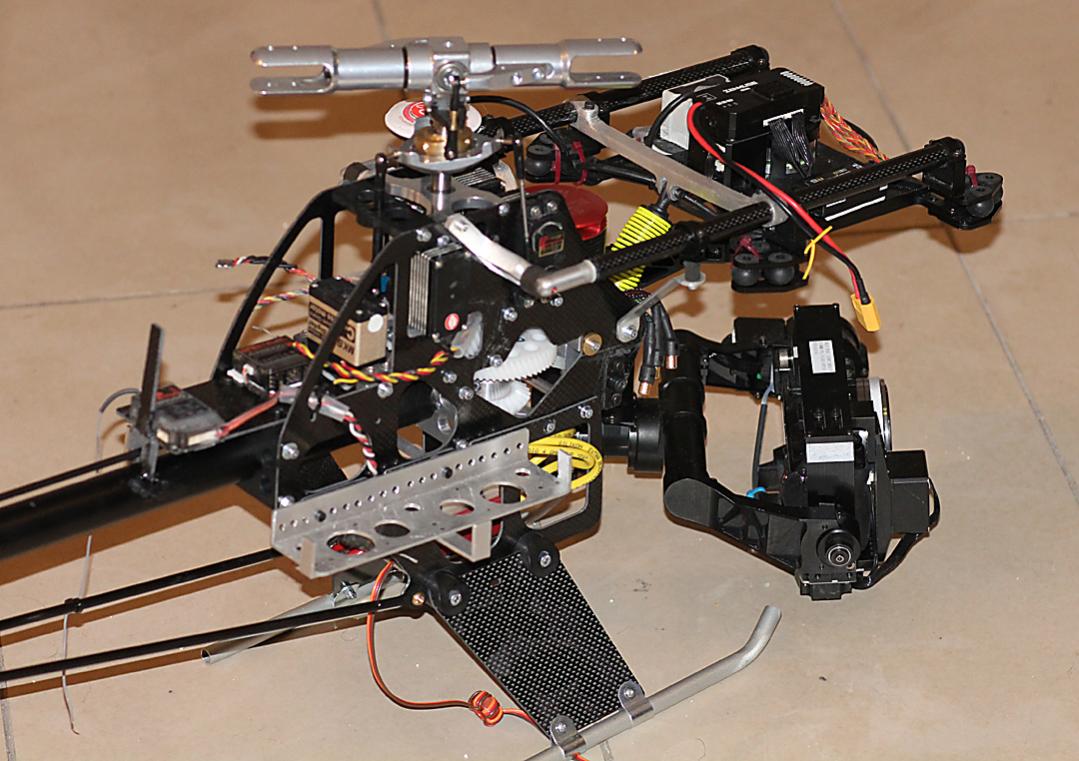

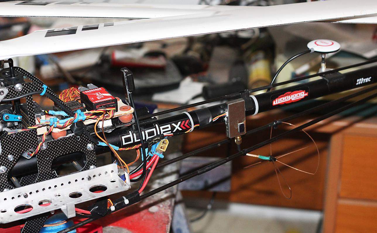

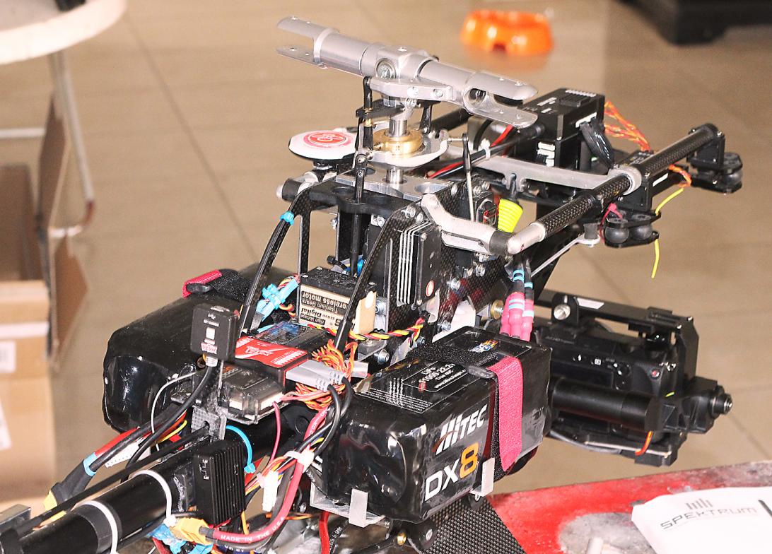

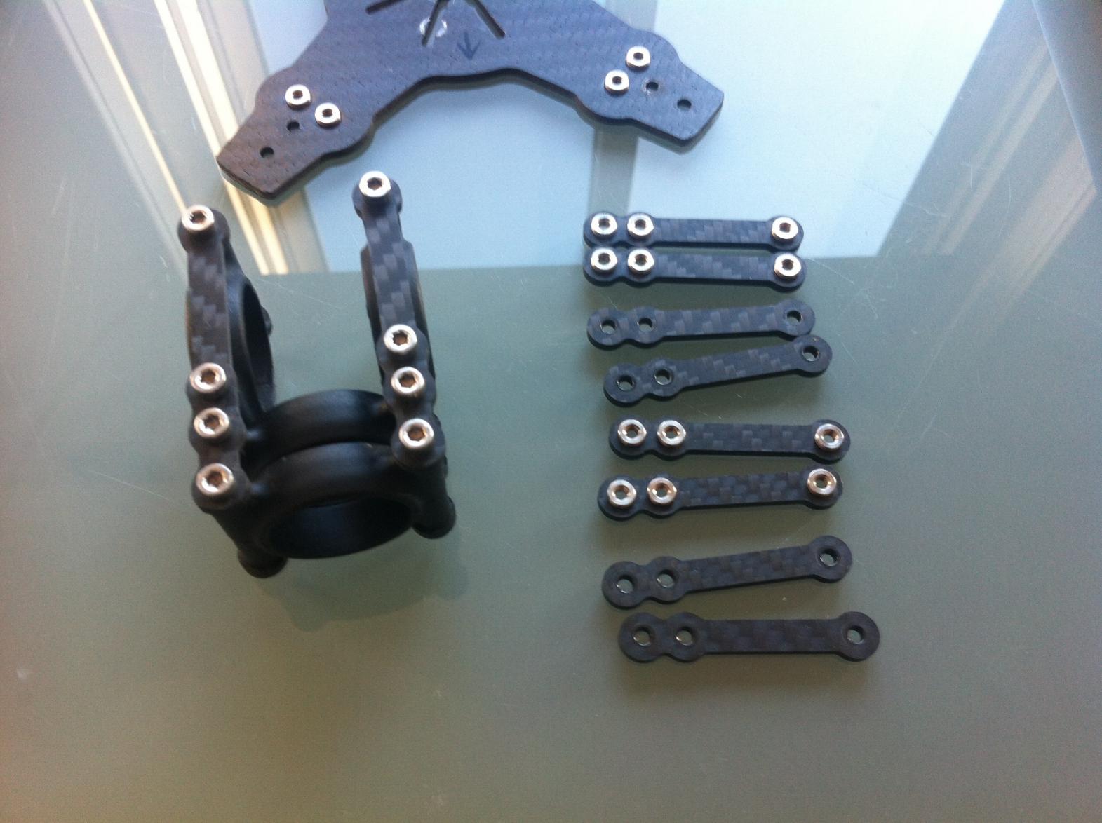

Well my TRD's have just one Buggy unit plus a couple of other rubbers and bump stops that attenuate the sampled vibration from the testing phase. Nothing gets through. The Zen is pretty stable even when it's turned off. The servos that I use on the swash are Magnetic encoder Hitec High Voltage series and the tail rotor has the super fast HKS 878. As I recall the Align servos are made by Savox. Recently I have been testing the Naza-H which is not bad. It could do with a better manual. Such a bespoke machine is very time consuming to build so it would be great if Align come up with a All in One solution that can lift a RED Epic. Much Dev. going on at the moment with blade design. The asymmetric Spin blades are far from perfect for this kind of application. Kloner we have a few T-Rex700 3D machines here at my local club which their owners are pleased with but the two machines that seem to be favorites are the Mikado 500 series and the TDR's if you want to go really fast. The JR stuff is also very good. A few years back we all flew jets but then 3D came along.

As an example of how important camera balance is. When my TDR is sitting on the ground on foam skids, I can shake the rotor head by hand and the whole machine rocks from side to side. But the camera does not move at all even though it is not switched on. One of the key factors in achieving this comes from the position of the main batteries which creates a mass damping at the lower part of the model where the axis of the roll movement is.
