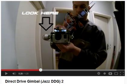

GeorgeM
No.. He's using DC motors that are found in old cassette decks ( most probably )....as I could see from this:
In my project I am using Maxon Coreless DC motors with adequate torque....and the gimbal control is stepless and very locked-on :)
