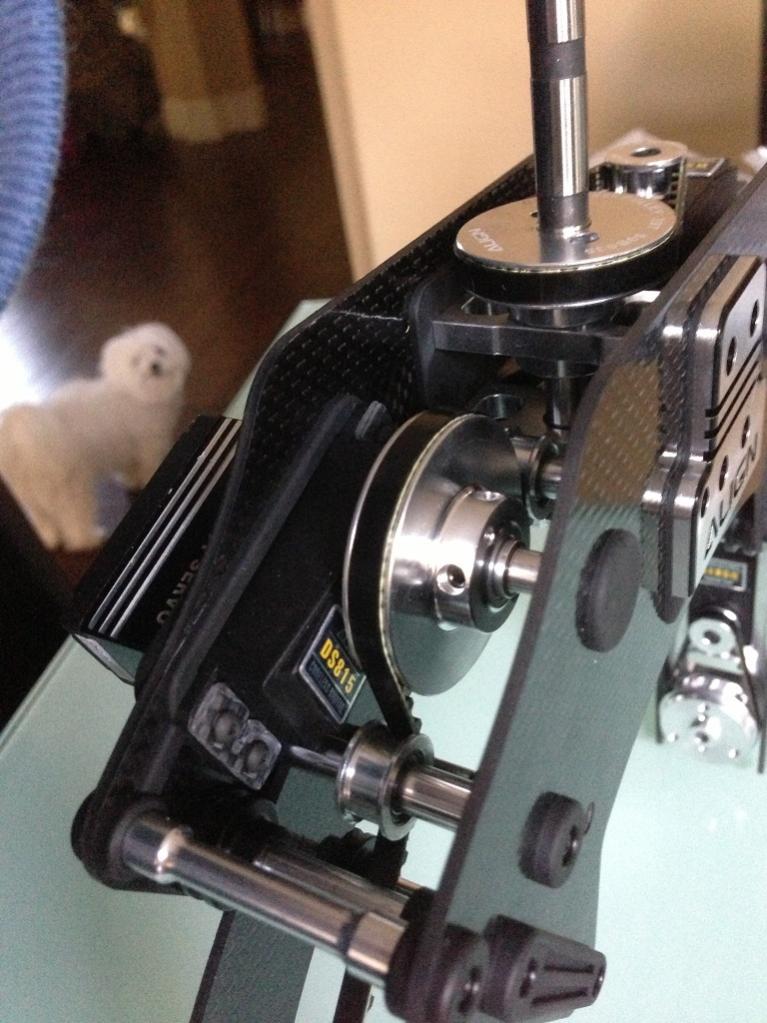

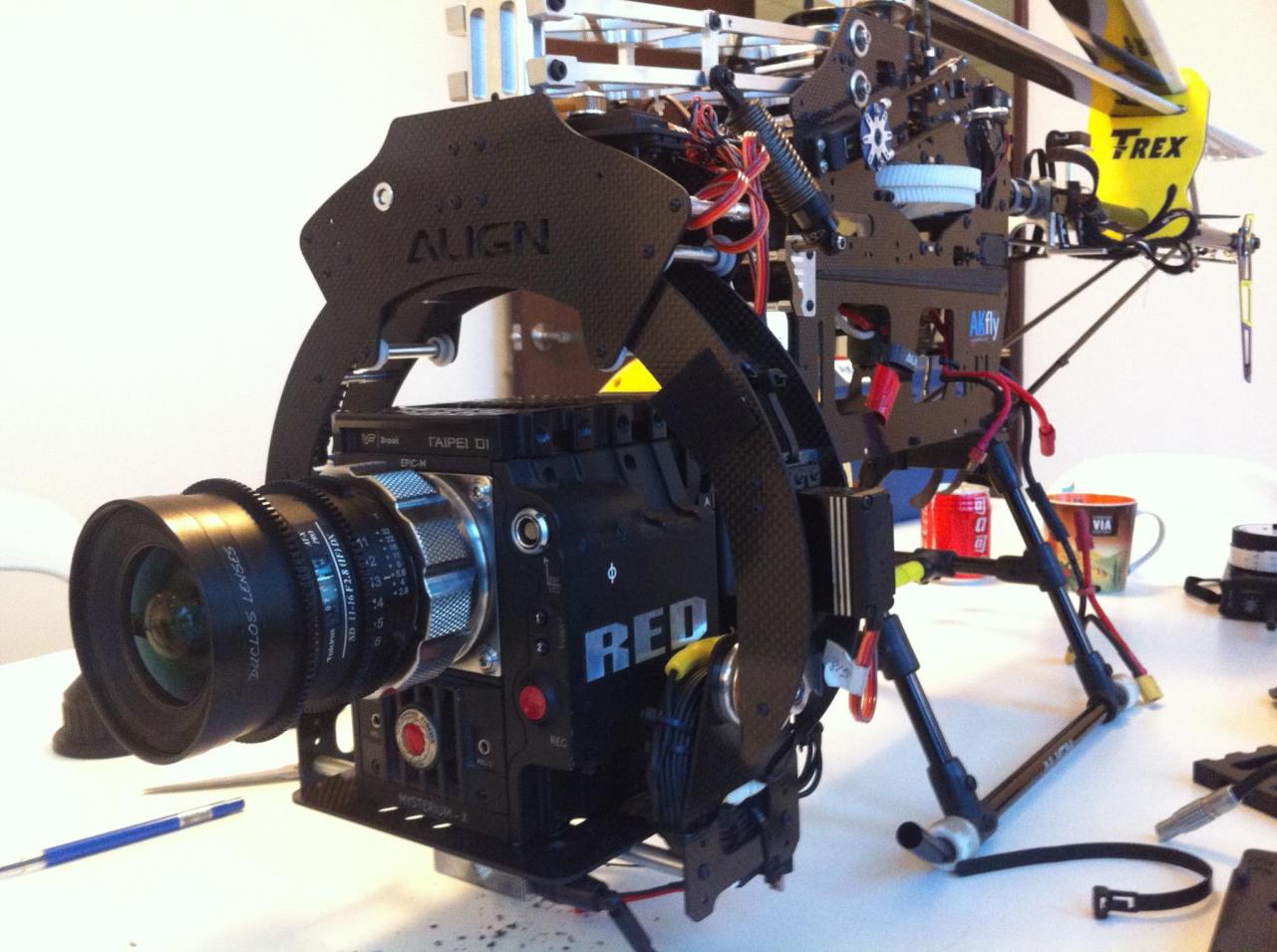

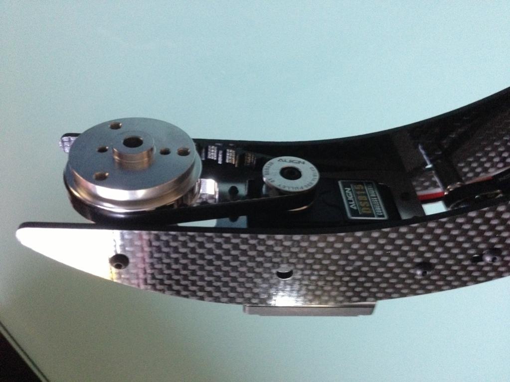

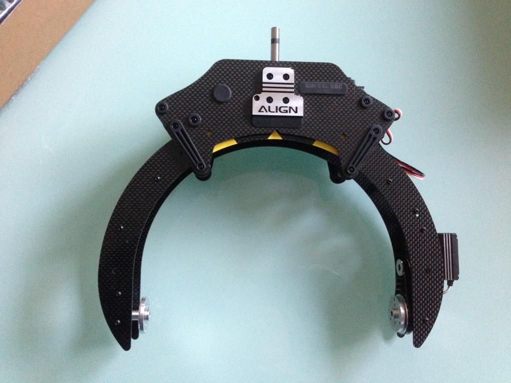

That video was shot a year ago at the Align funfly with a prototype, it even says "test" in the video title, of course it will not be perfect. I was at that funfly and saw this unit up-close, and realized the potential it has. So I ordered the production copy and it just arrived yesterday. The gimbal is of very high quality construction, clean CNC carbon and metal alloy throughout. The servos are 360 degrees and controlled by the included gimbal stabilization system. The system require the use of Align APS auto pilot system, which provides hold/return home/waypoint capabilities. I've been testing the APS system on my 600 heli for a few months now and it has been rock solid. Theoretically you can put the heli into position hold and operate the gimbal, but Align has really designed this to be a two operators setup.
A prominent aerial photo company in Taiwan has been testing the prototype for a while, and used a variety of camera equipment and different shooting environment. I've included some photos from their facebook page.
Now I just need time to put this together. Will provide a thorough review once I have some flights with it.

Hmmm... I'd be interested to see what (might) happen if one tilts the RED down a bit..... Seems awfully out of CG in that tilt tray.
Publicity shot for web cred ??
gm>>
R_Lefebvre
Arducopter Developer
Good eye. Yeah, those shocks don't look like they have much travel left either. I'm trying to see if they've got a chain holding the tail down... :highly_amused:

Have you dealt with single-rotor camera ships before? Sometimes a series of photos is sufficient. There is absolutely nothing revolutionary about this rig. Align is belatedly jumping on the AP wagon with a customarily neatly CNC'd concoction of tired old ideas that will provide endless rubbish to average footage to the hapless that buy it. Mounting a RED camera is presumably supposed to lend it some sort of credibility but it is really just an insult to the RED.
And don't forget, if you really want to look like a professional you must have a sodding great peli case for your downlink monitor.

Being all metal it weighs about 3 kg but it does carry serious cameras without issue - unlike the amusing photos of RED's crammed into flimsy, light weight PS One's and AV200's and impossibly out of of balance.
