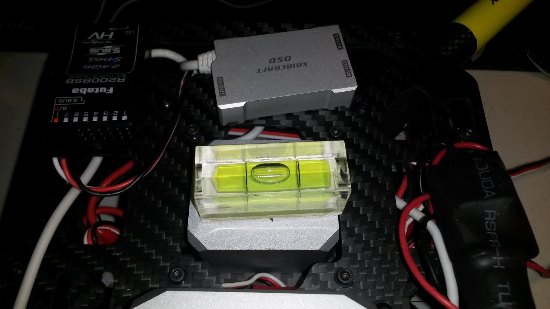

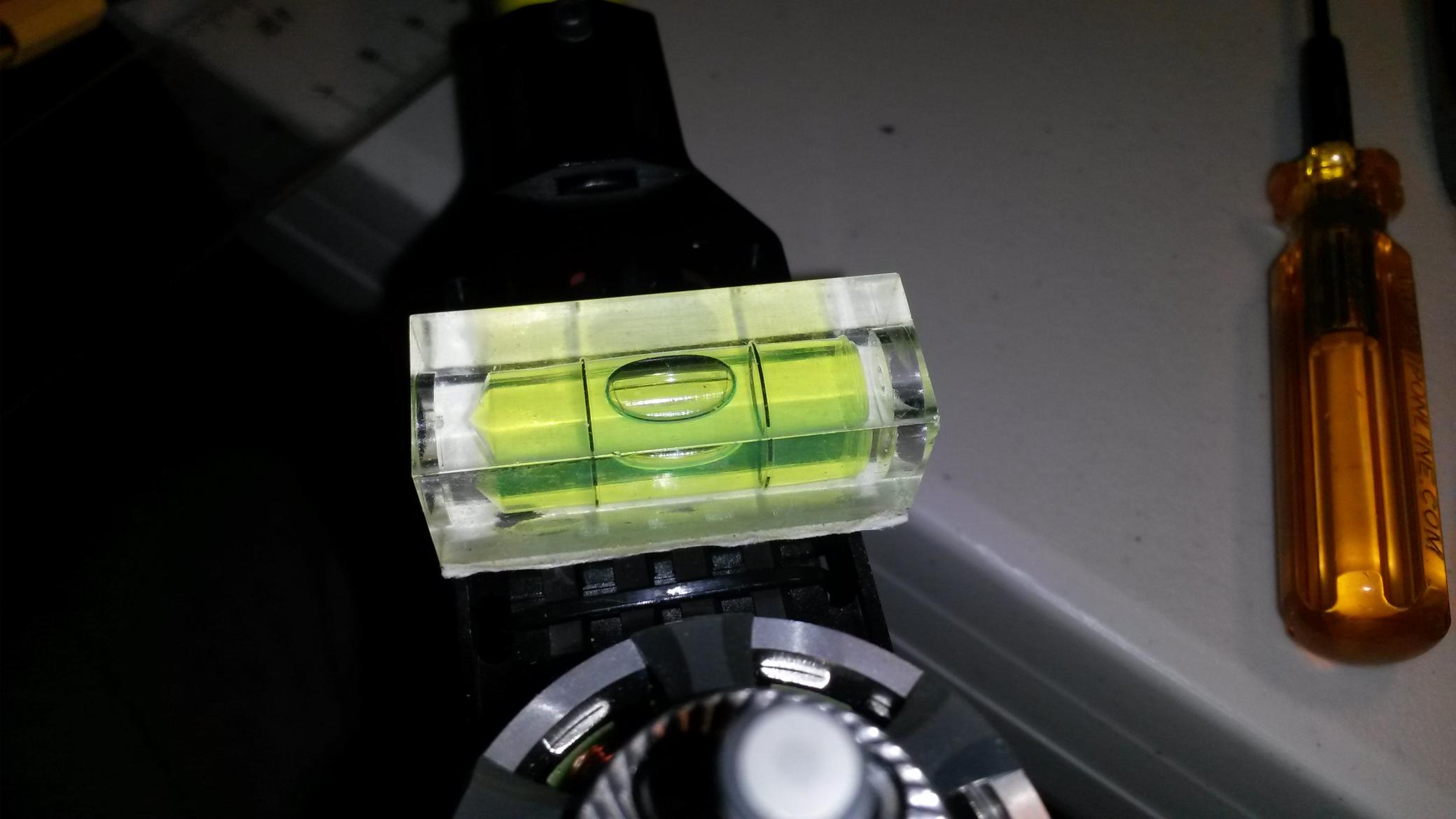

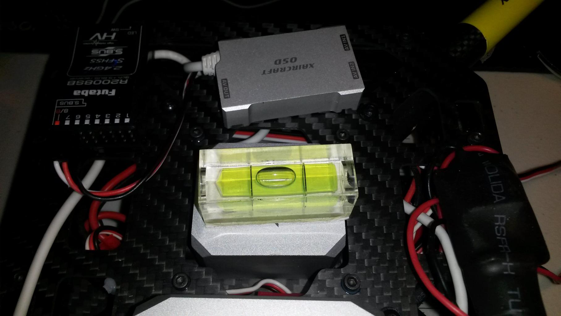

The Super X comes in an Apple-like packaging which was pretty impressive. The casing is aluminum and looks impressive. It's a little on the heavy side but it's nice and compact and the IO module is a nice feature.
The drawback of the casing is there's no way to bolt it down, instead they use double sided tape to secure the FC down. This seems like a bad idea, my initial placement was off a bit so readjusting was difficult. Would be nicer to just have a way to bolt it down in exact position, oh well. They also have you secure the GPS puck with double sided tape to the aluminum pole, again this seems so temporary.
Can't see the point of bolting it down and don't know of many other FC's that don't get stuck down, it provides a small degree on anti vibration which is a good thing.

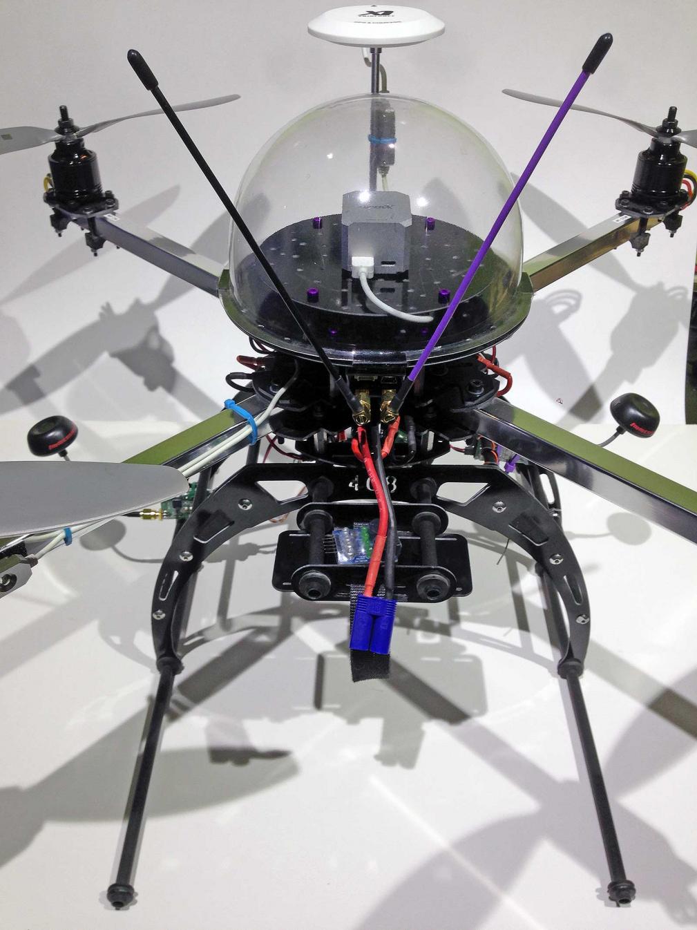

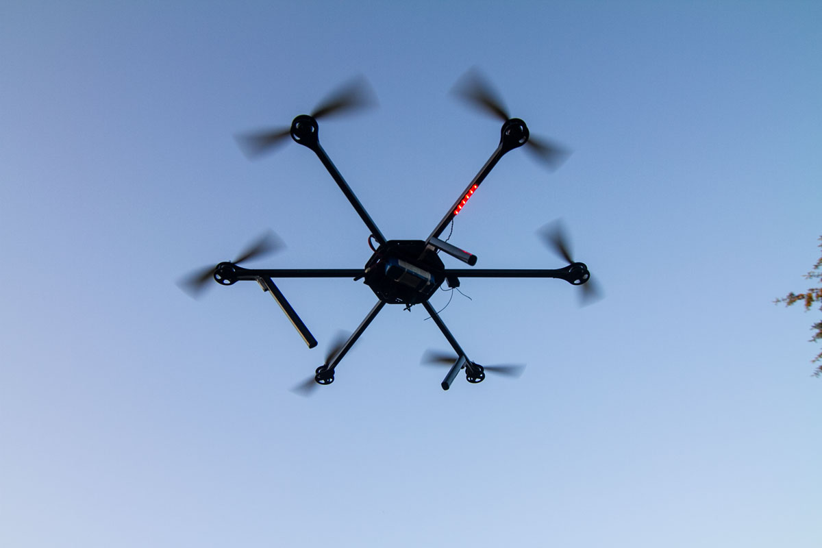

VIQuad
Sweet rig.
Nice videos Paul.
Its fun to hear about others having a great first experience with the SuperX and how surprised they are with it.
I feel like so many people just default to DJI flight controllers when building a rig. Little do they know there is another GREAT flight controller out there that's easy to setup right out of the box, and more importantly doesn't just randomly fly-away out of control with all your expensive gear...ha:highly_amused:

Where did you get the dome and how big is it ?
Oh man I ordered that dome long ago... sorry I can't remember where. It's not very strong, I think it's made out of the same material 2 liter pop containers come in. Very flexible not rigid. Keeps the rain out though.
Sorry, not much help :(

Holy crap that guy is carrying a Sony Nex camera with an x650 quad?
Nice flying indeed. Hopefully I'll get a chance to take mine out tomorrow and give it a go!
