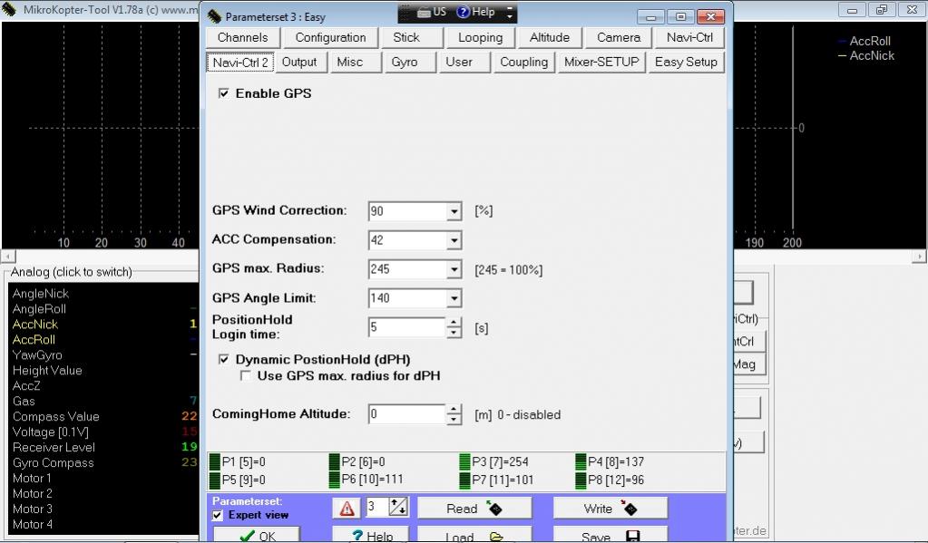

Hi Guys,
The tab I'm referring to is the Navi-Ctrl2 tab. It has a position hold log in time and the check box for dynamic position hold.
Please correct me if I'm wrong, I was thinking that the position hold log in time was the time it had to sit a one place for that position to be logged as the GPS position.
Dynamic position hold I thought allowed you to leave PH on and move to a new spot, hold for 5 sec and then this would become the new GPS position?
This is why I thought that if you move the stick for 1 or 2 sec it should return to the original spot where PH was switched on?

Have you read the wiki? It does explain what you want to know? Just press help in current mk tools settings tab.

To me, it's really not that clear from the Wiki how this all works. I haven't tried it so can't comment on personal experience.
From the wiki:
  • Position Hold Login Time
    • That's the maximum of time in which the MikroKopter logs the new position after the sticks of the Nick/Roll axis are back into a neutral position.
      Yawing is possible without changing the nominal position.
  • Dynamic PositionHold
    • By switching on/off these function you can change the behavior of the Kopter in the function PositionHold.
      Funktion off:
      Is the function PositionHold (PH) switched on the movement of the Kopter will be directly controlled with the Nick- / Roll stick.
      Here the function PH will be switched off if the sticks are moved.
      At the new position and after releasing the sticks the function PositionHold (PH) will be switched on again.
      Funktion on:
Also here you can fly the Kopter through movements with the Nick-/Roll stick to a new position.
The function PH will be not switched on- and off but here the nominal values of the GPS coordinates will be shifted.
Therefore a more accurate positioning is possible during windy conditions. The Kopter flies slower to the positions.
Note: Dynamic PositionHold is switched on by default settings.
My interpretation is that Position Hold Login Time is only used when Dynamic Position Hold is NOT selected and it flies with full stick authority. If Dynamic Position Hold is selected then it immediately locks in on the new location when the sticks are released and it travels with less stick authority.
I probably have it wrong, but maybe not. Anyone else know different?

Thanks for posting that Shawn
I always thought the PH log-in time was the minimun time to log new position - I guess thats why it wasn't working the way I thought it should, at least I know now :)
So basically the copter will not return to the original position if the Nick/Roll stick is moved whether dynamic PH is on or off.
After reading that it looks like the only advantage of Dynamic PH is that its more accurate in windy conditions, is there any other advantage in using Dynamic PH?
