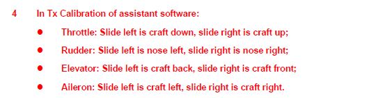

It would be helpful if you could maybe post some photos of your heli and tell us what esc's & motors you have.
One other thing to try, that a few people have got wrong, is to check the direction of your pitch and roll stick in the software assistant. (right stick) Have a look in the user manual on page 7 (I have the old version) but this could be the problem. If this is wrong it won't arm the heli properly.

@ Gunter, yes, left is left and right is right, thanks anyway
