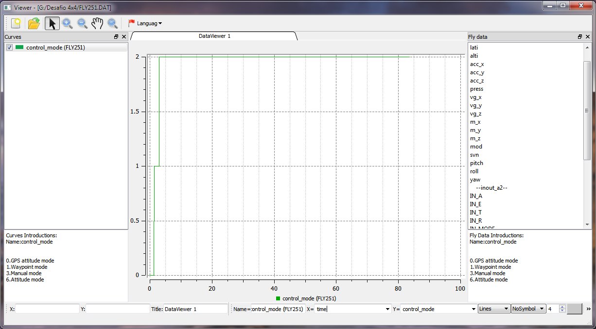

Ok, here's the graph that caught my attention the most from the iOSD. This is the graph of the Flight Mode or control_mode as it's refered to in the viewer. As you can see, at the very beginning, the mode was GPS (0). For some REALLY strange reason, it went to mode 1 (Waypoint mode) for a short period of time. Why would it? I don't even have waypoints or a ground station installed. Anyway, after that, and worst of all, it went to mode 2 for the rest of the flight. If you check the list of modes, there's NO mode 2! What the heck is mode 2? However, it flew normally for some time because the fly away didn't happen until later, after it had supposedly been in mode 2 for a while.
