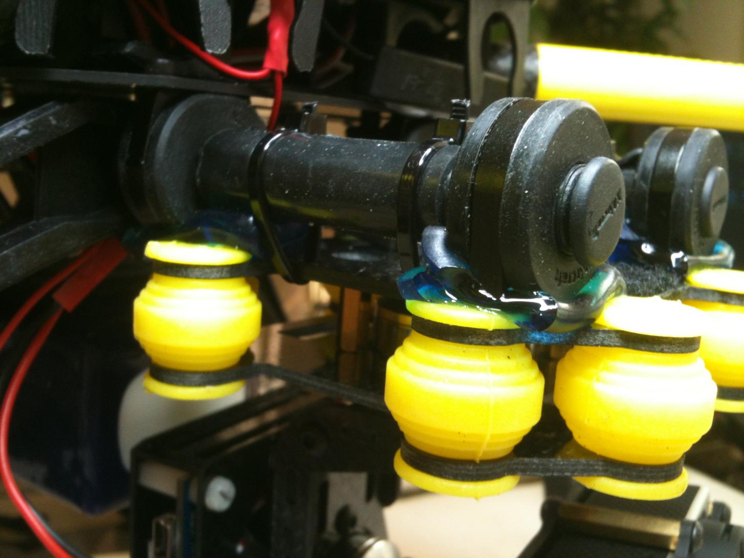

Hi Andy, everything from film, TV, sensory, surveys, R&D..
And just to show I ant being over critical of the A@ I have just grafted one on a test machine so I can film it in action so everyone can see it. Hopefully since the Beat V2 firmware things will have changed but we will see. I only did it because a WKM I am waiting for has not turned up and I was twiggling my thumbs and found a DSM2 satellite. So Just set it all up but the light has beet me so if weather permits I give it a whirl in the morning.
http://www.multirotorforums.com/vbulletin/attachment.php?attachmentid=19231&d=1388332638
