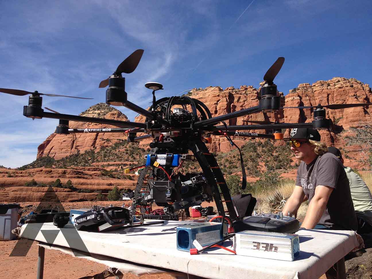

we have put that thing in the most baller positions and it just performs perfect. i do not use gps mode, never turn on manual, never hit return to home, as you can see almost all it's features are disabled and i only use the 8fg and internal rx but yea, money. We went out 1/2 mile+ and she never waivered, couldn't be happier except to have more power.
Great to hear you are having good luck with the internal RX. I got a Futaba Fasst module for one of my custom single stick radios I build as I looked at the Futaba 14 SG and wasn't very impressed with the build quality.
